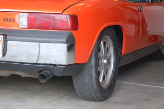

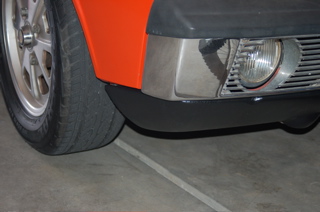

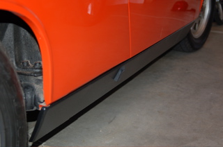

I found these two pics in old threads.....they don't look too bad....I think I'm going to do it. Like you said Kevin, I can always source another set.
Jeffs9146
post Jun 26 2008, 11:05 AM
Ski Bum
Posts: 4,062
Joined: 10-January 03
From: Discovery Bay, Ca
Member No.: 128
I did it on one of my cars and it looked great! Just get the stuff with less lumps!

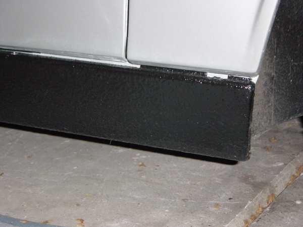

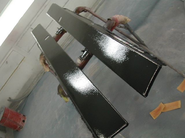

mstein95
post Jul 2 2008, 11:06 PM
Back when grey Levi's were the rage.
Posts: 404
Joined: 1-May 06
From: Eugene, OR
Member No.: 5,959
Well.....I went ahead and had the "bed liner" put on before painting. I think it turned out great. They should be bullet proof going forward except for the occasional meet and greet with sidewalks. (IMG:style_emoticons/default/dry.gif)
PeeGreen 914
post Jul 2 2008, 11:11 PM
Posts: 10,219
Joined: 21-September 06
Member No.: 6,884
WOW. That looks very nice. Really can't tell it is bedlined from the pics.
