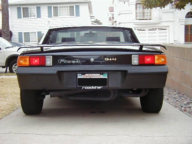

Well.....I went ahead and had the "bed liner" put on before painting. I think it turned out great. They should be bullet proof going forward except for the occasional meet and greet with sidewalks. dry.gif
PeeGreen 914
WOW. That looks very nice. Really can't tell it is bedlined from the pics.
