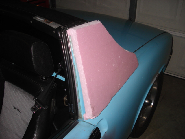

I am creating a mold for an air intake scoop that will mount on the B pilliar.
My intention is to keep things close as possible to the stock look. I also wanted something that I could remove if need be( that's why I decided not to go with fender scoops).
With this preliminary setup( pictured), I am not sure if it will scoop enough air. it stands off about 2" from the pilliar.
The other option is to make the outside somewhat round, similar to the top scoops of a Bugatti.
I'm also open to all other ideas.
Thank's, Keith

r_towle   Try naca ducts in the rear of the rocker panel wit...   Jun 30 2008, 08:22 PM
SirAndy   how are you going to get the air to the engine? :...   Jun 30 2008, 08:23 PM
Rusty   Hi Keith, This idea has been tried before, with s...   Jun 30 2008, 08:26 PM
toon1   Try naca ducts in the rear of the rocker panel wi...   Jun 30 2008, 08:50 PM
Dr. Roger   finally found a pic similar to what we were talkin...   Jul 1 2008, 01:43 AM
tdgray   My .02.... don't do it... looks like :stromber...   Jul 1 2008, 10:35 AM
toon1   My .02.... don't do it... looks like :strombe...   Jul 1 2008, 12:51 PM
URY914   What is the intent here? -To add cooling to the ...   Jul 1 2008, 01:02 PM
toon1   What is the intent here? -To add cooling to the...   Jul 1 2008, 01:11 PM
ericread   I'm not really sure if I like the looks or not...   Jul 1 2008, 01:16 PM
toon1   I'm not really sure if I like the looks or no...   Jul 1 2008, 01:45 PM
ericread   I don't have any cooling related issues. I...   Jul 1 2008, 03:21 PM
Dr. Roger   Another thought. Instead of bring the entire sail...   Jul 1 2008, 03:14 PM
carr914   I always wanted to do this, but never have. T.C. ...   Jul 1 2008, 03:28 PM
tdgray   Looks wise ... hate it. Functionality wise... I d...   Jul 1 2008, 03:44 PM
toon1   Another thought. Instead of bring the entire sai...   Jul 1 2008, 04:41 PM
Dr. Roger   but I've got to admit, with that big vacuum ju...   Jul 1 2008, 04:43 PM
SirAndy   with that big vacuum just behind the cockpit, tha...   Jul 1 2008, 06:13 PM
Zardozz   I've been kicking around an idea like this for...   Jul 1 2008, 05:43 PM
Sleepin   What about a roof scoop ducted through the roof an...   Jul 1 2008, 06:40 PM
toon1   Here's a pic. of what I added to get air into ...   Jul 1 2008, 09:40 PM
