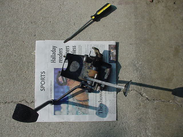

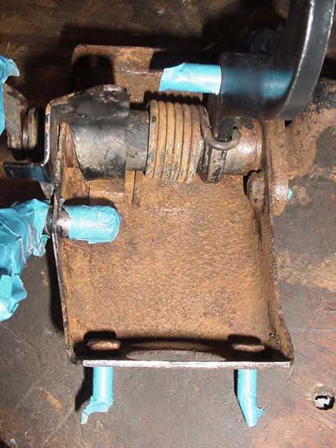

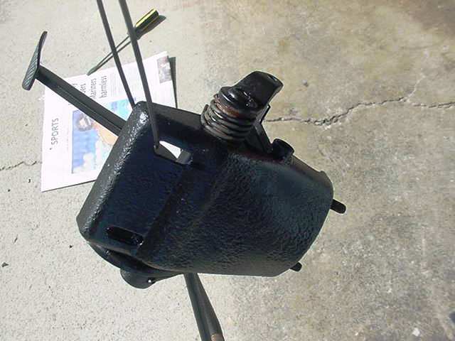

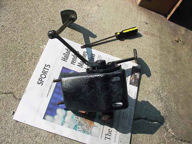

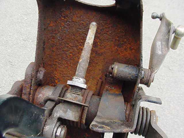

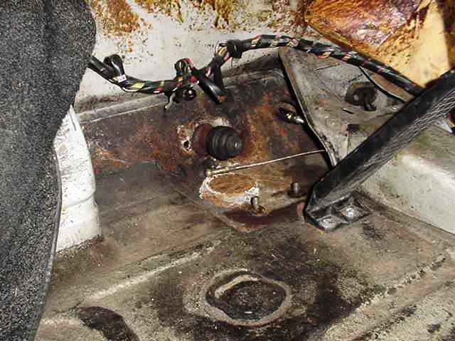

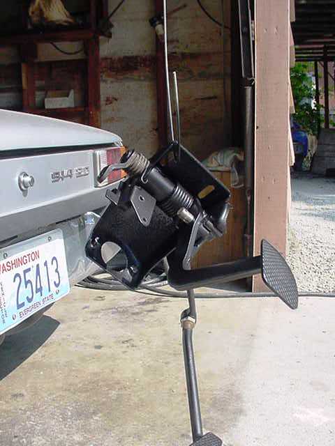

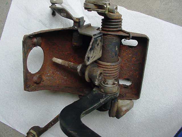

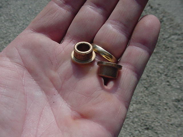

started with the carb linkage and worked my way forward. shot bushings for the cable pivot arm. sloopy and binding. no time to rebush/finish the assem before a week from friday. had a better bushed pedal assem on hand that has sume surface but good shaft bushings with little to none side slop. an oil eater soak, some brake cleaner, and a wire brush. i'll do a quick Mar-hyde treatment for the rust, arrest the small ammount under pedal base and rattle can it with some Zero-rust. i have a rebush kit for the one i took out and will rebuild it at a later date. i have a new cable, might as replace the old one while i'm in this deep. more pictures as i go along.

rhodyguy the Marhyde converts the rust to a sandable, paint... Jul 2 2008, 12:52 PM
