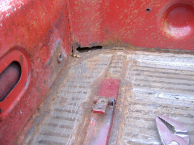

This might help.

Thanks Paul!
Unfortunately, when I pulled up the carpet, I realized that the PO welded in a 1/8" or so plate along the long, COVERING the bolt. ARRGH. I'm not sure why--maybe a stiffen up the chassis? The car is relatively rust free..
Any ideas what I can do? Things just got more difficult and my fiance wants a ride! (IMG:style_emoticons/default/smile.gif)
to cover up the rust ...
