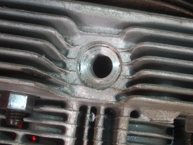

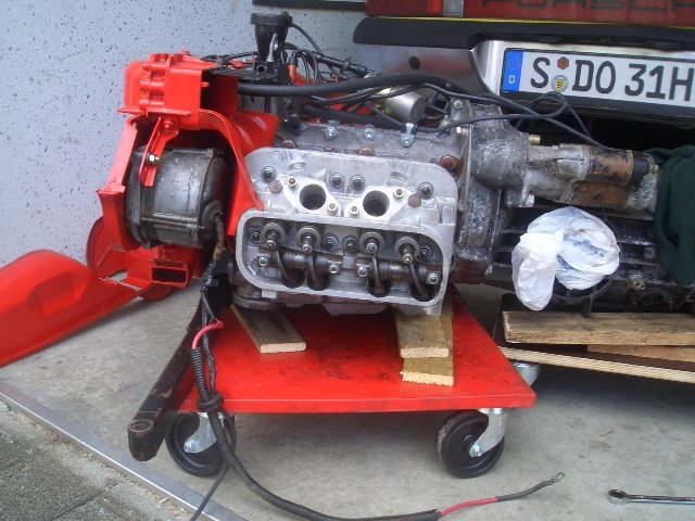

Almost ready; this would be the offending Zylinder Kopf
(IMG:http://www.914world.com/bbs2/uploads_offsite/sphotos.ak.fbcdn.net-7987-1275754157.1.jpg)
The problem hole, the guys did a good job of fixing this.
(IMG:http://www.914world.com/bbs2/uploads_offsite/sphotos.ak.fbcdn.net-7987-1275754158.2.jpg)

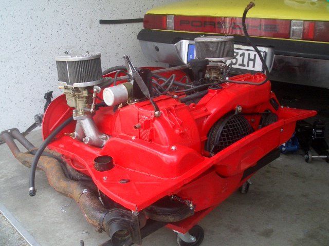

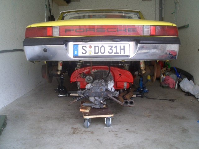

OK, time to put her back in!
(IMG:http://www.914world.com/bbs2/uploads_offsite/sphotos.ak.fbcdn.net-7987-1275754160.3.jpg)
Thar she goes!!
(IMG:http://www.914world.com/bbs2/uploads_offsite/sphotos.ak.fbcdn.net-7987-1275754161.4.jpg)

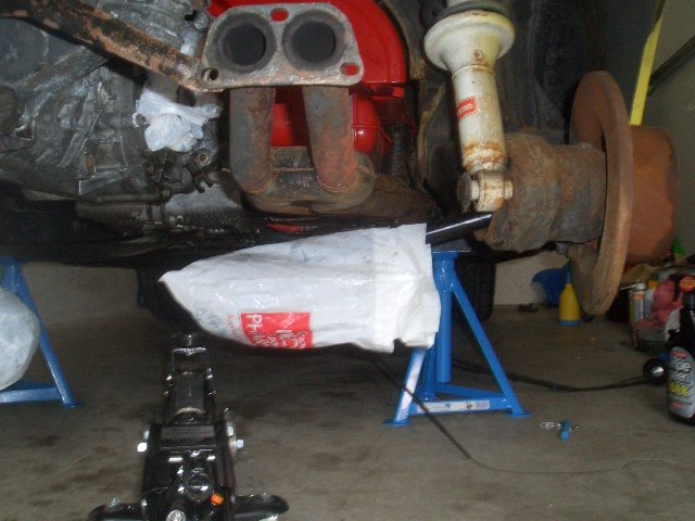

OH! This is why you put the axles on BEFORE you mount the motor!
(IMG:http://www.914world.com/bbs2/uploads_offsite/sphotos.ak.fbcdn.net-7987-1275754162.5.jpg)
Wound up having to pull the exhaust off to get the axle back in. I re-adjusted the throttle cable as I think it was a bit tight and not letting the mechanism fully return. I will check it again tomorrow to make sure she isn't idling too high. Also need to make sure I have the clutch adjusted properly, she seems to be shifting fairly smoothly but I want to make absolutely sure. Hope to get her registered on Monday then I can relax for at least another year. (IMG:style_emoticons/default/lol-2.gif)

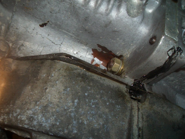

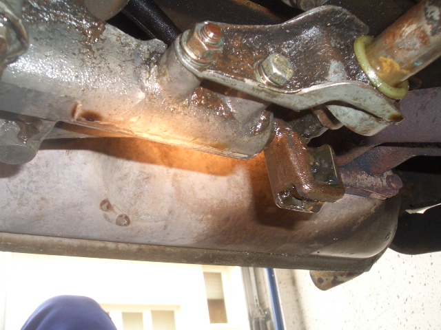

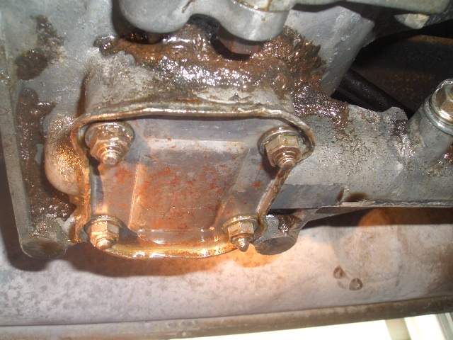

OK, I got out and started the car, of course she never does the leak thing when you just start it. So, I took it out for a 5 minute drive and got her good and warmed up. I am trying to load the vid I took to Youtube but they are not cooperating at the moment. Here are the pictures I took; as soon as I can upload the vid I will. I think I know where one of the leaks is coming from.
stephenaki
post Jun 20 2010, 06:13 AM
Post #140
Can I get this one dad??
Posts: 1,191
Joined: 11-August 07
From: Palmetto, FL
Member No.: 7,987

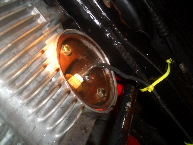

Wouldn't let me upload more than two pictures; here are some more.
