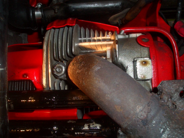

Obviously, or at least in my mind, the oil screen cover area is leaking; easy fix. I think the shift mechanism towards the back may need some re-sealing as well.
The harder nut to crack is where the oil is coming from on the cylinder head. I know it isn't the push tubes, maybe the gasket isn't sealing right and letting some oil through?
I'll let the car cool down and then do some maintenance on what I think are obvious areas of leakage. Hopefully I can load up the video and post the link here soon.

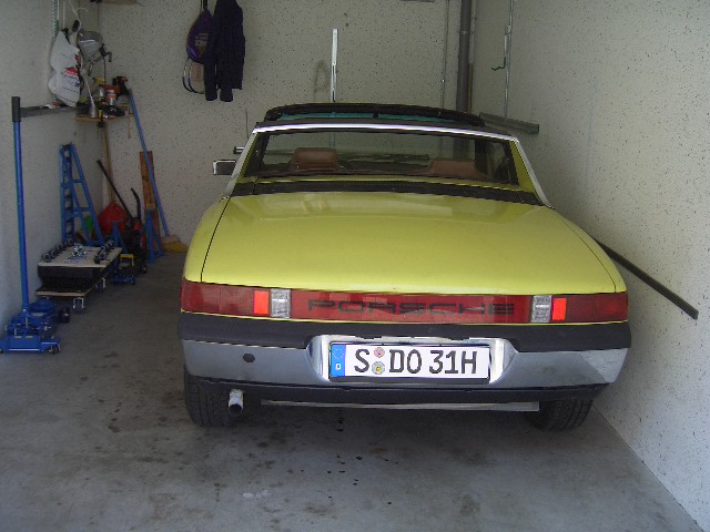

WOOHOO!! Passed inspection this morning! (IMG:style_emoticons/default/piratenanner.gif) (IMG:style_emoticons/default/piratenanner.gif) Of course, it helps that I know the guy fairly well and help him add to his military patch collection (IMG:style_emoticons/default/biggrin.gif)
So, the car is back in the garage, time to drop the motor and tear her back down again. Quick question; I read through Eric's brake rebuild thread and I have rebuilt brakes before however, the parts that I really need are not in the kit.

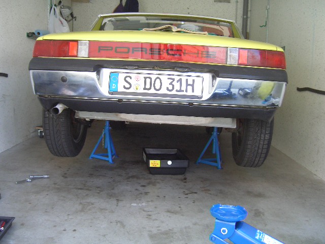

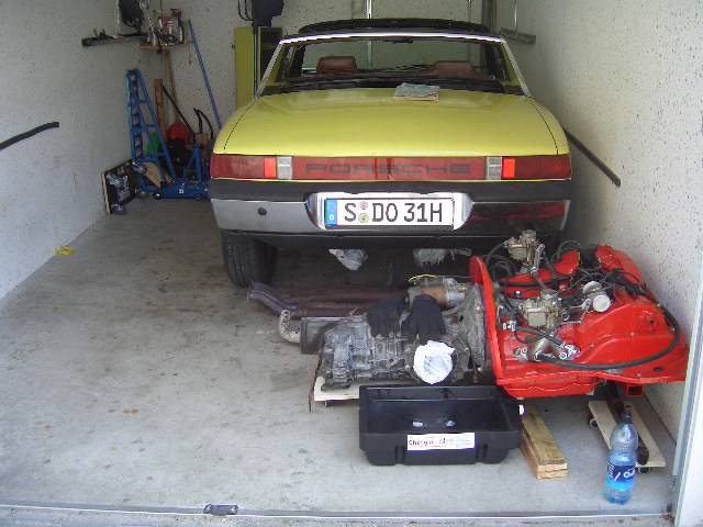

And it begins...again. Phase one of operation, 'find the F@#$%^@ oil leak' has commenced.
Looks purty don't she? Too bad it won't stay that way.
Hey look! I got my ass in the air! WOOHOO!
Phase one done, tear down starts next.
Couple of things that occurred during the drop. 3 exhaust studs came out, not stripped just unscrewed on me and the inside nut that holds the gear shift rod support bracket was stripped. I fiddled with it for an hour before I could get the actual bolt to unscrew out of the transmission. Guess I gotta fix that one.
Other than it being hot as hell here in Germany, we went from cold to damn near a heat wave (IMG:style_emoticons/default/blowtorch.gif) It was fairly uneventful. I am unfortunately getting good at this. (IMG:style_emoticons/default/blink.gif)
I'll start initial tear down tomorrow and start trying to see if I can find out where the oil has been coming from. Unfortunately, I probably wont' start re-assembly until September as it looks like I'll be spending a month in Africa starting the end of July. Oh well, things happen, no sense getting uptight about it. I'm in no rush, want to make sure I find the problem and fix it once and for all. Wish me luck. (IMG:style_emoticons/default/shades.gif)

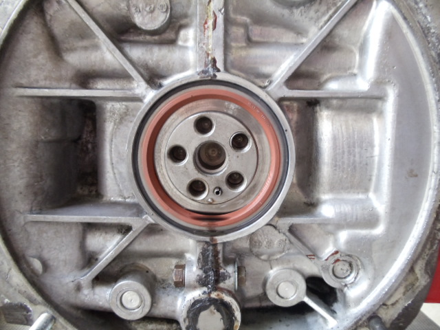

Ok, after spending the morning making a castle out of cardboard and toilet paper roll tubes I finally got around to tearing the motor down. After separating the trans from the motor I pulled the clutch and flywheel and got quite a bit of oil, see picture.
So, is this normal or excessive? I had some oil leakage coming out of the area where the tranny and motor mated so I am of the thought that this is one of the oil leaks.
The oil cooler had not oil residue where the rubber gaskets were mounted so that is not the issue on the front. I will hopefully get around to breaking the motor down the rest of the way tomorrow. Hopefully I will find where the leak is from the front when I do this.
