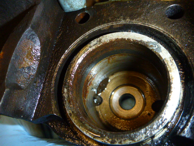

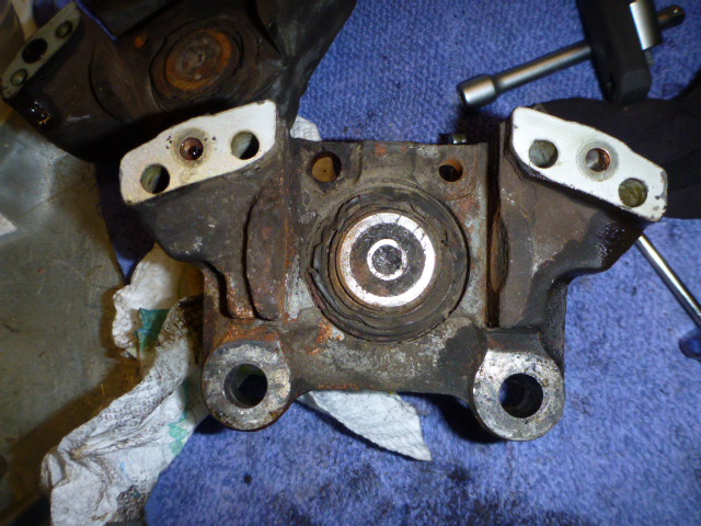

OK, failed inspection...knew it wasn't gonna pass though. (IMG:style_emoticons/default/dry.gif) The primary culprit was the rear right brake with parking brake engaged. She just didn't hold. Of course the reverse lights and high beams didn't come on either. (IMG:style_emoticons/default/blink.gif) Those caught me by surprise. No worries. I tore into the rear right brake and pulled the caliper as I adjusted the cable already and that is not the issue. This is what I found.
Yeah, pretty much toast. After doing the initial disassemble of the caliper I got stuck on how to get the piston out. Do a little search and BAM! THANK YOU ERIC SHEA! (IMG:style_emoticons/default/pray.gif) (IMG:style_emoticons/default/pray.gif) I came across his thread with the video that shows the tear down and reassembly with his kit. Well, Sorry Eric but I don't have time to order your full kit but I truly do appreciate the excellent video you did.
So I tore her down with the exception of the hand brake mechanism and pulling out the adjuster from the piston. You can see the 'gunk' at the bottom of both caliper bodies after the pistons are out.
Of course Eric makes it look easy, kinda like Mike makes it look easy in his gearbox rebuild. Got a good size gash up my left pointer finger from a slipped dental pick! (IMG:style_emoticons/default/sad.gif)
So, I just have to finish cleaning everything up and then check to see if the local Porsche dealer can get me the basic rebuild kit. Since ATE is a German company I think this should be fairly easy... (IMG:style_emoticons/default/lol-2.gif) Nothing in this friggin country is easy. (IMG:style_emoticons/default/rolleyes.gif)

The dealer may not be able to get you a rebuild kit. The ones that are available over here are from some other car that has the right sized bits and pieces for the 914 rear caliper, and I don't know what car that is. It also doesn't have all of the parts for a complete rebuild (I think it's the E-brake mechanism bits that are lacking). Those have been reproduced or sourced alternately from someone else.
So you may be waiting for the kit from Eric anyway.

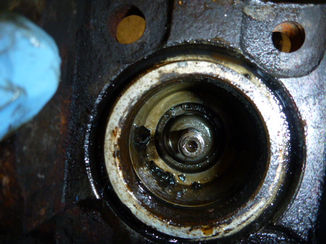

Dangit! (IMG:style_emoticons/default/headbang.gif) I had gotten everything put together for the caliper and was trying to get the spring for the e-brake in when I noticed that the piston was no longer pushing forward when the lever was actuated. It was working before I put on the retaining ring what the hell!
OK, back out the plug, stick a 4mm allen head in there, turn...nothing. I recall Eric, in his video, mentioning that sometimes they get stuck so when you pull in the piston, back it out a bit. I did that, then adjusted it to get the retaining clip on...looks like I didn't back it out again. So now what? Eric stated that when this happens you need to use a high speed air wrench to get it out. I pulled the retaining ring and dust cover off of it and can shoot over to the auto hobby shop tomorrow but, just want to make sure what it is I need to do.

NEVERMIND! I get frustrated so post; then, after I post, I think of an idea, try it and, it usually works. (IMG:style_emoticons/default/dry.gif)
Dowsed it with penetrating oil, let it soak for a bit, turn her over and whack the backside with a hammer a couple of times to loosen it up. Put the adjusting gear in and turn...wella!
Pulled the piston all the way out and cleaned everything up again. Will re-assemble tomorrow and make sure I don't make the same mistake. If I had any sense, I would have sold this car a year after I got it! Well, no one said I had much sense. Besides, I do like a challenge (IMG:style_emoticons/default/blink.gif)
