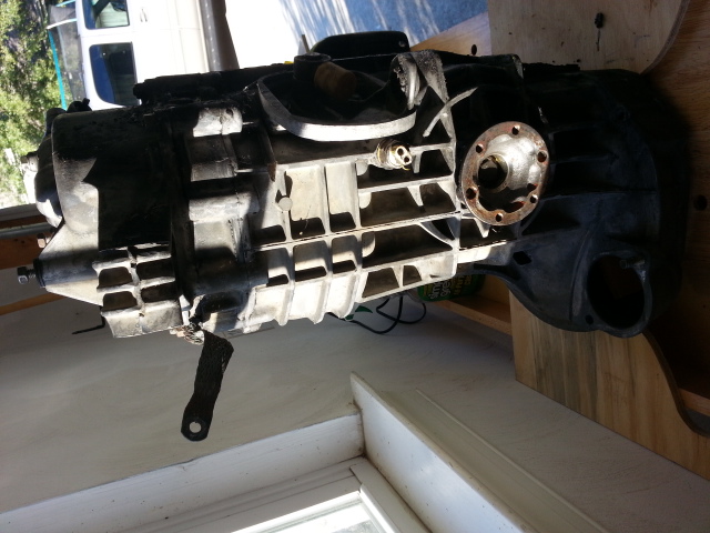

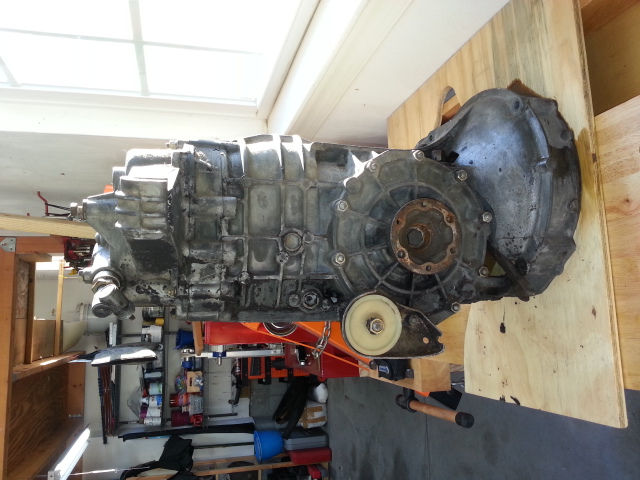

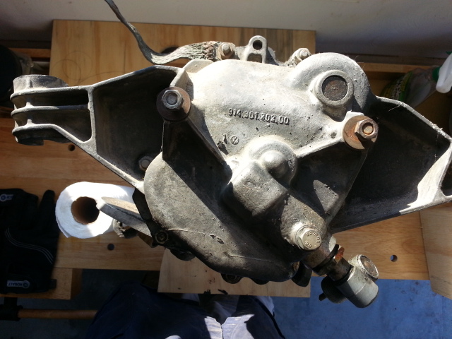

Picked up the transmission from my brother in law, looks to be in good condition from the outside. I'll start tearing it down this week to see what the inside looks like. It was a good weekend, I also got my first deer after 8 years of not getting to hunt. (IMG:style_emoticons/default/piratenanner.gif) Dressed out at about 100 lbs.
Looking forward to playing with her stack.... (IMG:style_emoticons/default/biggrin.gif)
Now, where did I put Dr. Evil's DVD.... (IMG:style_emoticons/default/idea.gif)
