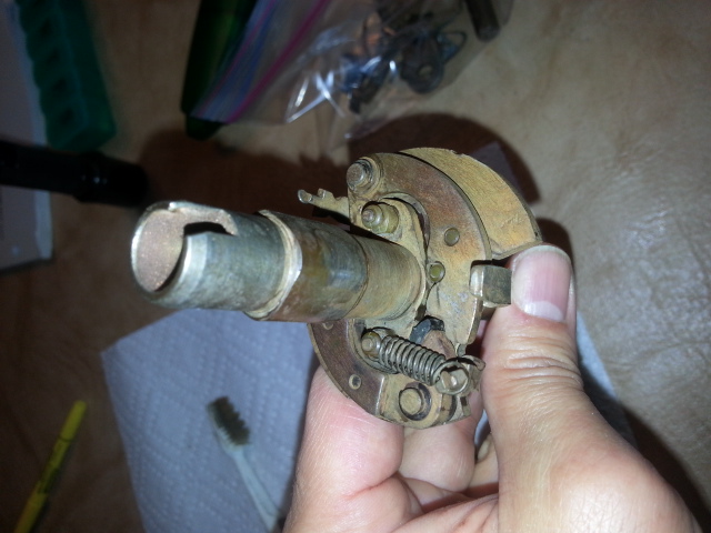

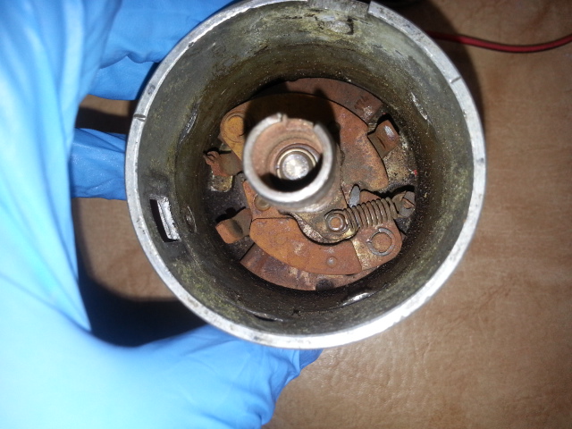

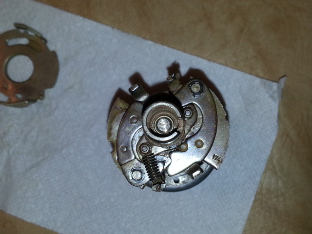

Doesn't look ANYTHING like mine! I have a 009 version. This aside, I can use that link with some other things I found to re-assemble the dizzy.
I tore it down today and, after removing the contact plate and pulling the shaft and advance mechanism, found this...
See anything missing? Maybe another spring on the other part of the advance weights???? Sooooo, isn't there supposed to be two springs?? I'll wait for someone who re-builds these things to chime in. (IMG:style_emoticons/default/popcorn[1].gif)

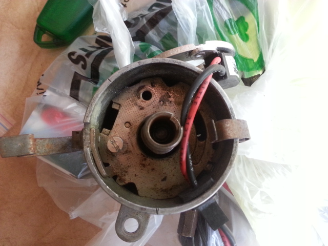

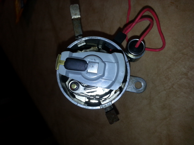

Well, my wife gave me whatever she had so I feel like hell. So what do I do? Take drugs and work on the teener of course! (IMG:style_emoticons/default/biggrin.gif) Probably not one of my better ideas as I lost the dang distributor drive spring in the motor while I was lining up the gear. (IMG:style_emoticons/default/headbang.gif) Sometimes you're the hammer and sometimes, you're the nail. I get to be the nail today. (IMG:style_emoticons/default/smash.gif)
Needless to say, I'm gonna have to now drop the motor to see if I can find the dang spring unless someone has any better ideas. I guess I could drain the oil and pull the pan and see if it made it's way all the way through. Anyone got any suggestions?
On the flipside, I did finish the distributor re-furbishment. She looks a lot better than when I started.
BEFORE:
Attached ImageAttached Image
AFTER

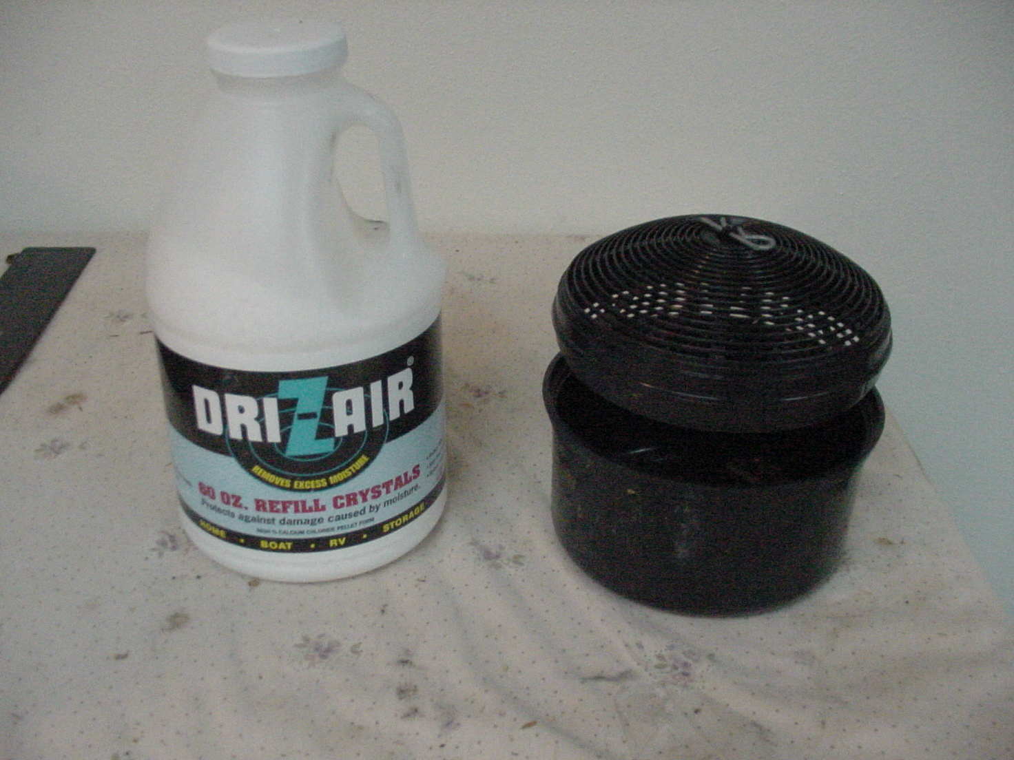

for storing outdoors, go to the auto parts store and buy a DRI-Z-AIR and place the whole thing in a bucket on the floor of the car. check and pour off the water every 1 or 2 weeks. basically moisture absorbing crystals in their own little catch basin device. use the bucket as you'll likely forget to empty the basin and enough water will collect and over fill. as stated in the instructions the 'water' will be "corrosive" so the bucket is pretty important.
hmm, I'll have to see where I can find this stuff, wonder how well it would work in my gun safe... (IMG:style_emoticons/default/idea.gif)

actually, i found the ones i have at my local hardware store when they were on sale. over time the crystals dissolve and you have to add new. i have one of the units in my truck that's stored under a tarp.

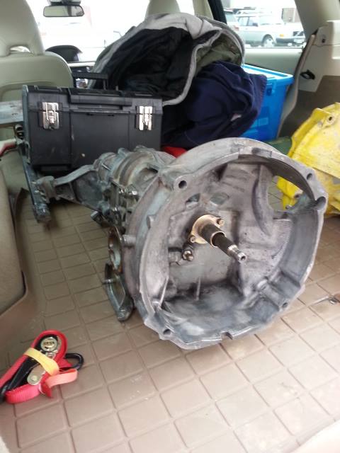

I finally got around to dropping the motor and tranny. I wanted to build a lift adapter but just ran out of time so I improvised and used my motorcycle lift on one end and my jack on the other to achieve the same thing without having to 'walk' the car up on the left and right. It worked.
As one can see the tranny is pretty tore up, I think they left the car on the top of the ship when they shipped it from Germany. Case in point, all 6 *&^%^$##%^& bolts snapped off when I went to remove the muffler!!! (IMG:style_emoticons/default/headbang.gif) They were rusted solid! If I can't extract them then I guess I'll be getting a new muffler.
I drained the oil and, after I help my buddy with his transmission tomorrow, we have to replace the 2 and 4 band on his Chevy tranny, I'll start to tear into the motor. I figure She needs to be cleaned up so I'll just tear it all the way down and rebuild her...again. Besides, I'll need to do quite a bit of work on the body to get it ready for the conversion to a side shifter. Might as well start now. Maybe I'll eventually take it up to Scotty B's to have him shoot it. We'll see.

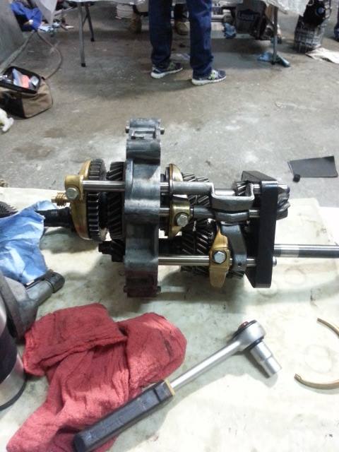

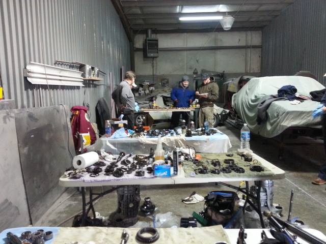

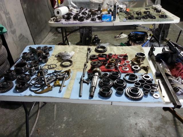

Well, after a full weekend at Dr. Evil's transmission clinic, the side shift gearbox is ready to go. I kept the bell housing portion of the donor trans and will be cutting that off and setting it up to be a future mounting bracket for the engine stand and engine test stand.
Donor innards on the left
Dr. Evil mentoring his hapless victims
She is ready to go back in
WOOHOO! It is back together
Still need to finish tearing down the motor to fish out the dizzy spring and, as luck would have it, I may be getting lucky with a 2.0 core set of heads from Mike (Mblizzard) who I met at the clinic. Hopefully they are workable so I can do a complete transfer to a 2.0 motor. Speaking of conversions...the current set up has Delorto IDF 40 single barrel carbs, would it be better for power and a smoother running motor to transfer to Webers? Thoughts on this? (IMG:style_emoticons/default/popcorn[1].gif)
