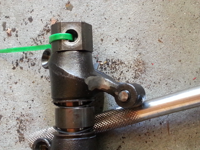

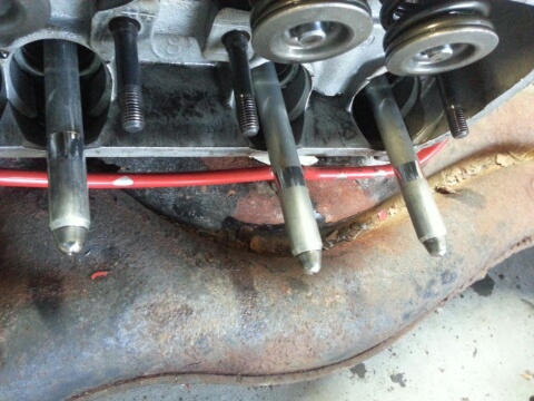

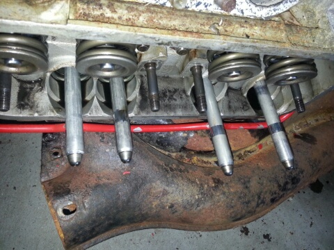

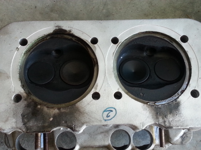

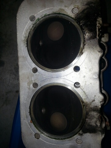

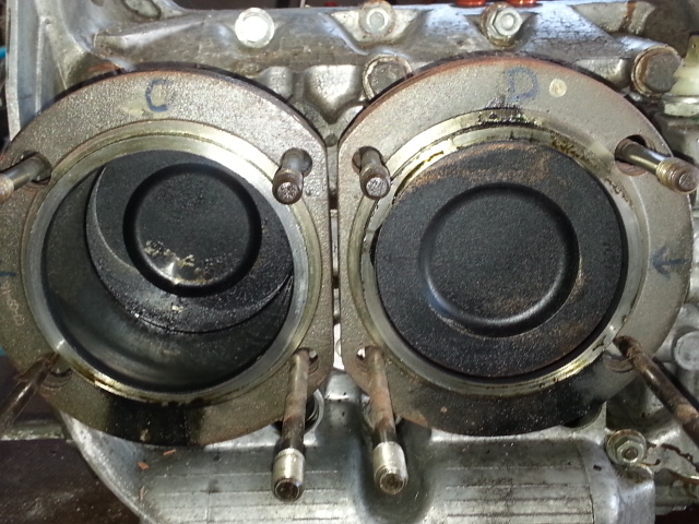

Had some time today to tear down the driver's side bank. Initial look is not good. So, what would cause the 'shiny' sections of the pushrods? Rod tube retainer? If so, what is the fix or is this even an issue? Looks to me like it might eventually wear through the rod tubes?
Also looks like the cylinder head did not seal properly based on black spray pattern on the cylinder head.
Piston tops are pretty black as well.
I guess I'll just clean it all up again. (IMG:style_emoticons/default/rolleyes.gif) Luckily I have a lead on a set of 2.0 heads from MBlizzard so I may be converting to those. I'll take my time and make sure I get things right this time as I obviously didn't on the last rebuild. (IMG:style_emoticons/default/unsure.gif)

Shiny spots are normal. it's from the retainer rubbing the rods. Make certain they re all straighrt. Easiest way is by rolling them over a true surface. If you need the heads machined call me. the Machinist across the lot used to own an import repair shop and knows these things inside and out

The shiny spots are not normal. They're from not getting the retaining wire for the tubes seated on the shoulders of the tubes. If the lower part of the bent wire sticks down into the tube, the pushrod wears on it and you get that shiny area.
The fix is to pull the wire back outward. Pull far enough and the bent corners will "click" into place against the shoulder of the pushrod.
--DD
hmm, OK, I'll make the adjustment when I get to that point and post a pic to make sure I have it in the right location.

OK, after my TIG welding class (IMG:style_emoticons/default/welder.gif) (I love this class!) and completing the 'Honey Do' list I got to continue the tear down. Seems as if the passenger side cylinder bank and heads also didn't seal. I used the gasket for both sides, don't think I'll do that with the 2.0 heads.
Also noticed that the underside of the rocker arms looked like they were worn away by rubbing on the valve spring assembly? Didn't see any wear on the valve spring assembly though so it may have already be there. It was just the ones to the #4 cylinder.

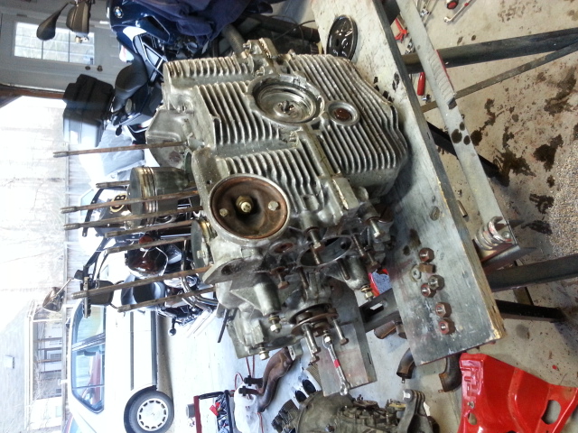

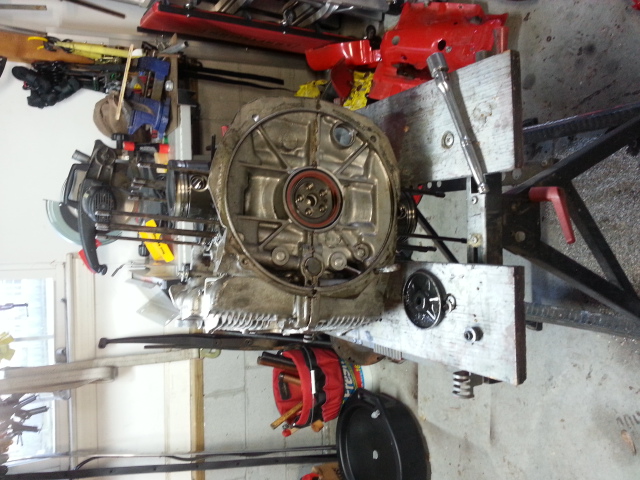

Got all the bolts off and have her up on the bench, I will separate the halves tomorrow and find the errand dizzy spring then start cleaning things up.
Nice thing about these motors is I have no problem manhandling them up onto the bench, sure as hell couldn't do that with my cast iron MG motor or the big ole V8 in the Merc! (IMG:style_emoticons/default/blink.gif)
At least I am not in a rush like I was in Germany, I'll take my time and make sure it is together right, hopefully Mike doesn't find any issues with the 2.0 heads he's selling me.

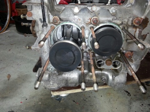

Hey Stephen. I was checking out your pistons. I am not 100%, but those look like they are from a bus? They seem pretty deeply dished.
I'm not totally sure if they are bus or Porsche 2.0s. I read where both were dished but the bus pistons had a deeper dish than 2.0 Porsche heads. At this point it doesn't really matter. I just need to get everything cleaned up, machined where needed and put back together. I'll run the carbs while I work on getting the components for the Megasquirt conversion and do the mods to pop in the new side shift transmission.
