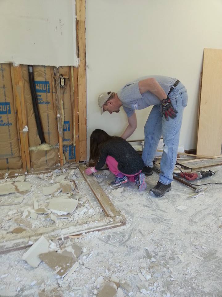

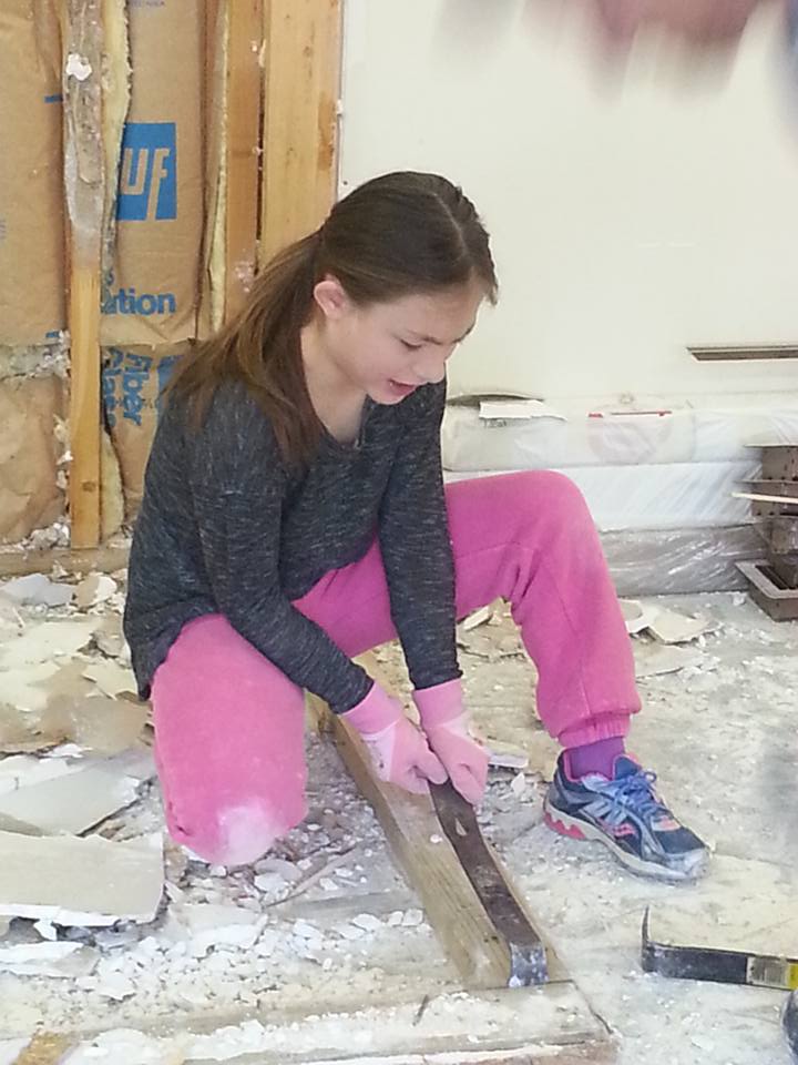

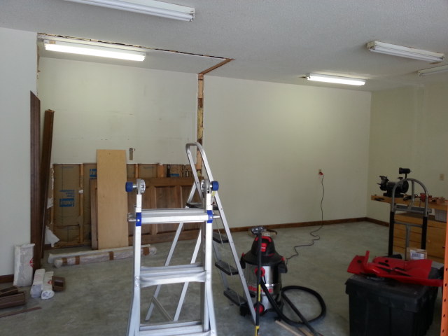

Soooo...I got a lot of things moved around last night and finished moving things out of the way to start the demo of the garage closet this morning.

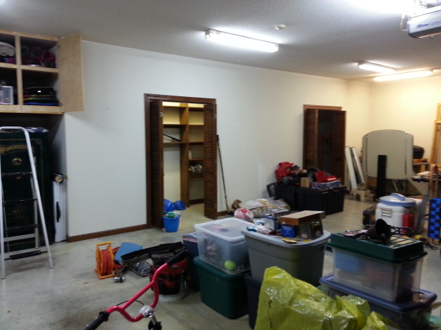

Here is where we started, close to 3 1/2 feet were taken up by the closet as far as space going to the back wall. It was about 20 feet to the point that we took out the wall right next to the water heating unit.

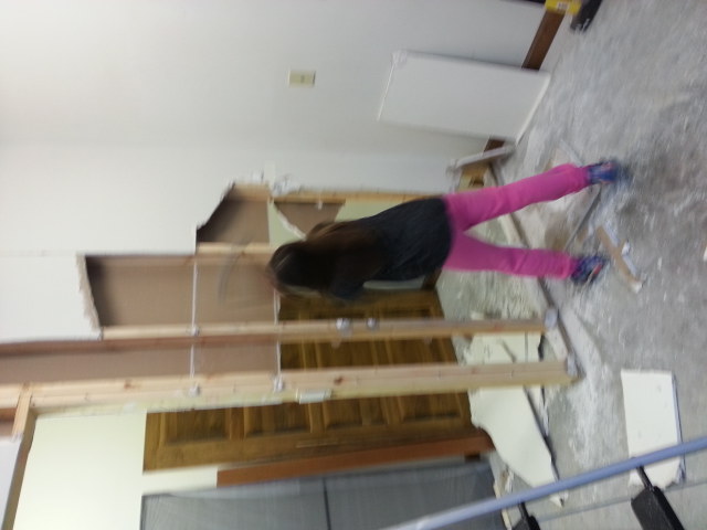

My daughter, Rianna, made sure I woke her up around 0730 so she could help. Mike, MBlizzard, showed up around 0745 and you can see the destruction taking place.
It took us about 4 hours to tear everything out and clean up. The garage looks much larger now!

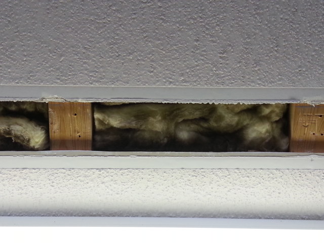

We also found some issues that I will have to deal with, termite trail up one 2x4 stud that I need to check to see if it needs replacement.
And what looks to be mold in the ceiling insulation.
I'll need to get into the attic and investigate. Needless to say, I can't do much more until I remedy these issues. I'll probably pull the rest of the drywall down tomorrow to check on the stud and make sure there are no other termite trails. I called it quits for today as I'm beat.
Getting closer to being able to get the Teener and MG so I can get back to work on them! (IMG:style_emoticons/default/sawzall-smiley.gif)

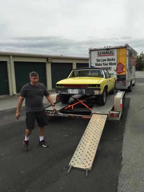

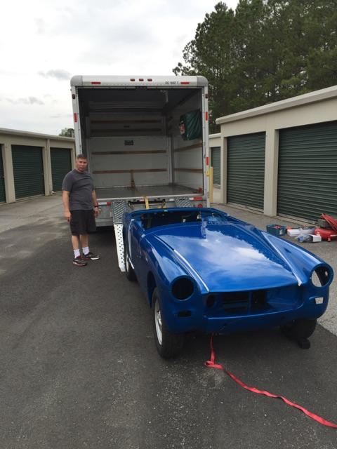

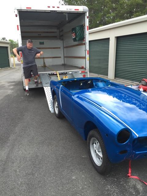

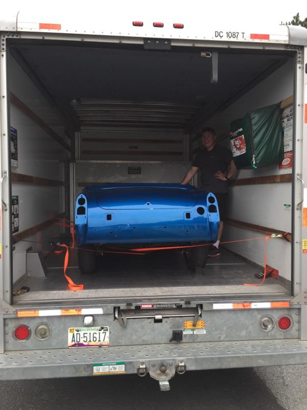

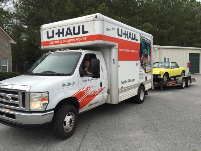

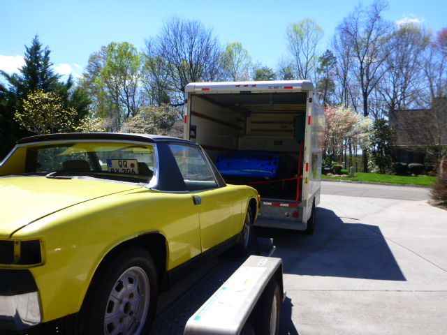

Well...The cars are back!! Headed to VA yesterday and met my buddy Leo at the storage unit. It took us about an hour and a half to load the MG and Teener. The Teener was easy, it went on the auto transport; the MG however was an entirely different story!
I didn't have the steering unit connected on the MG and neither wheels were connected to the steering rack so the first attempt to bring her up had the front wheels turning the wrong way. OK, lets try bringing her up from the back. NOPE! She would have bottomed out. Damn, now what? (IMG:style_emoticons/default/headbang.gif)
Then Leo had a brilliant idea, lets connect the wheels with a ratchet strap! (IMG:style_emoticons/default/idea.gif) So we ran the straps to the connecting ends of the wheel tie rod arms, tighten just enough so that one wheel causes the other to turn and...VOILA!! Wheels stay straight and we can get her up into the truck! (IMG:style_emoticons/default/aktion035.gif)
We had a 5000 lb ratchet strap we initially used as a come a long but once we got it up on the ramps we both just got behind her and pushed her up the rest of the way. Good thing its just a chassis on wheels! (IMG:style_emoticons/default/blink.gif)
I got back this afternoon and got the Teener off the auto transport and then moved and unhooked the transport. MBBlizzard will be coming to help me unload the MG tomorrow then we start work on the Teener Motor. I'll need a new clutch cable and speedometer cable though. They came loose and 450 miles of dragging on the road kinda hosed them. (IMG:style_emoticons/default/stromberg.gif) Now I gotta go and order me the lift!
I start at General Dynamics on the 11th of April so I need to get as much work done now before I start as I will be doing a lot of traveling. I'm thinking it won't be until May now until I get the lift ordered, delivered and installed.
Let the madness begin again!!!! (IMG:style_emoticons/default/lol-2.gif) (IMG:style_emoticons/default/lol-2.gif)

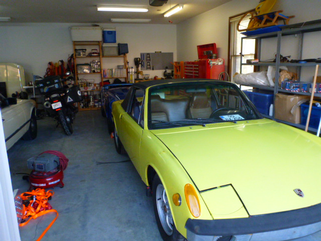

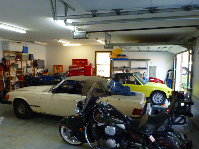

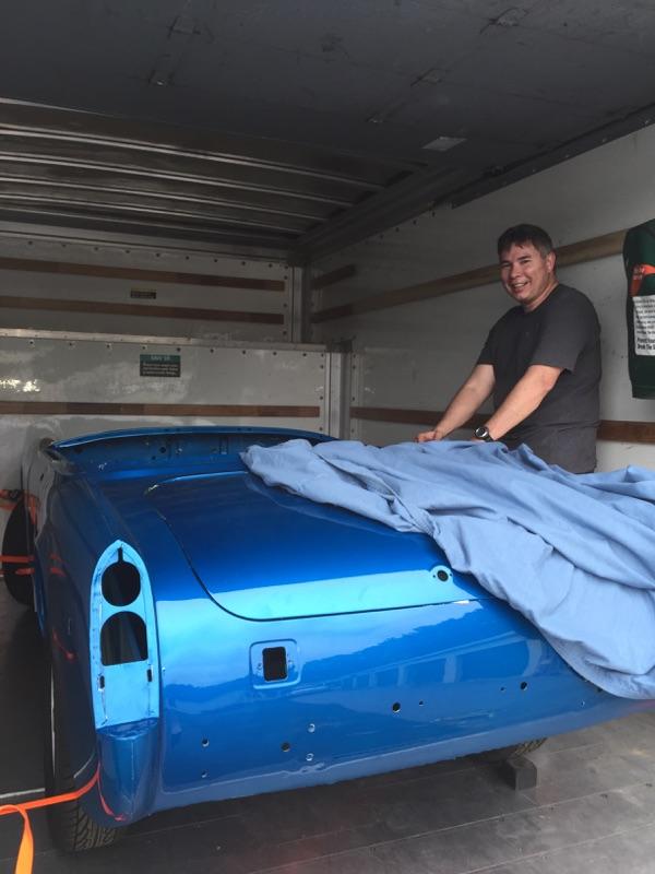

OK, so Mike came over this morning and we pulled the MG off. I had things pretty much set up and was installing the tie rod ends when he arrived. We hooked up a big ass ratchet strap to the front to control the car coming down then he and I slowly backed it off the trailer and down the ramps. When we got within 6 inches or so of the ratchet strap having tension we chocked each rear wheel and one of us would go up and loosen the strap some more. She came down a lot easier than she went up! (IMG:style_emoticons/default/happy11.gif)
So here is what a truck with two cars loaded up looks like.
Here is what is left of the clutch and speedo cables that drug on the ground. Good thing Mike has a couple of spares for me! (IMG:style_emoticons/default/blink.gif)
And now the garage is full! I will have the four post ordered next month and hopefully installed before the end of May. I'll start putting the Teener motor together this week.
It's kinda hard to see but on the right fender their is a perfect line of rust and paint bubbling. Methinks the previous owner did a shitty repair on the fender! (IMG:style_emoticons/default/mad.gif) I'm gonna have to grind off the paint and see what I am dealing with but I felt a strip of something on the underside of the fender so I'm thinking whoever 'fixed' it only applied a bandaid fix. I'm hoping that I can still salvage it and don't have to do any major repair work, we'll see.

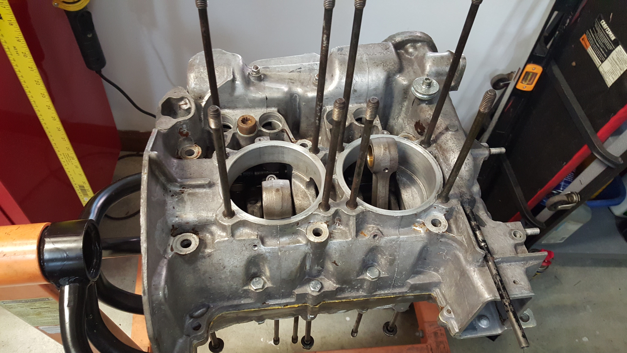

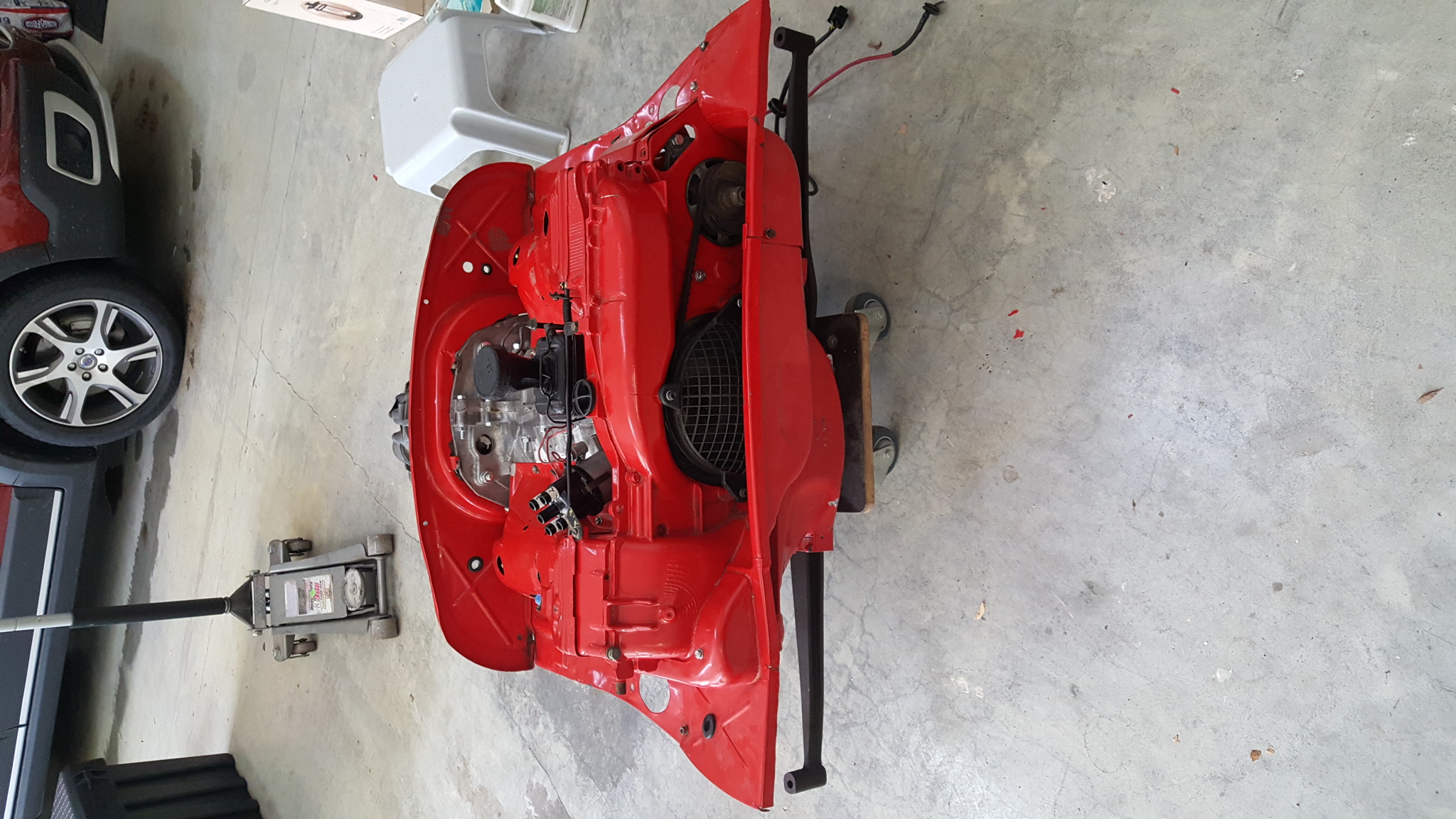

After a week on the road with my new job I got back late Friday night. I wanted to start on Saturday but I had some honey do's that I needed to get done and I watched a movie with my daughter. Unfortunately, she also has walking pneumonia so things have been a bit hectic.

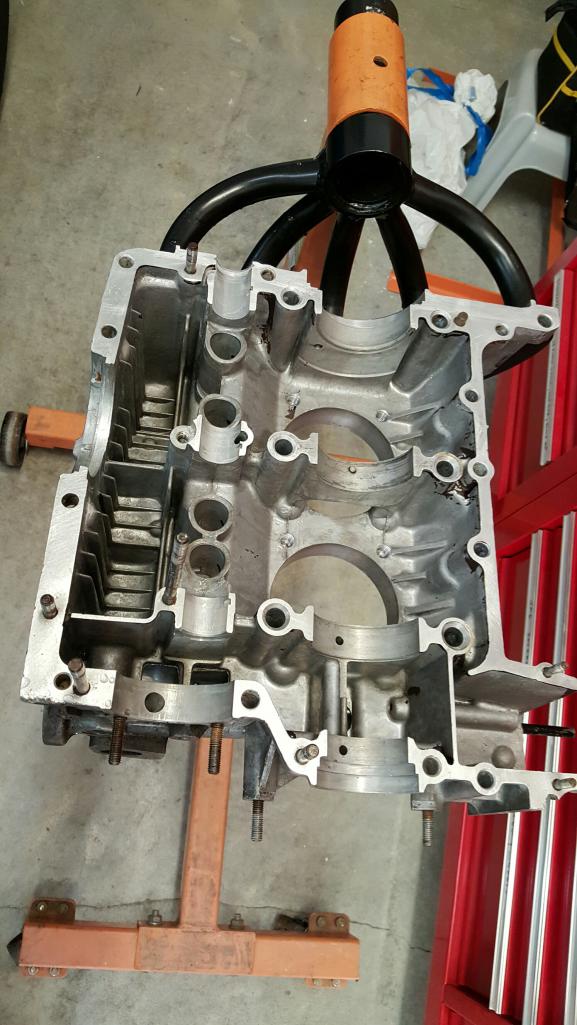

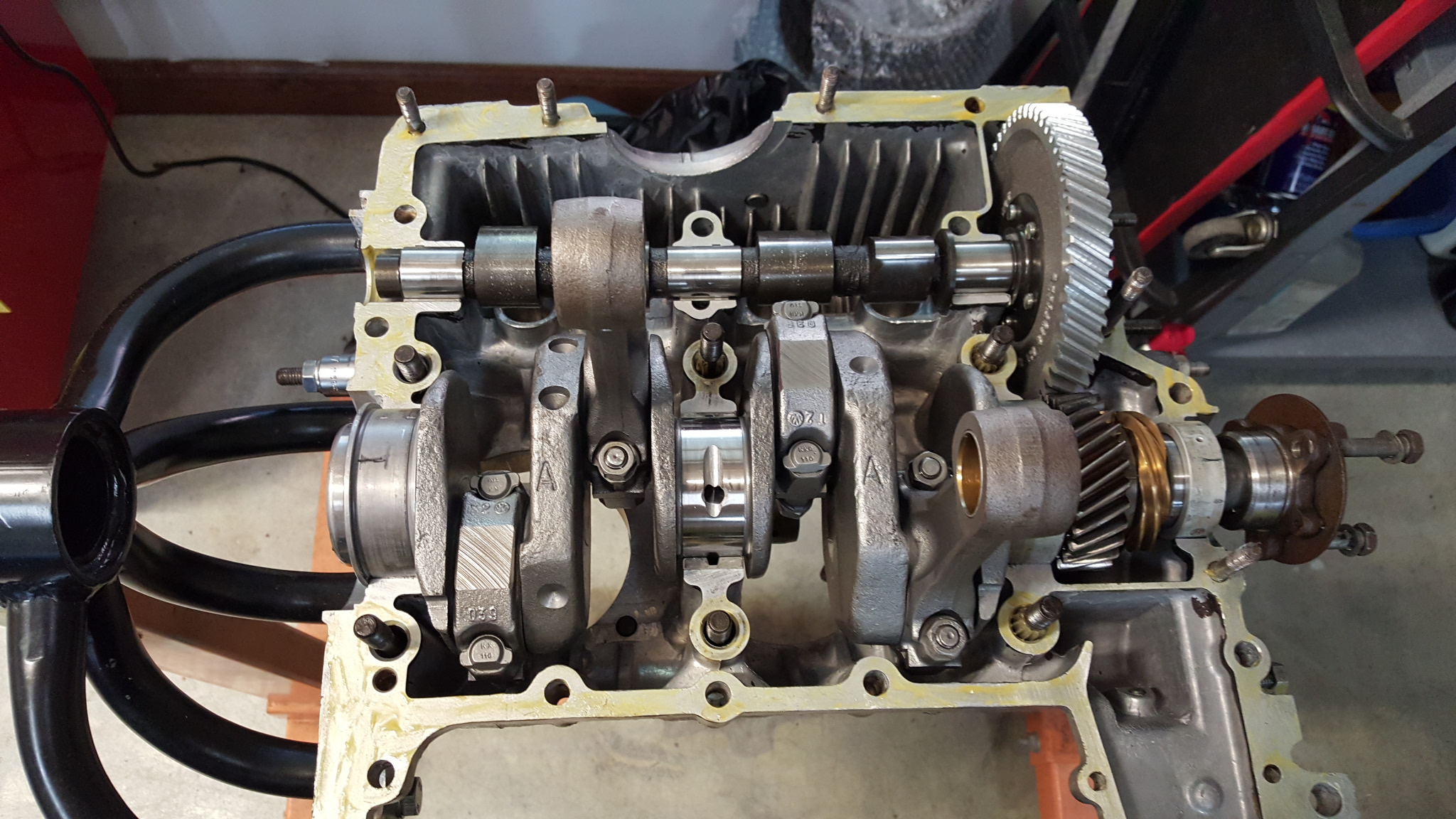

I finally got the chance to pull the motor out of the tuff box this afternoon. I cleaned up each case half and will wrap them in plastic to keep any dirt, dust or debri from accumulating. It will have to stay that way until next weekend as I hit the road again tomorrow to work on some production line issues with the vehicle we were contracted to build. Hopefully, my daughter will be well by the time I get back so I can get more done. At least its a start! (IMG:style_emoticons/default/beer.gif)

OK, need some help. Evidently the dowel pin, 111-101-123, straight pin for crankshaft bearing, has fallen out of one of my crankcase halves. I kinda need that to keep the bearing from spinning and ensuring it lines up with the oil lubrication holes.
PP has them for about a $1 but then wants $4.75 to ship the damn thing! (IMG:style_emoticons/default/headbang.gif)
I don't suppose anyone has an extra one they'd like to part with or knows the measurements so I can try to source it that way? (IMG:style_emoticons/default/confused24.gif)

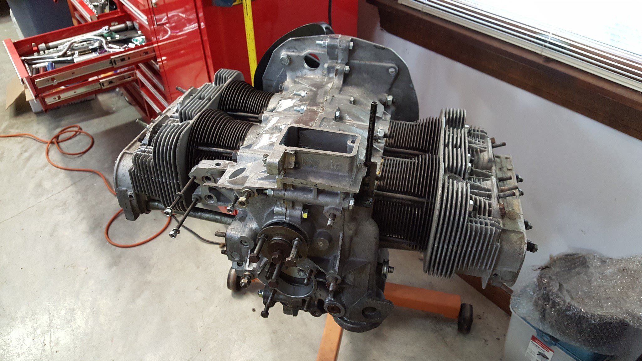

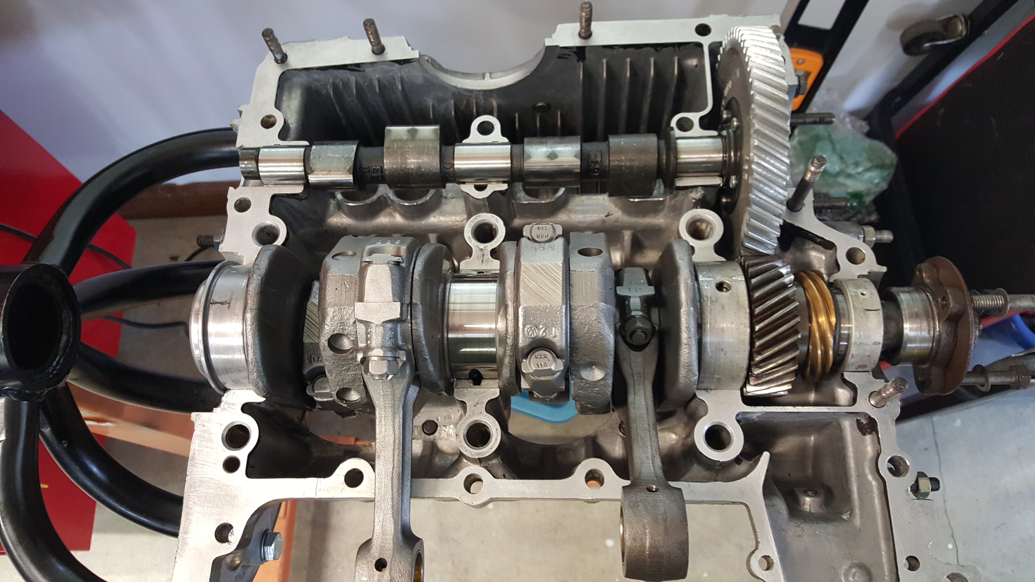

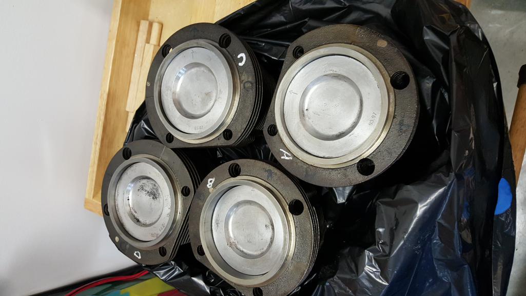

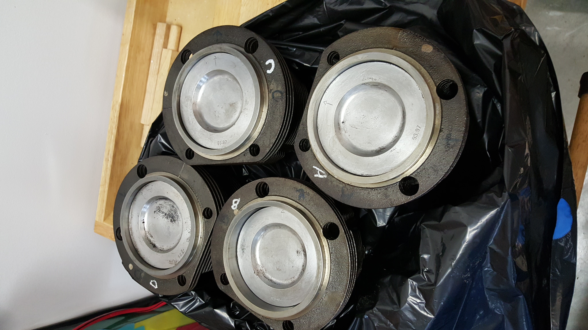

OK, it's much harder to put a car together when you're on the road all the time. (IMG:style_emoticons/default/dry.gif)
Anyway, back for the weekend and got some work done.

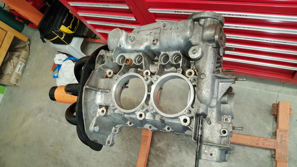

Got these cleaned up, new rings installed and they are ready for install.

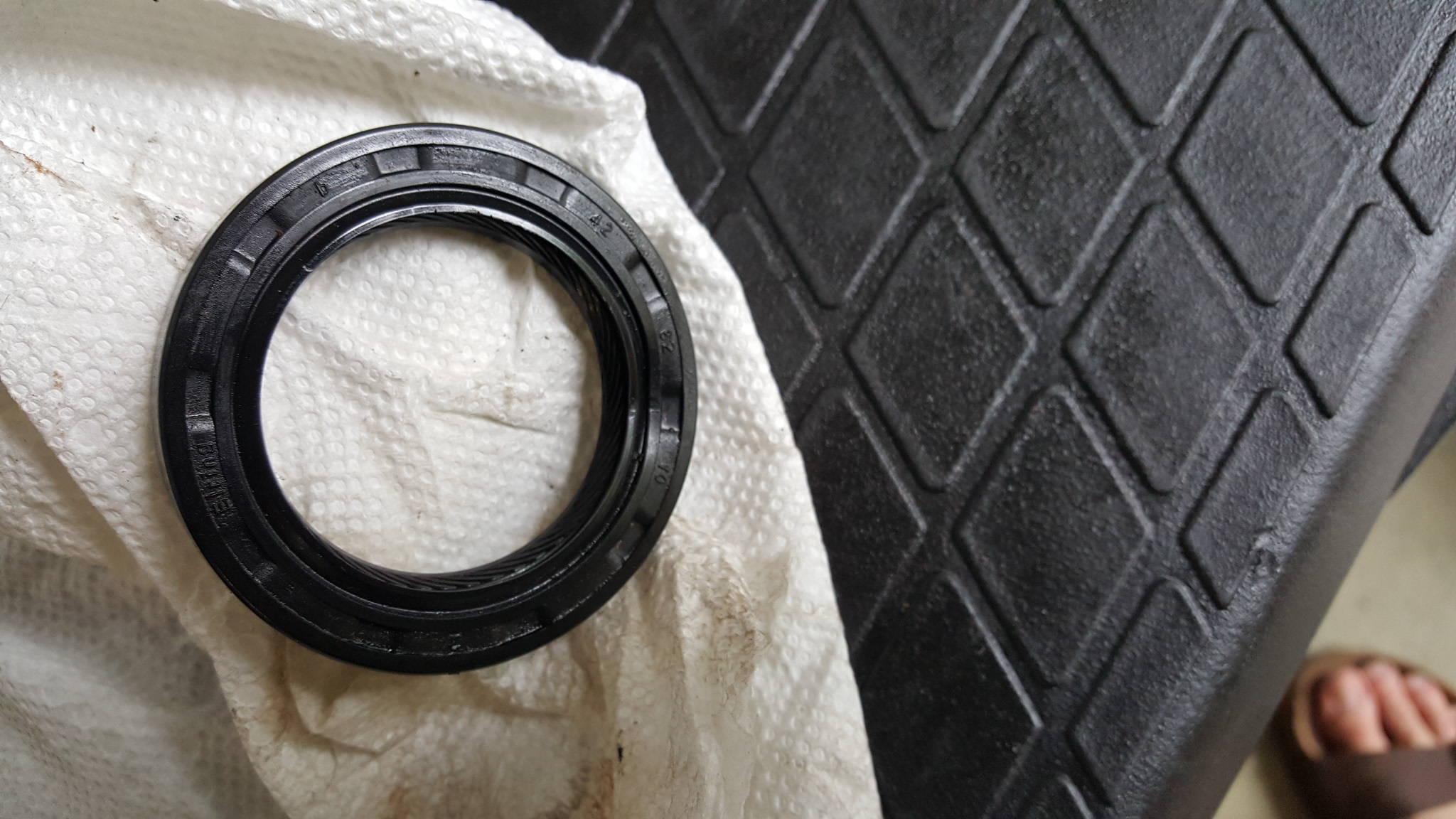

Got the crank and cam in but the front pulley seal is deformed so I ordered another front and main rear just in case. I had gotten in the locating pins so everything is now good on the crank bearings.
May have been able to use this but I wasn't taking any chances.
I'm on the road again tomorrow but hopefully my seals will be in by the time I get back so I can finish putting the case together and install the pistons and cylinders. Slow but steady.

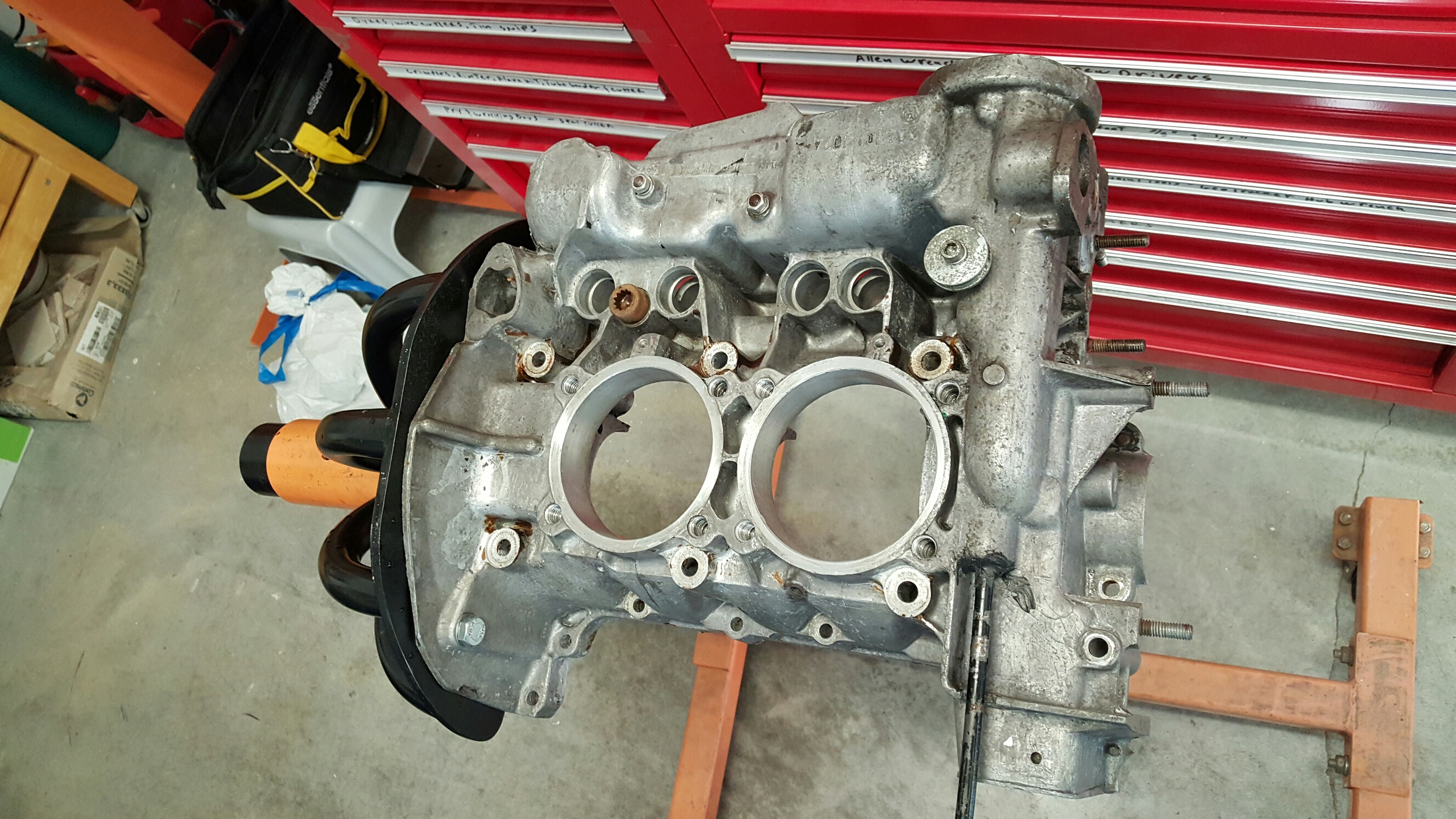

Been a busy month but got some time to work on the motor. Need to add a few more bolts and nuts then torque and she is ready for they cylinder and pistons. Thankfully Mike Blizzard remembered to ask the question about the timing marks on the Cam and crank; I had forgotten about that. It would not have ended well as I had the marks 180 out! (IMG:style_emoticons/default/blink.gif)
I need to pick up a couple more bolts as I bought the wrong length and I'll have everything bolted up and ready to torque. Next the fun begins with installing the cylinder's and pistons, that was always a pain in the butt. (IMG:style_emoticons/default/dry.gif)

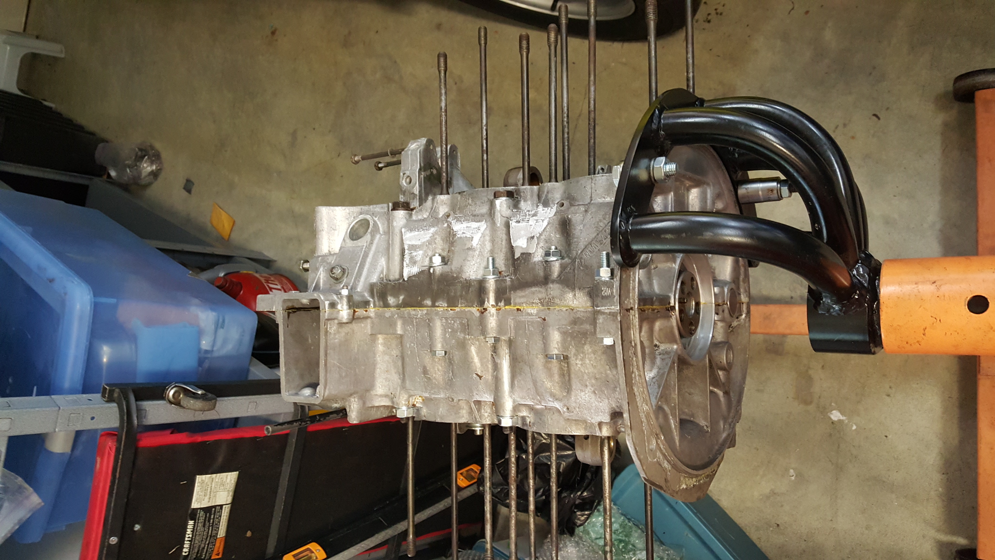

Hope everyone is having a great 4th of July celebration! (IMG:style_emoticons/default/beer.gif) (IMG:style_emoticons/default/351.gif)
I spent a long week over in St. Petersburg, FL last week with wife and daughter in tow. They got to go and see things while I spent the week in meetings and working groups at our corporate headquarters. (IMG:style_emoticons/default/dry.gif) At least I spent time out on my bosses boat on Saturday before we came back on Sunday.

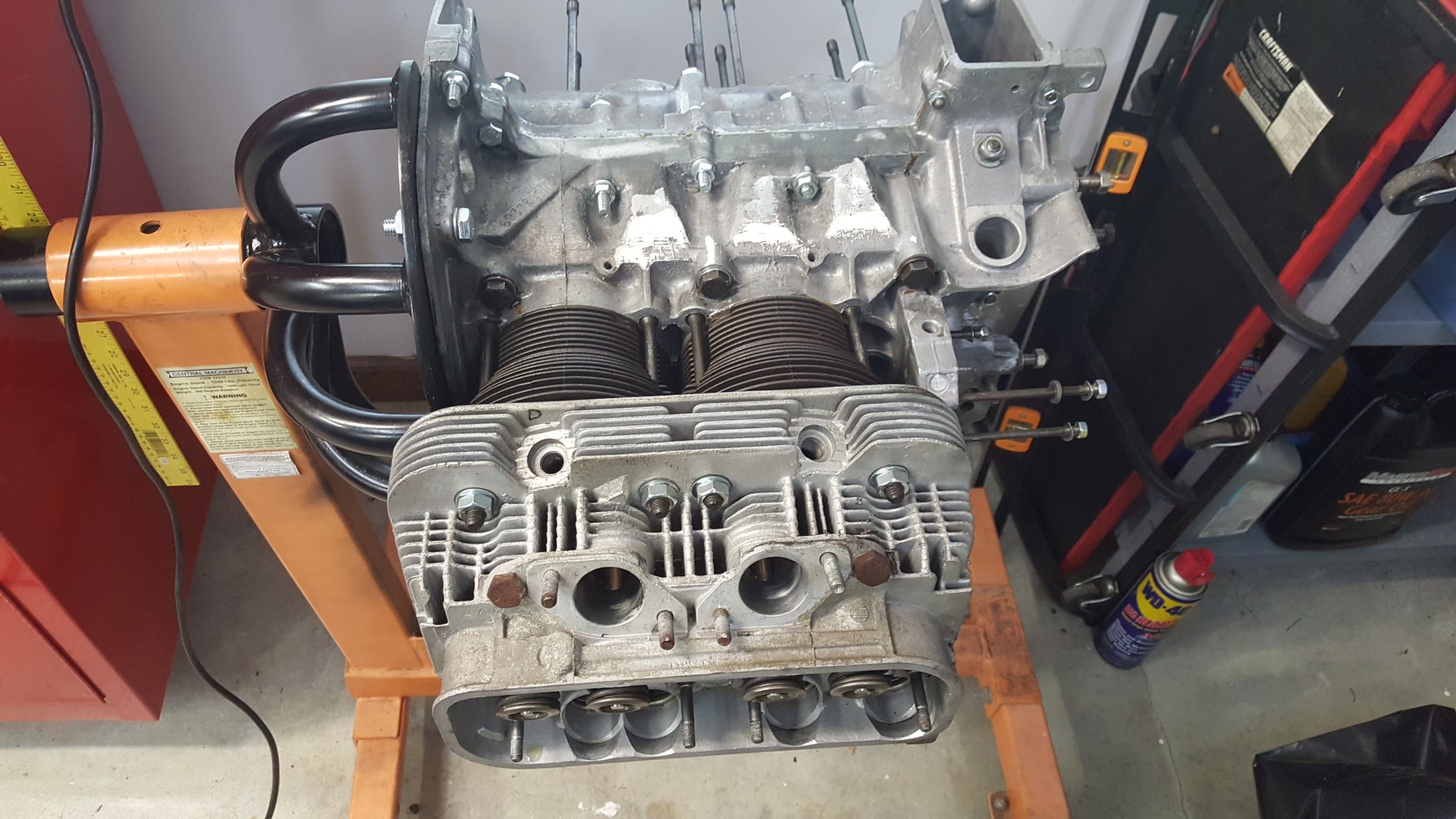

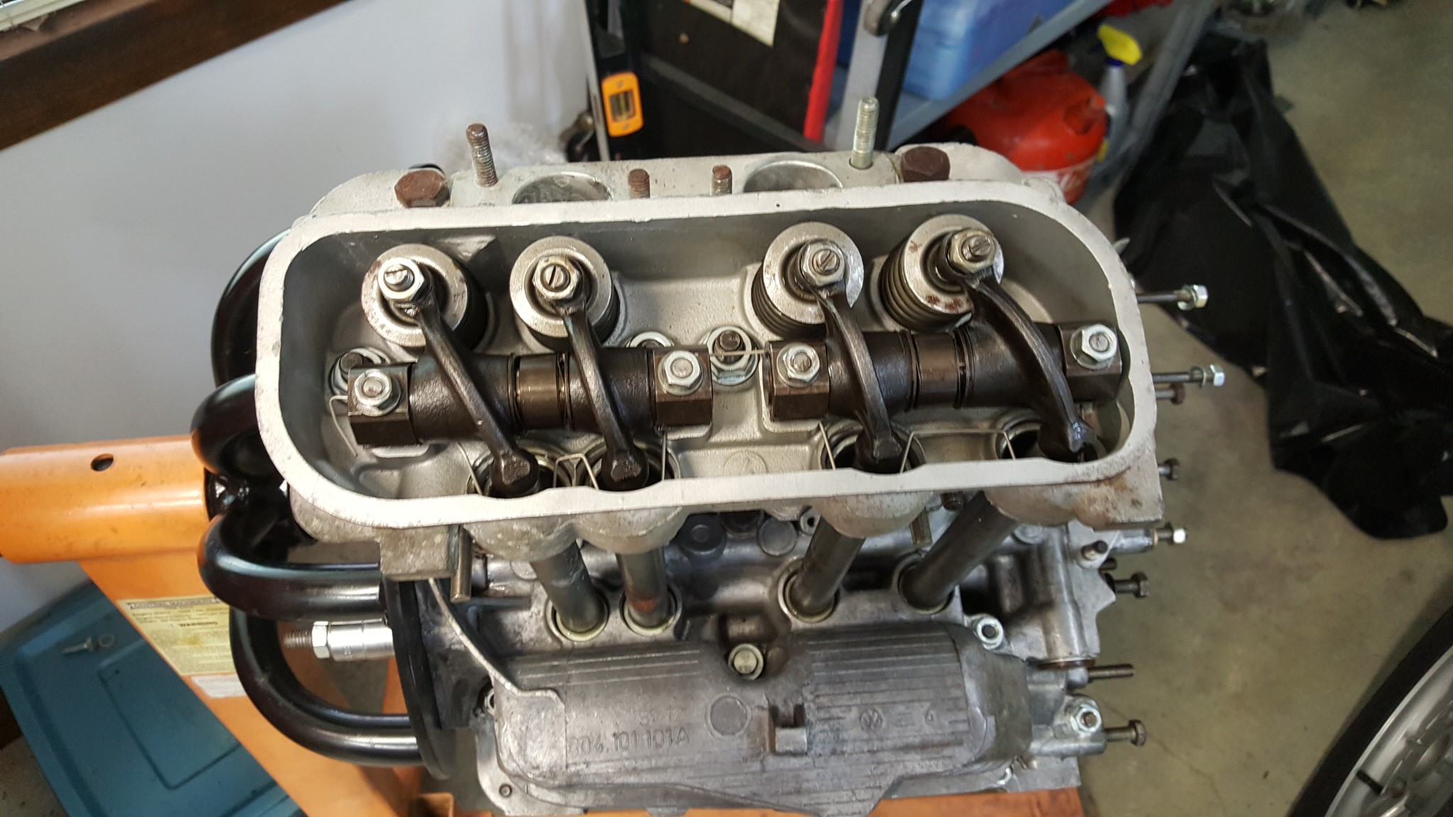

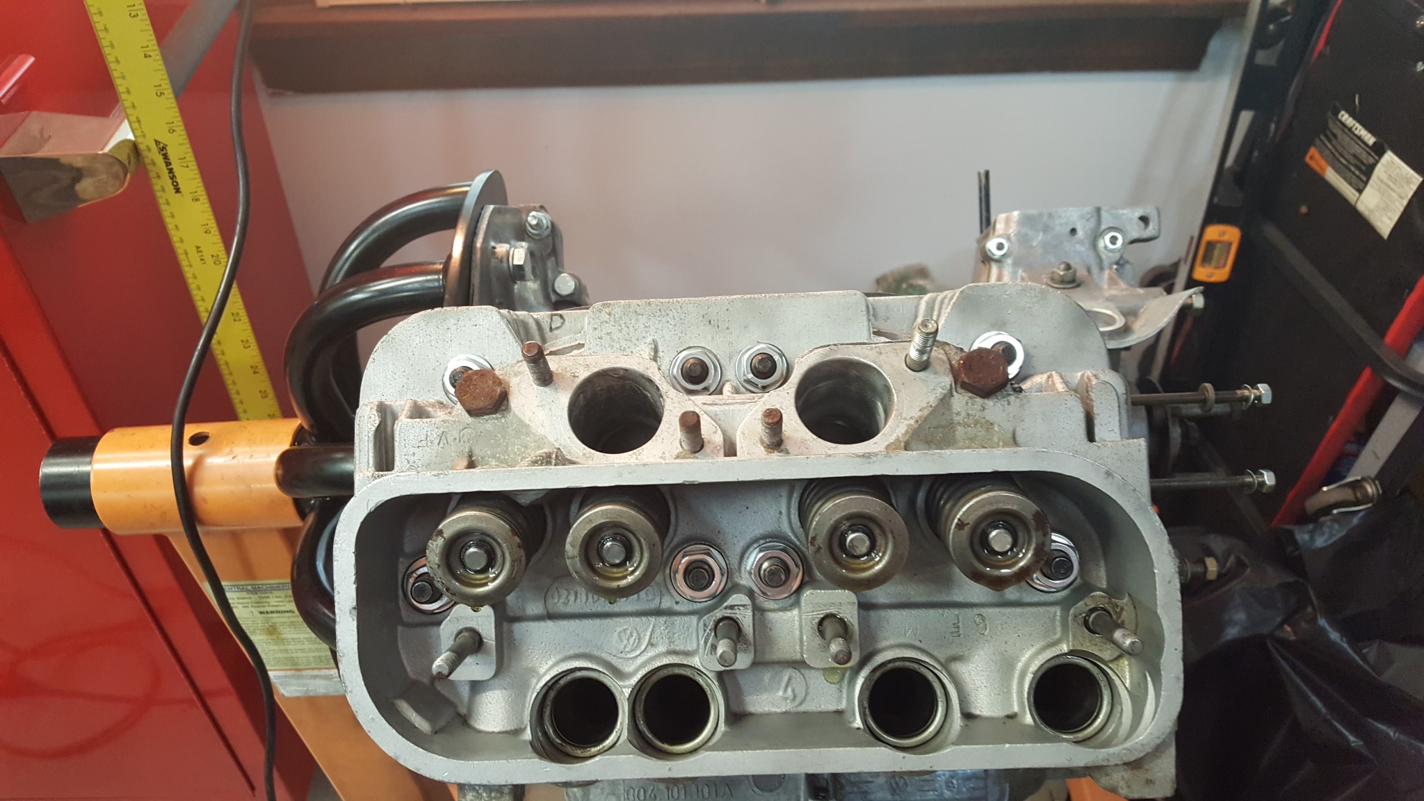

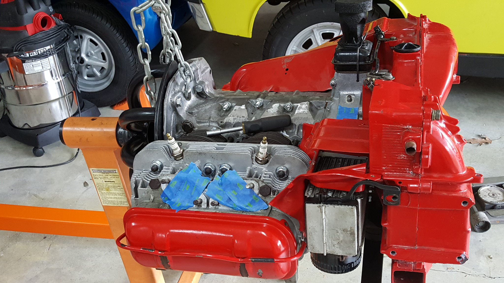

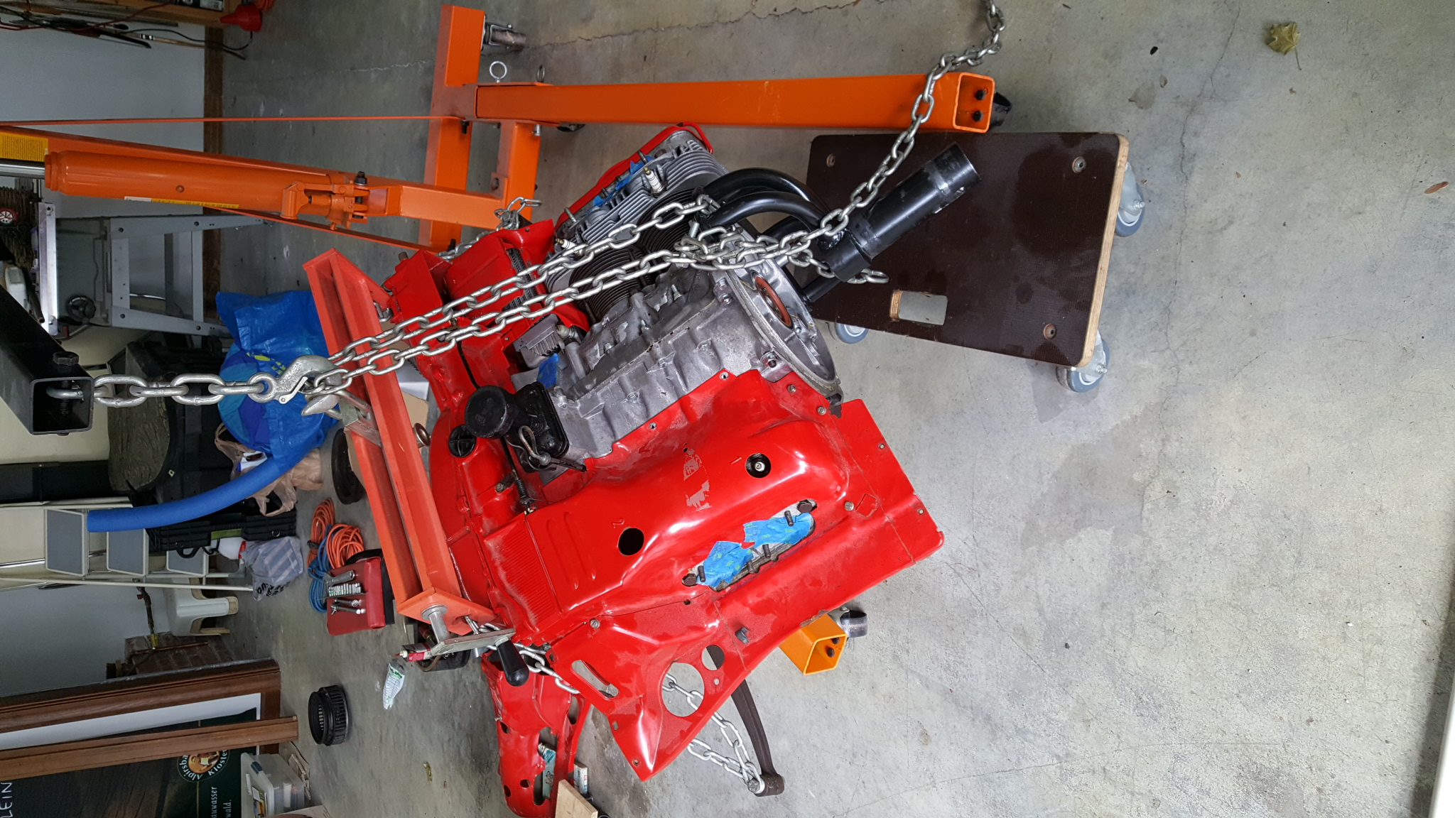

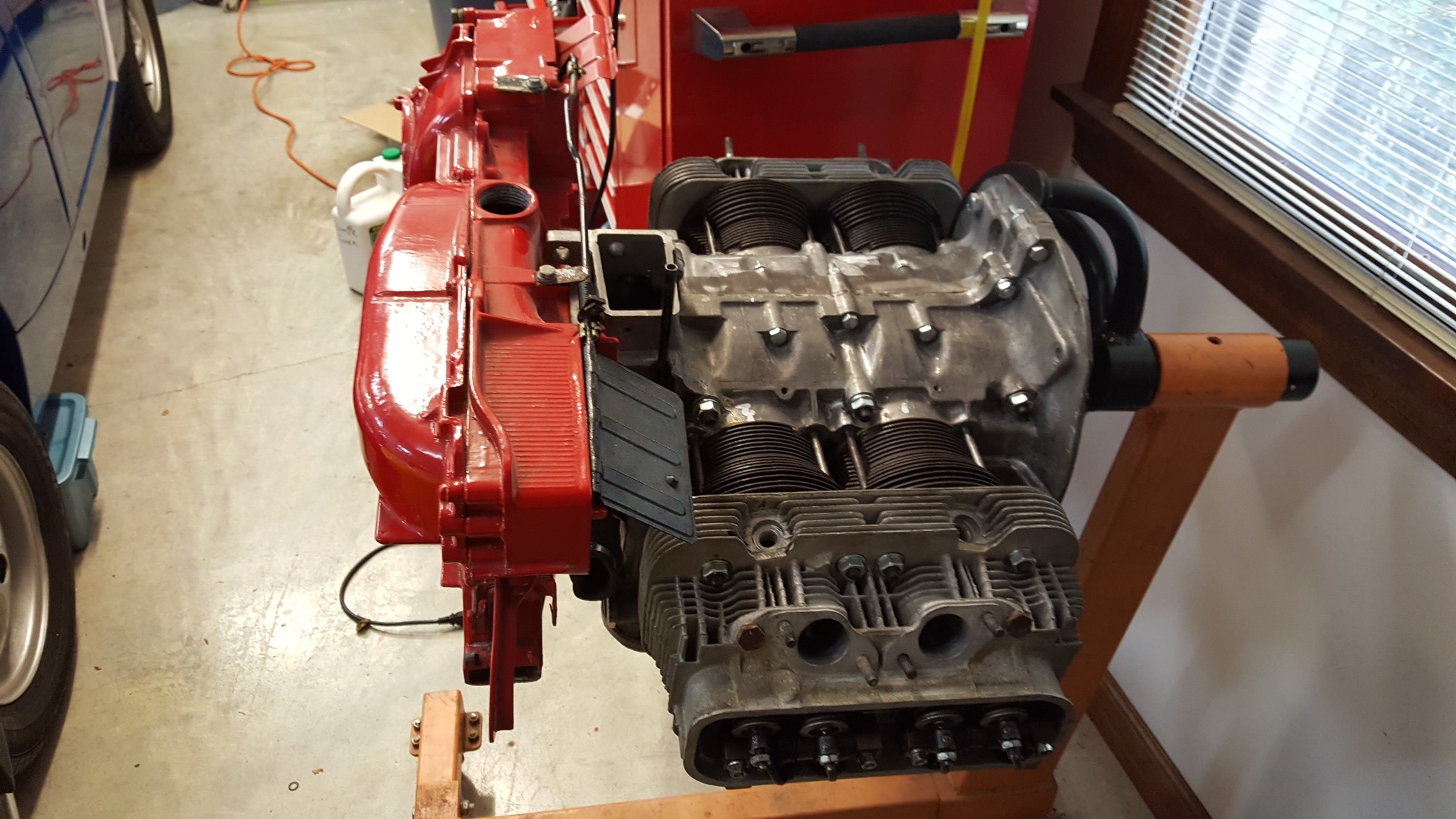

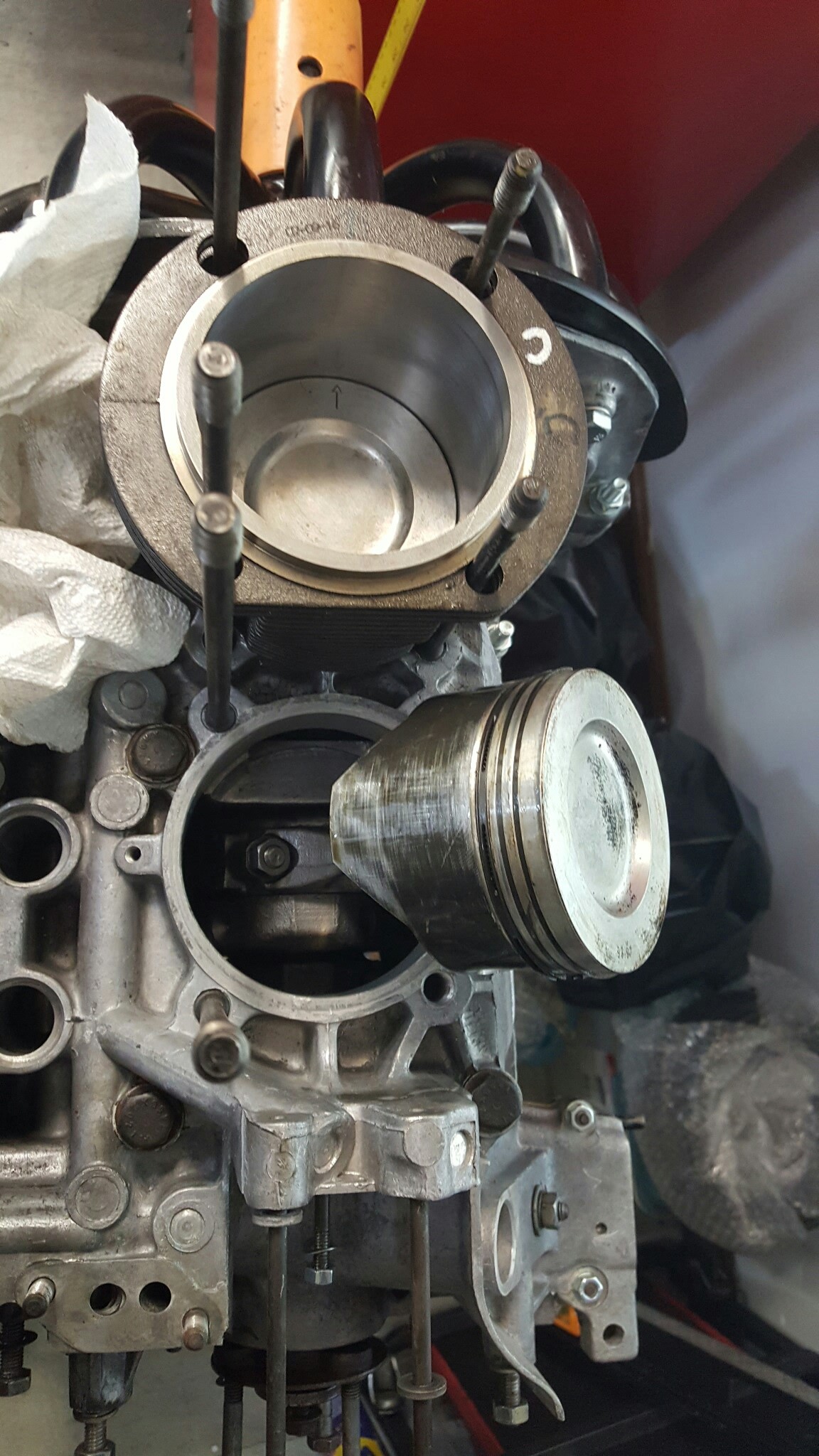

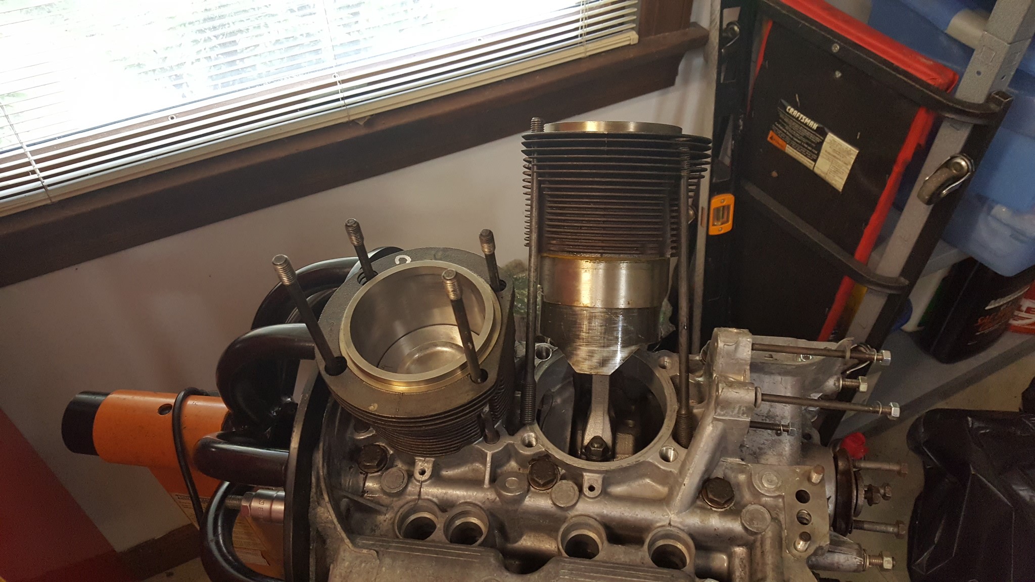

I got to work on the motor today and got the passenger's side done with the exception of installing the rocker assembly and push rods. I'll do those after I get the other side put together.
I didn't realize that when you have the case cradle that it hinders your ability to just slide on the piston and cylinder assembly and put in the wrist pins and circlips to connect the piston rods. NOW I understand why Porsche uses the piston ring compressor design they do! Thankfully, I found the damn thing! So here is today's effort, I am taking a break and may go out in a bit and work on the other side.
Not how I wanted to put it on!
I had removed the head studs to make it easier to maneuver.
Time to torque the head.
One side down, one side to go!
I chased the exhaust studs before I assembled it to ensure I had no crud built up on it. I'll clean up the intake studs before I start assembling anything else. With any luck, I'll have the base motor done before I have to start traveling again on Wednesday then I get to mess with the FI system.
stephenaki
post Jul 9 2016, 04:14 PM
Post #417
Can I get this one dad??
Posts: 1,191
Joined: 11-August 07
From: Palmetto, FL
Member No.: 7,987
Other side done, partially installed impeller. fan Will adjust valve clearance tomorrow then, on the road again!

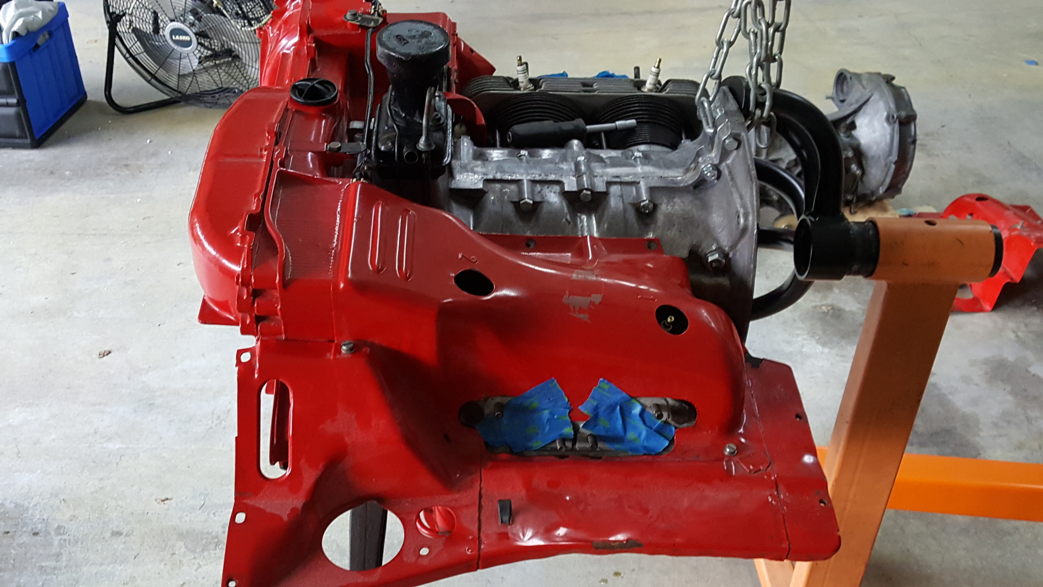

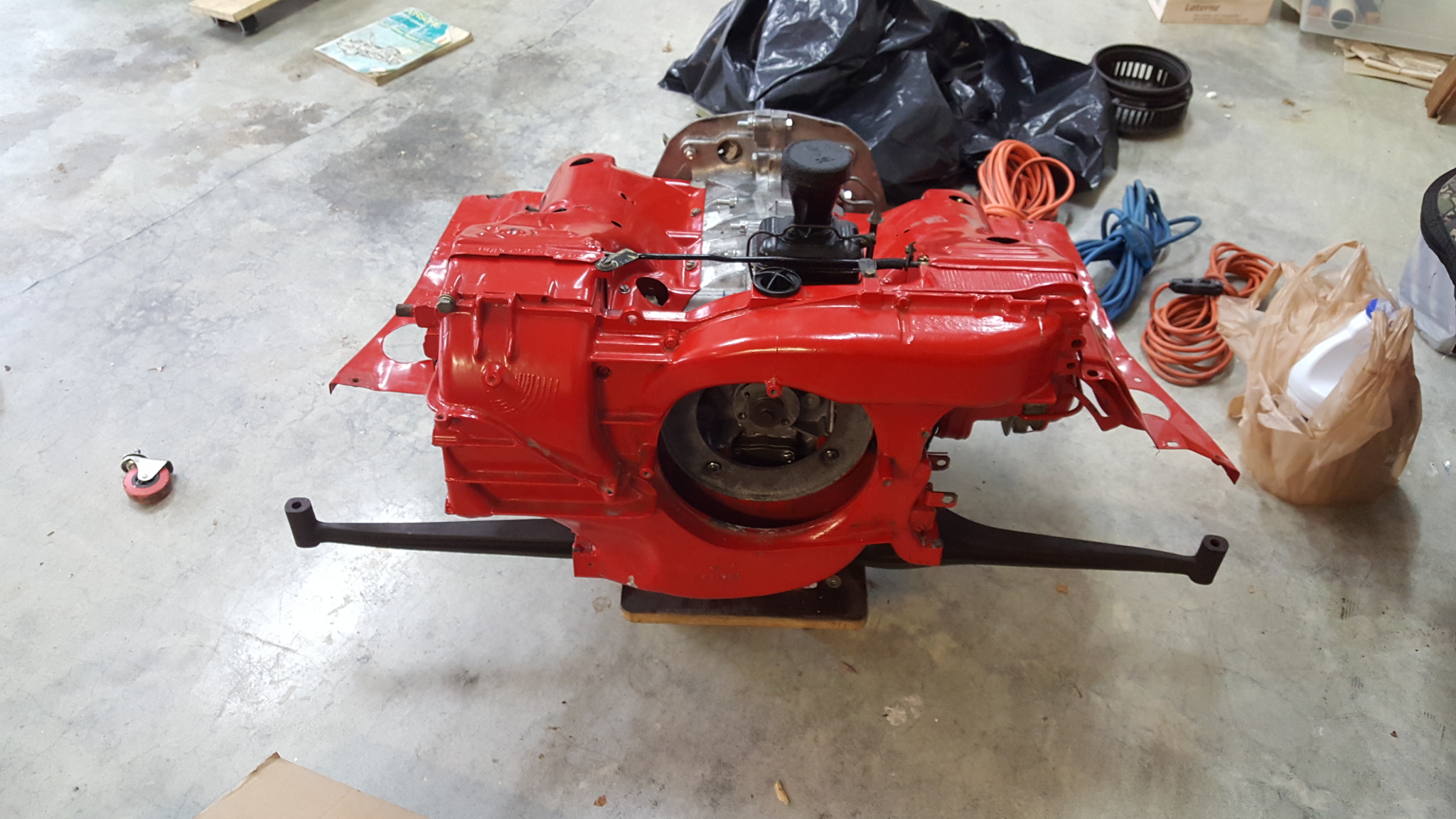

Well, I've been a bit busy this weekend. I've been on the road for pretty much four weeks straight and finally got to come home for a week or so. I had done some work about three weeks ago when I was home for the weekend so was able to finish the rest off this weekend. (IMG:style_emoticons/default/aktion035.gif)
First off, one must remember that engine tin goes on UNDER push tubes! (IMG:style_emoticons/default/headbang.gif) It's even worse when you put oil in it then have to take things apart to fix your screw up! (IMG:style_emoticons/default/dry.gif)
That being said, got most of the tin on yesterday but had to pull her off the stand as the cradle interfered with the rest of the tin.
Well, my first thought wasn't so smart. I had thought the wife could help, she gave me the, 'your on serious fucking crack!' look. She said, call Mikey! (MBlizzard)
Nope, not gonna bother Mikey, I just had to think it through. She came down perfect!
Got a lot put on yesterday before I called it a day. I can tell I am way out of shape, I was aching yesterday after I was done!

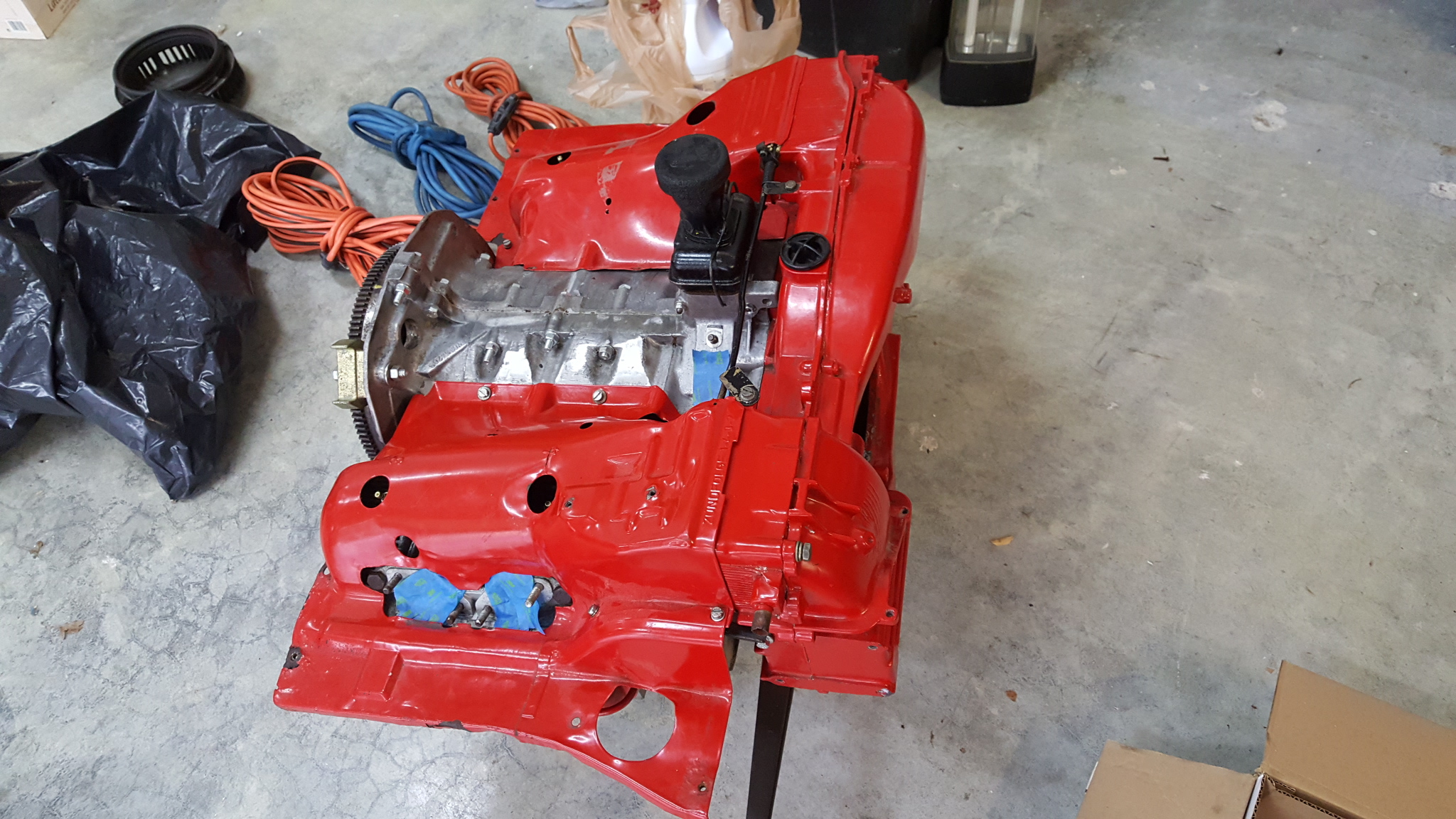

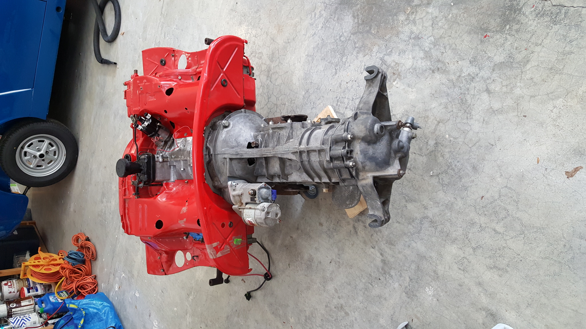

So today I finished her up and got the dizzy in, all the tin on and gearbox mated up.
I have a box full of FI parts that I'll start going through this weekend to see what I have, what needs some help and cleaning, etc. I'm hoping to get it all sorted before I head off to Florida again in a couple of weeks. I am not doing two week stints at our corporate HQ so it makes things a bit more challenging to get to. Progress is being made. Once I get this all sorted it will be time to start prepping the bay for the transition to a side shift setup.
