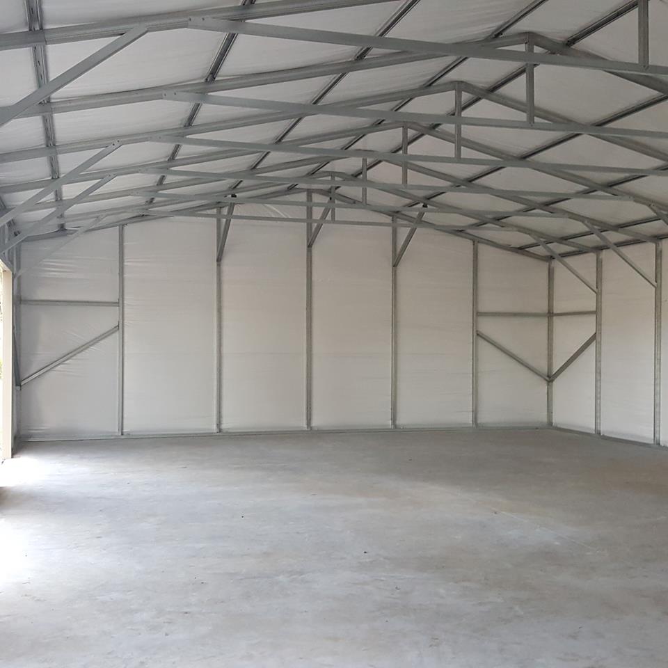

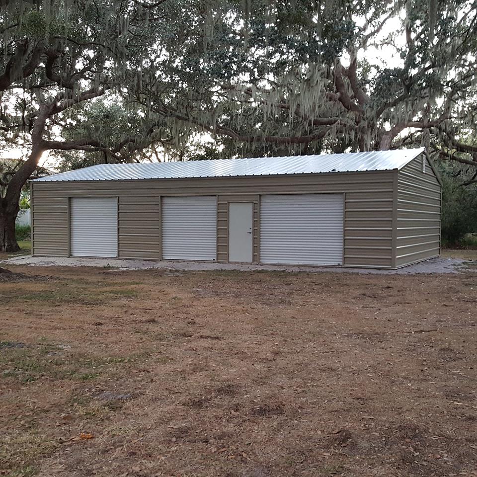

Sooooo...I've been a bit busy. We moved down to lovely Florida this past June and I have been swamped with both work and house projects. I kinda focused on getting the MG Midget put back together and put the teener on the back burner. I did however manage to finally get my workshop up.
(IMG:http://www.914world.com/bbs2/uploads_offsite/image.ibb.co-7987-1512917845.1.jpg)
(IMG:http://www.914world.com/bbs2/uploads_offsite/image.ibb.co-7987-1512917846.2.jpg)
It is a 30' x 50' in the back of the house. I have to run electrical to it which I am working on now and eventually get the plumbing hooked up. I have to finish the interior and will put up OSB to protect the insulation from damage and will eventually put down Polyurea flooring.
I have a lift coming and will hopefully get that installed this coming week. I'm happy with the building, I just need to get some things cleaned up before I start moving everything over. I'm hoping to be able to start operating out of it by the end of January if not sooner.

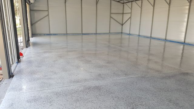

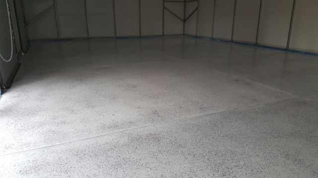

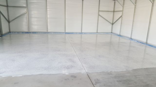

OK, the floor is done. First up observations.
1. 1500 SqFt is an ass kicker! (IMG:style_emoticons/default/blink.gif)
2. Use proper PPE (personal protective equipment) when putting down the coating especially the paint respirator. The fumes are pretty heavy, you NEED a respirator! Use gloves, lots of them. Get a box of nitrile, latex or whatever but use them. You will go through a lot of them. Make sure you have a dust mask if grinding the cement.
3. Take the time to properly prep the floor. Grinding is the most preferred but also the most labor intensive. I did a chemical etch on the areas that the grinder could not get to.
4. Section off your work and lay the coating by sections. This helps determine how much is needed per section, and gives you a good feel for how thick it should be. I did not do this initially so some areas are heavier than others.
5. Use a hand held quart measure, painter's helper cup, and pour a quart at a time to work with especially the base coat. Don't pour a big glop on the floor, make a ribbon that you work with, it is easier and spreads better.
6. Use spikey shoe strap-ons, you will have to walk on areas where you have laid coating, you will need the spike shoes.
7. Clear coat is really friggin slick!!! Be very cautious when you walk on it with the spike shoes. The anti-skid ingredient, if used, doesn't work until after the floor dries.
8. Clear coat goes on a lot easier and quicker than the base coat.
9. If you grind and use water with the grinder, use two people. The slurry masks the area as you go so you lose site of where you need to grind. The second person can work the hose and help spray the slurry away so you can see what you are doing.
10. If you are dry grinding, get a good vacuum to help keep the dust down. Same issue with slurry, the dust will obscure the area so you can't see what you have done and what you need to do.
11. Make sure the roller you use is for epoxy/polyurea application. DO NOT use just a regular roller. You can get them at Home Depot or Lowes or order them on Amazon.
12. When using the anti-skid in the clear coat, always stir it well before applying to the floor. It is a heavy metal that will sink and settle, you need to make sure you keep stirring it before you scoop any up and apply it.
This is not a couple of hour project! It took me two days to grind the concrete and about a half day to remove all the dust and chemical etch the rest of the floor. It took me 7 HOURS to lay down the base coat. So basically, 3 1/2 hours for about 750 SqFt, it is very labor intensive and the base coat is the most challenging to lay down.
It took me only about 3 1/2 hours to lay down the clear coat as the base is relatively smooth so the clear coat glides on easier. It is a bit more difficult to see the areas you have covered with the clear coat, make sure you have good lighting so you can see the "sheen" of the freshly applied clear coat.
Pictures will follow shortly, they aren't a lot but they will give you the general idea.

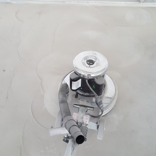

(IMG:http://www.914world.com/bbs2/uploads_offsite/image.ibb.co-7987-1514676606.1.jpg)
The concrete is new but it is very smooth so will not hold the coating, it needs to be prepped.
(IMG:http://www.914world.com/bbs2/uploads_offsite/image.ibb.co-7987-1514676607.2.jpg)

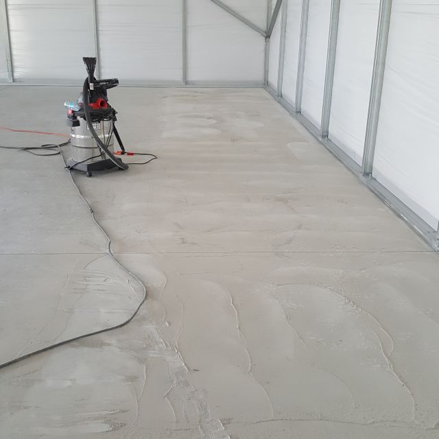

This is a regular floor polisher with a Diamabrush concrete prep tool attached. It works well and is cheaper than a grinder. If you have a large space, I recommend a grinder. I switched to a grinder to finish the job
(IMG:http://www.914world.com/bbs2/uploads_offsite/image.ibb.co-7987-1514676607.3.jpg)
(IMG:http://www.914world.com/bbs2/uploads_offsite/image.ibb.co-7987-1514676607.4.jpg)
The dust mask is simple but needed, a lot of dust was kicked up, my vacuum couldn't keep up!

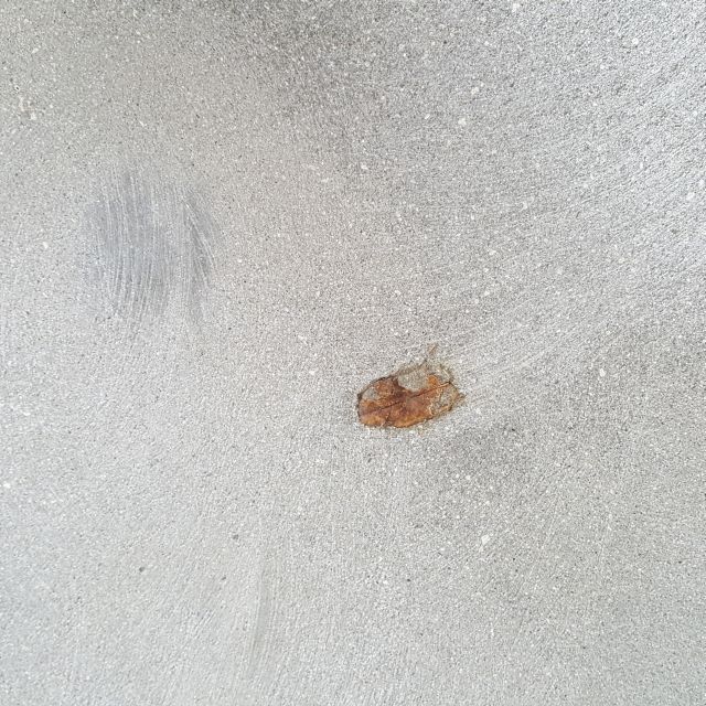

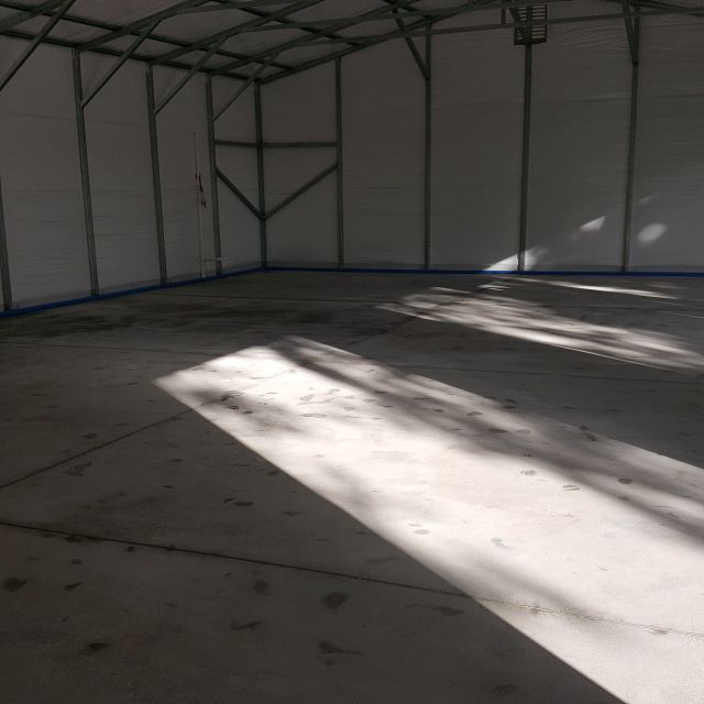

(IMG:http://www.914world.com/bbs2/uploads_offsite/image.ibb.co-7987-1514677007.1.jpg)
Fucking Leaves!! The concrete contractor didn't make sure the leaves were out of the slab so I had several that I had to pick out of the slab prior to laying the floor.
(IMG:http://www.914world.com/bbs2/uploads_offsite/image.ibb.co-7987-1514677007.2.jpg)
Grinding done, you can see a difference in the floor texture.

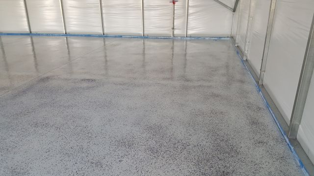

(IMG:http://www.914world.com/bbs2/uploads_offsite/image.ibb.co-7987-1514677007.3.jpg)
Swapped masks for a paint mask. No way you can handle the fumes without one and I had all three garage doors and pedestrian door open!
(IMG:http://www.914world.com/bbs2/uploads_offsite/image.ibb.co-7987-1514677007.4.jpg)
Halfway done with the base coat.
(IMG:http://www.914world.com/bbs2/uploads_offsite/image.ibb.co-7987-1514677008.5.jpg)
Base coat done!
You are supposed to wait a minimum of 6 hours before applying the clear coat. I gave it a complete day as I was sore as hell the next day. I finished up the clear coat today in about half the time and not nearly as labor intensive.

Last of the pictures.
(IMG:http://www.914world.com/bbs2/uploads_offsite/image.ibb.co-7987-1514677474.1.jpg)
(IMG:http://www.914world.com/bbs2/uploads_offsite/image.ibb.co-7987-1514677477.2.jpg)
These are pictures of the clear coat. You can see the sheen of the coat which is a good way to tell where you have missed. The base coat is somewhat glossy but the clear coat is much shinier when you are applying it and you can see the difference.
Additionally, with the anti-skip applied, the coating is somewhat yellowish so this also helps a bit when applying. With this product it takes 72 hrs to completely cure. There are other products out there from their competitors that take less time to cure but they are almost double the cost.
All I have left is to build cement ramps (easy to do yourself), get the electrical hooked up and start moving things in. I'll probably have things in before the ramps and electrical are in and it looks like the two post lift will go in next weekend. Perfect timing.
If anyone has any specific questions send me a PM and I will answer it best I can.
