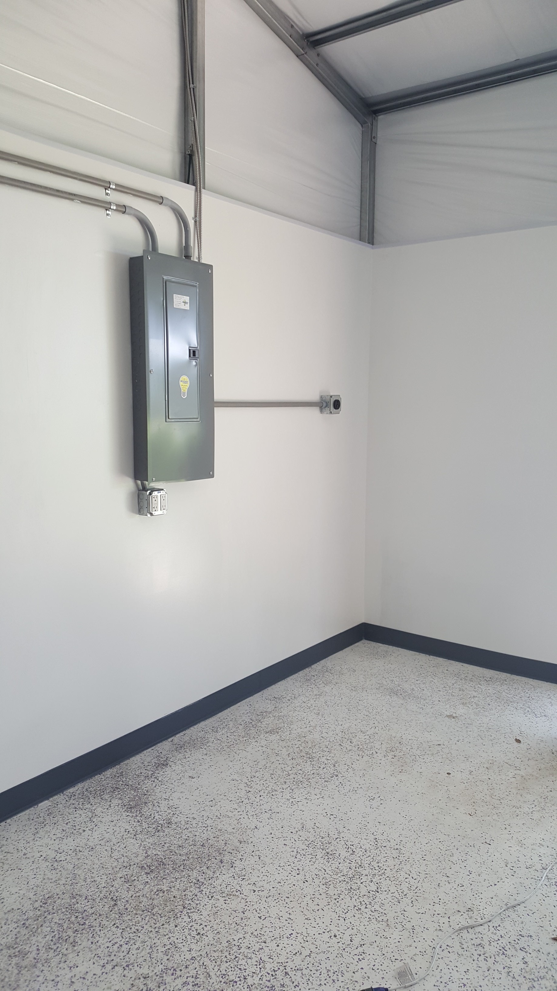

Soooo...I've been a bit busy with the workshop and finally got all the wiring done and it passed inspection. I have the plumber coming out today to give me a quote on plumbing a bathroom and sink. All the walls are painted, J-trim is in place on the drywall and I put in a 4" vinyl wall base that I sealed with silicone to keep water out. Here is a small snapshot of what it looks like, I'm putting things away now and organizing.
(IMG:http://www.914world.com/bbs2/uploads_offsite/image.ibb.co-7987-1528900961.1.jpg)

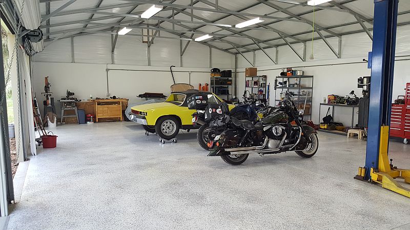

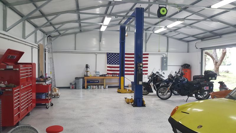

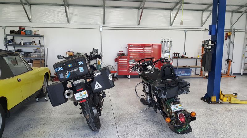

OK, finally done. Well, with the exception of the air system but I will get that done later. I can now start working on the cars, first up will be the MG then I'll tackle the Teener.
(IMG:http://www.914world.com/bbs2/uploads_offsite/image.ibb.co-7987-1529357226.1.jpg)
(IMG:http://www.914world.com/bbs2/uploads_offsite/image.ibb.co-7987-1529357227.2.jpg)
(IMG:http://www.914world.com/bbs2/uploads_offsite/image.ibb.co-7987-1529357228.3.jpg)
(IMG:http://www.914world.com/bbs2/uploads_offsite/image.ibb.co-7987-1529357228.4.jpg)
I will start with the wiring harness as it needs to be cleaned up and re-wrapped. Then I need to lay some heat matting before I put the harness into the vehicle. Lets see how quickly I can get things done! Helps that I'm retired and have nothing better to do (IMG:style_emoticons/default/biggrin.gif)

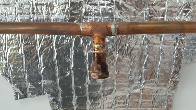

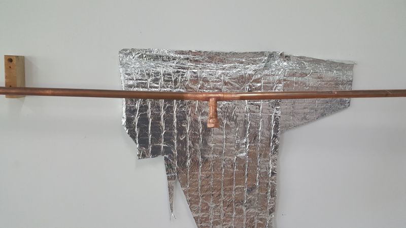

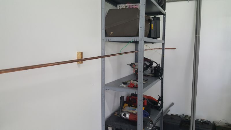

WOOHOO! Had a blast at Okteenerfest even if I was sweating my ass off helping with cars. Too bad mine couldn't make it. I don't know if I will make it next year but I am gonna try a bit harder to get there. I did start plumbing the airlines for the compressor system so when I get that done it will be a big help.
Nothing like sweating copper to remind you about heat control! I was nervous about soldering the pipes against the wall when I stepped over some left over heat mat for the MG and had the idea of tacking it up behind the joint I was soldering to protect the wall. Worked quite well! (IMG:style_emoticons/default/piratenanner.gif)
First two pics are of the pipes being prepped and readied for soldering.
(IMG:http://www.914world.com/bbs2/uploads_offsite/image.ibb.co-7987-1537652225.1.jpg)
(IMG:http://www.914world.com/bbs2/uploads_offsite/image.ibb.co-7987-1537652226.2.jpg)
Soldered "T" joint for the second drop.
(IMG:http://www.914world.com/bbs2/uploads_offsite/image.ibb.co-7987-1537652227.3.jpg)
One side wall completed.
(IMG:http://www.914world.com/bbs2/uploads_offsite/image.ibb.co-7987-1537652227.4.jpg)
This is the far side wall, I have a regulator and dual filter/dryer in place as the last drop will be for paint equipment hookup. I am working my way backwards from the last drop to the air compressor. The back wall will have three drops and is 50 feet long so will be a long run.
The wall with the compressor will only be one drop but there will be a leg that goes up to the ceiling where I will have a retractable hose and reel hooked up. That one should be fun. Once it is all together I will check for leaks and re-solder any joints that I didn't get done correctly. Fun, fun fun... (IMG:style_emoticons/default/blink.gif)
