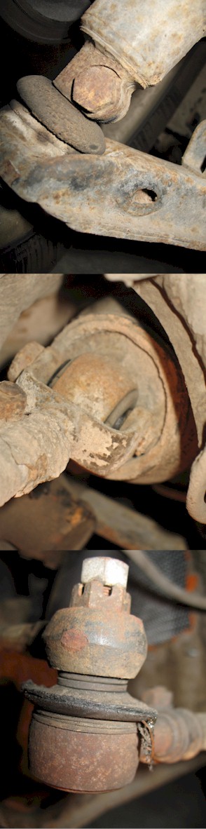

i see that the turbo tie rods look alot different than stock?
edit: pics of my front suspension - looks like I have a worn part or two (IMG:style_emoticons/default/smoke.gif) jim Attached thumbnail(s) ![]() |
