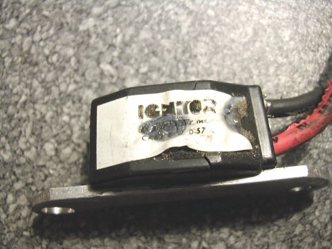

My engine is not starting, I have fuel but it seems no spark. Changed the ignitor back to points and still no luck.

Well changed back to points because the problem became obvious when I investigated properly. The ignitor was cooked.
