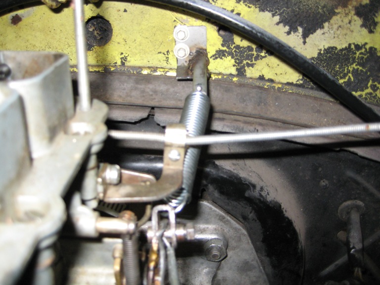

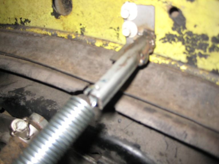

I made that little piece to accomodate the large spring. We have a store called Tractor Supply Company where I got them. I bought several in different lengths and stiffnesses before I go this one right, but I will tell you, my throttle snaps back.

He's got a single and you have duals. If you add a spring run one at the center of the linkage. If you run a spring at each carb you have to get the geometry the same on both. Otherwise the difference in spring pressure will tweak the linkage and your carbs will be out of sync.

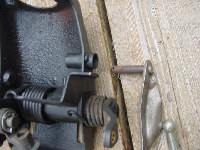

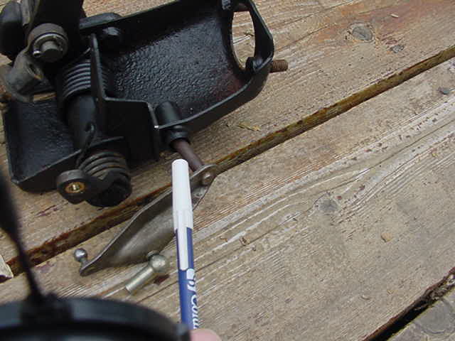

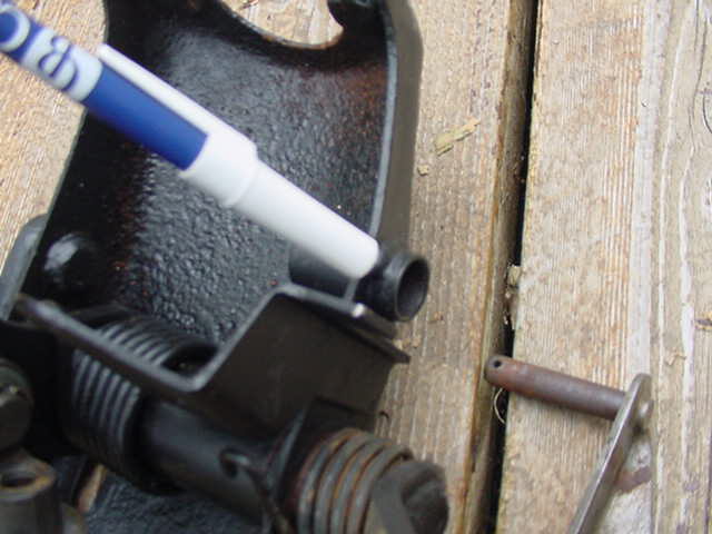

rhodyguy
post Jul 18 2008, 11:20 AM
Posts: 22,254
Joined: 2-March 03
From: Orion's Bell. The BELL!
Member No.: 378
(IMG:style_emoticons/default/agree.gif) x2 w/the cap'n on this one. the cable pivot piece has a shaft that inserts into the pictured tube in the the box assem. the pivot tube may still have the old plastic bushings (that have been removed on this box). the bushings wallow and the pivot shaft sits cockeyed and can feel bound up. i chased a slow to return to idle issue. bigger springs only made matters worse. i installed the 2 small bronze bushings that come in the bushing kit and the pivot was smooth as glass. you may note a loud sound while pushing on the pedle also.
