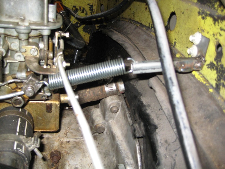

Spring on Carb is the only one. I had similar problem and had to get a heavy duty spring to accomplish the idle release that I wanted. If you want, I can take a picture of what I did.

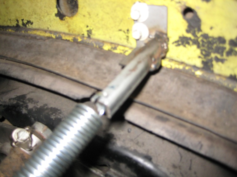

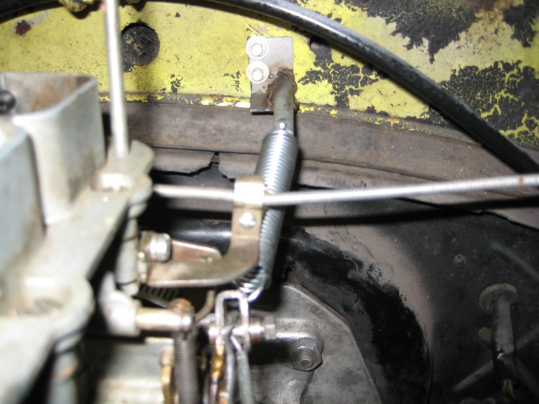

I made that little piece to accomodate the large spring. We have a store called Tractor Supply Company where I got them. I bought several in different lengths and stiffnesses before I go this one right, but I will tell you, my throttle snaps back.

Thanks for the pics. We have a TSC a few minutes from my house. I will head up there this weekend and rig something up.

He's got a single and you have duals. If you add a spring run one at the center of the linkage. If you run a spring at each carb you have to get the geometry the same on both. Otherwise the difference in spring pressure will tweak the linkage and your carbs will be out of sync.

Too much spring can be worse, for the car, than no spring at all. Before you spend the money, check the pedal bushings and the cable itself. The Cap'n

x2 w/the cap'n on this one. the cable pivot piece has a shaft that inserts into the pictured tube in the the box assem. the pivot tube may still have the old plastic bushings (that have been removed on this box). the bushings wallow and the pivot shaft sits cockeyed and can feel bound up. i chased a slow to return to idle issue. bigger springs only made matters worse. i installed the 2 small bronze bushings that come in the bushing kit and the pivot was smooth as glass. you may note a loud sound while pushing on the pedle also.
