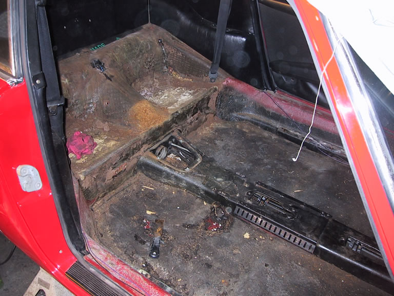

Well...have a couple of days scrapping away at the interior of my car, I have completely removed all the factory tar paper and sound deadening. Now I have to start stripping the paint out and grinding away the seam sealer.
I know that Brad thinks highly of this procedure to both 911 chassis and 914 chassis and after doing this I would have to agree. I thought I had a rust free tub, but I was mistaken...I found some areas of surface rust in the corners of rear deck and some on the floor boards. I also straightened out the floorboards from people jacking the car up incorrectly. Its getting there.
For the weight freaks here...all the tar paper and sound deadening stuff weighed 30 lbs!!
-Britain

Jeff Bonanno   sheesh! :o heat gun or dry ice?   Jan 29 2004, 05:47 PM
redshift   Heat! Brit, man... where is the damned firewa...   Jan 29 2004, 05:53 PM
Britain Smith   LOL! That is the damn firewall...I am blessed...   Jan 29 2004, 05:58 PM
redshift   It looks prosthetic. Robo-Strip. If you hit it wi...   Jan 29 2004, 06:17 PM
Gint   Brake cleaner will take the leftover tar right off...   Jan 29 2004, 08:07 PM
redshift   :lol: He's right, take care not to start a f...   Jan 29 2004, 08:12 PM
