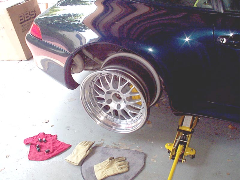

By the way, nice mechanic ...

yeah...nice mechanic

QUOTE(acox914 @ Jan 31 2004, 03:04 PM)

P.S. Nice mechanic. Good to see someone take care to prevent their clothing from scratching the paint.

nice mechanic
Uh huh... (IMG:style_emoticons/default/agree.gif) Can you send her over when she's done? I need some front end work done.
I won't get in the way...I'll just stand behind and... watch, yeah that's it... watch.

Dont know where the avatar/mechanic photo came from, wish i did though!
