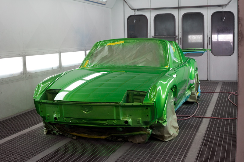

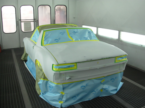

Made it back from a trip to the paint booth. Everything went according to the plan, so I'm very happy (IMG:style_emoticons/default/biggrin.gif)
Took off Friday morning, headed to Twin Falls which is about 2 hrs away.
I had some help from some very talented guys. Huge thanks to my brother-in-law Chris and my friend Jake!

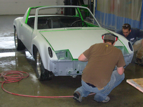

After making the final preparations we masked it up and moved to the booth.
sawtooth
post May 8 2011, 12:10 AM
Post #211
Posts: 297
Joined: 25-June 08
From: Boise, ID
Member No.: 9,211

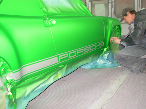

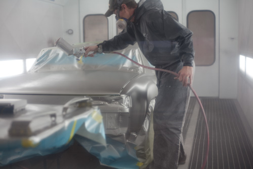

First base layer going down...

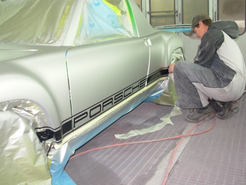

Using the first base layer as the color for the side stripe.

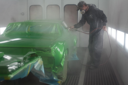

Second base layer...
Decal/stencil being removed...

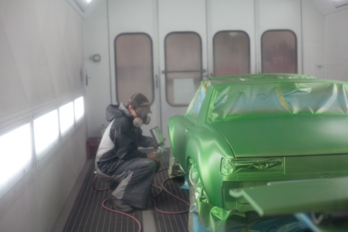

And after baking in the booth to cure out the base layers a bit, the final clear coat (IMG:style_emoticons/default/happy11.gif)

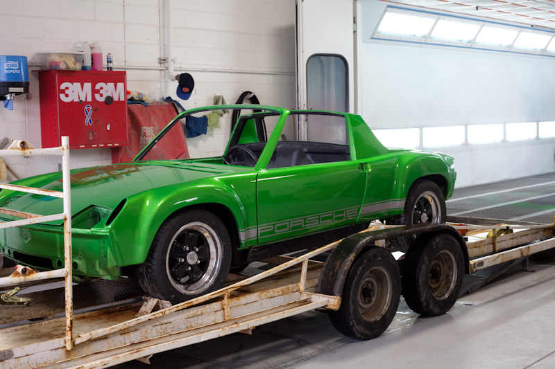

Left it to bake in the oven over night...
Unwrapped, and headed back home the next morning.

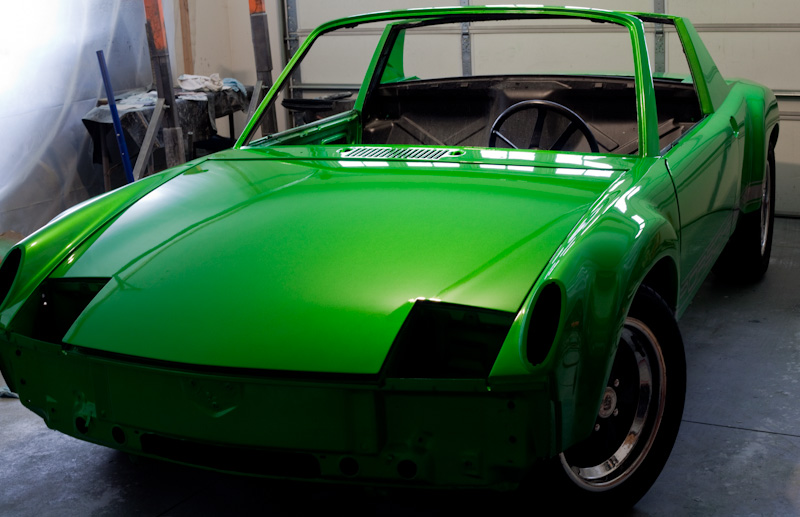

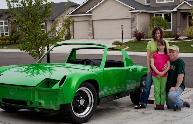

Back home again, me and my girls (IMG:style_emoticons/default/smile.gif) Everyone happened to be wearing green just for the occasion! It's ironic, I remember when I first started this project I wanted to paint the car anything but green. Now I can't imagine any other color (granted it is a bit different than Zambezi). Funny how things change.
And she's back in the barn ready to be re-assembled.
