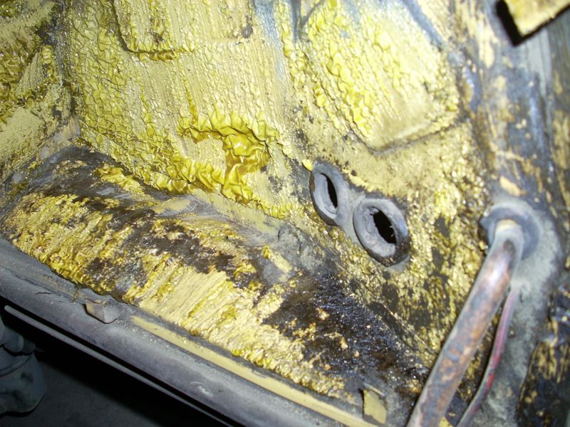

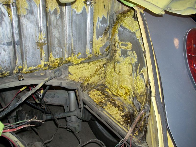

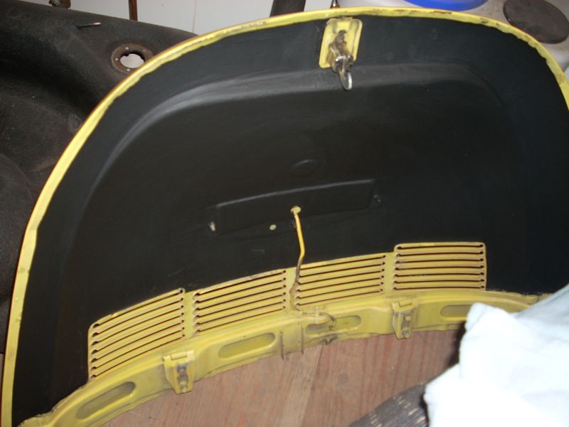

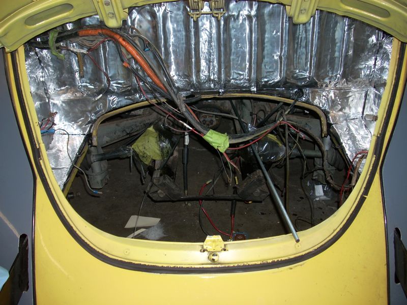

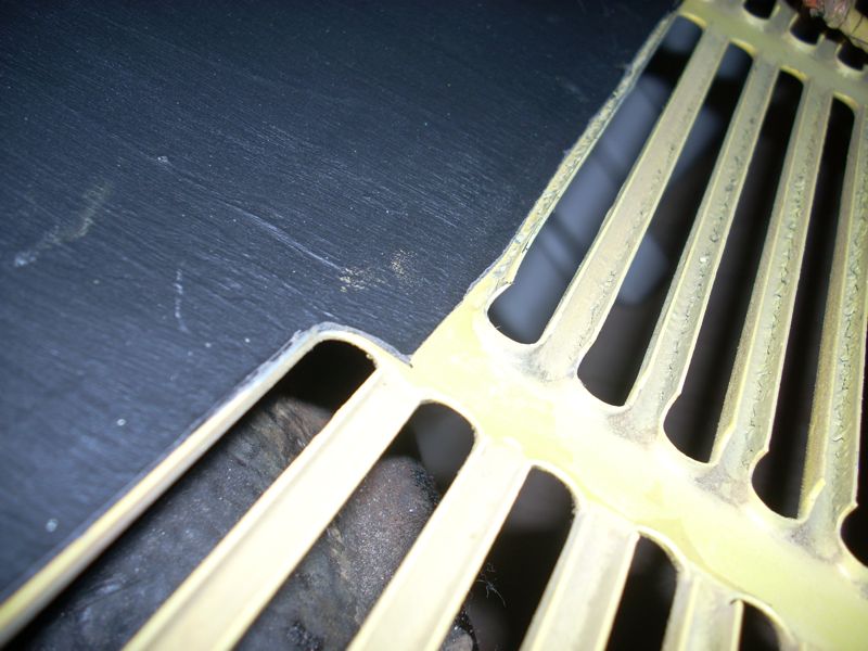

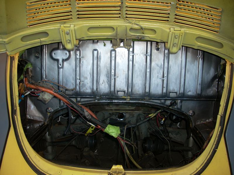

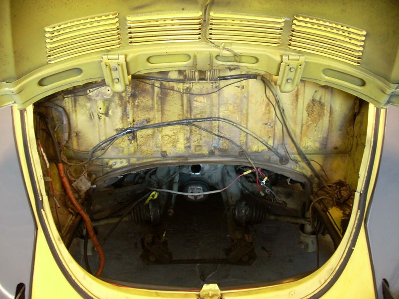

Gint, it dries hard. It's cleanable and should give suitable moisture protection in most cars (not rally cars (IMG:style_emoticons/default/cool.gif) ).
Here's the sound proofing work. Stripped the paint using aircraft stripper ((IMG:style_emoticons/default/smilie_pokal.gif)). I used POR-15 as directed (metal ready, marine clean) over the bare metal. Then Damplifier Pro (2 layers) and over the top will come Luxury Liner Pro. Spectrum goes on the engine lid.
