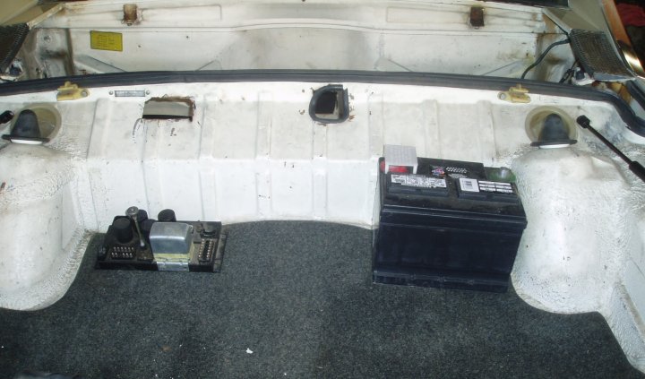

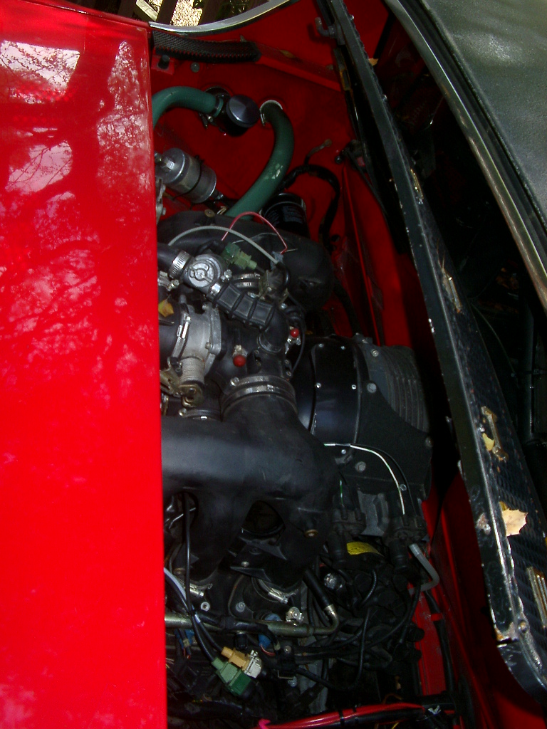

I'm thinking about relocating my battery and the main circuit card to my rear trunk. Why? Because this is a /6 and it's kind of a pain having the oil filter under the circuit card. Also I want to try and make the engine compartment look a whole lot cleaner. I am a very competent wiring guy so extending the harness is no big deal. Just wondering if anybody else has ever done this.

I got rid of my relay board all together ...
Really no need for it if you have a Alternator with the Voltage Regulator build in. The fuel pump is relocated to the front, so no relay needed for that in the back either ... (IMG:style_emoticons/default/smash.gif) Andy Attached thumbnail(s) ![]() |

Steve .... the alternator in that car is externally regulated hence the use of the relay board for ease. You can eliminate the relay board by wiring direct to the voltage regulator and the 14 pin main body harness.
Going to an internally regulated alternator is expensive. Requires new alterntor and a new tail cone on the alt/fan housing. Also, the relay for the fuel pump was negated. Power for the fuel pump does come from a relay housing that has the guts "removed" and power is hardwired thru the relay assembly. |
