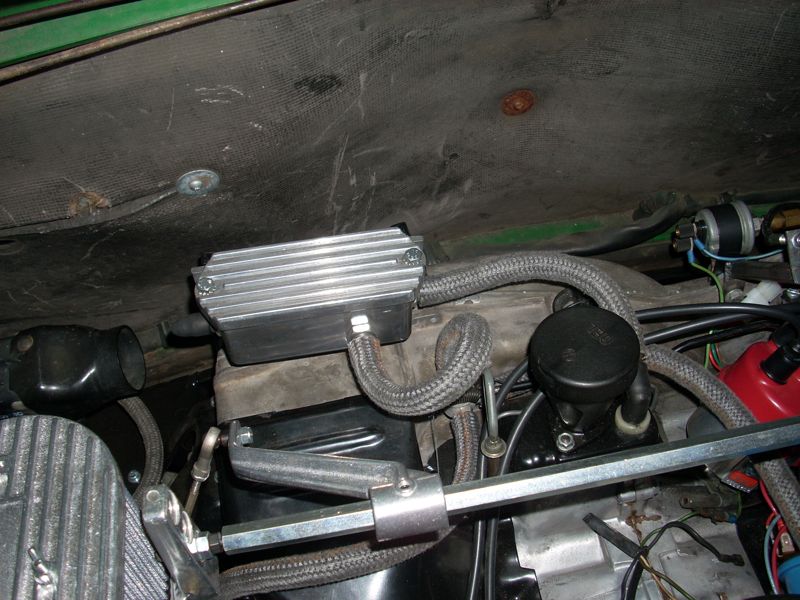

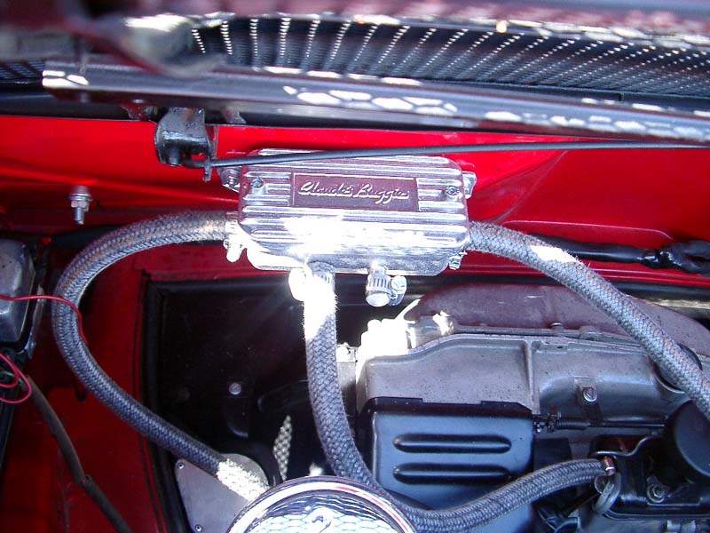

It seems to spray a little bit of oil while I'm driving. It might just mist oil but it's enough that I smell it when I stop and get out of the car. I can see that there is a little slick spot on the engine right below the hole. Is there supposed to be somethiing that covers the hole? You might need to know I have a single carb and fuel injection stuff has been removed if that has anything to do with it.
angerosa Breather hole just below oil fill cap? Aug 24 2008, 09:45 PM
r_towle well, if you have head breather hoses, those may s... Aug 24 2008, 09:51 PM
McMark Standard 'VW' breather filter mounted on t... Aug 24 2008, 10:22 PM
SirAndy :DRUNK: Aug 25 2008, 12:23 AM
angerosa Thanks guys - just what I needed to know. I though... Aug 25 2008, 08:52 AM![]() ![]() |
