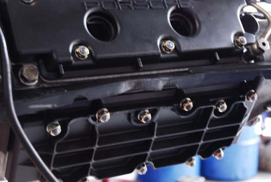

It is easy to do but Mike is right. If you have the turbo covers on you will need to grind some down. This picture is off my old engine but you can see where you need to remove material and then they come out just fine.

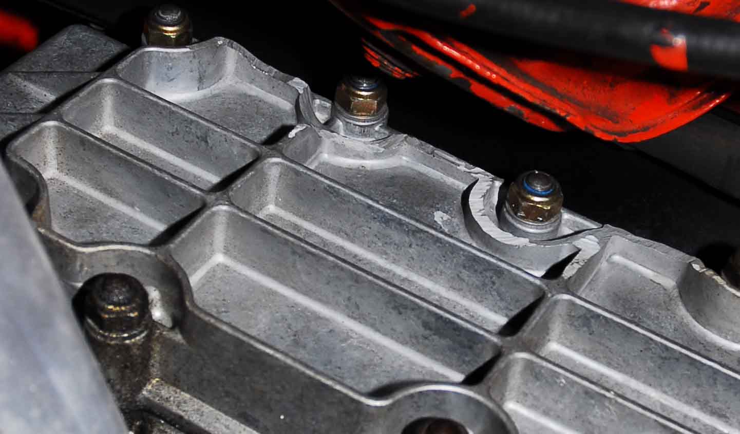

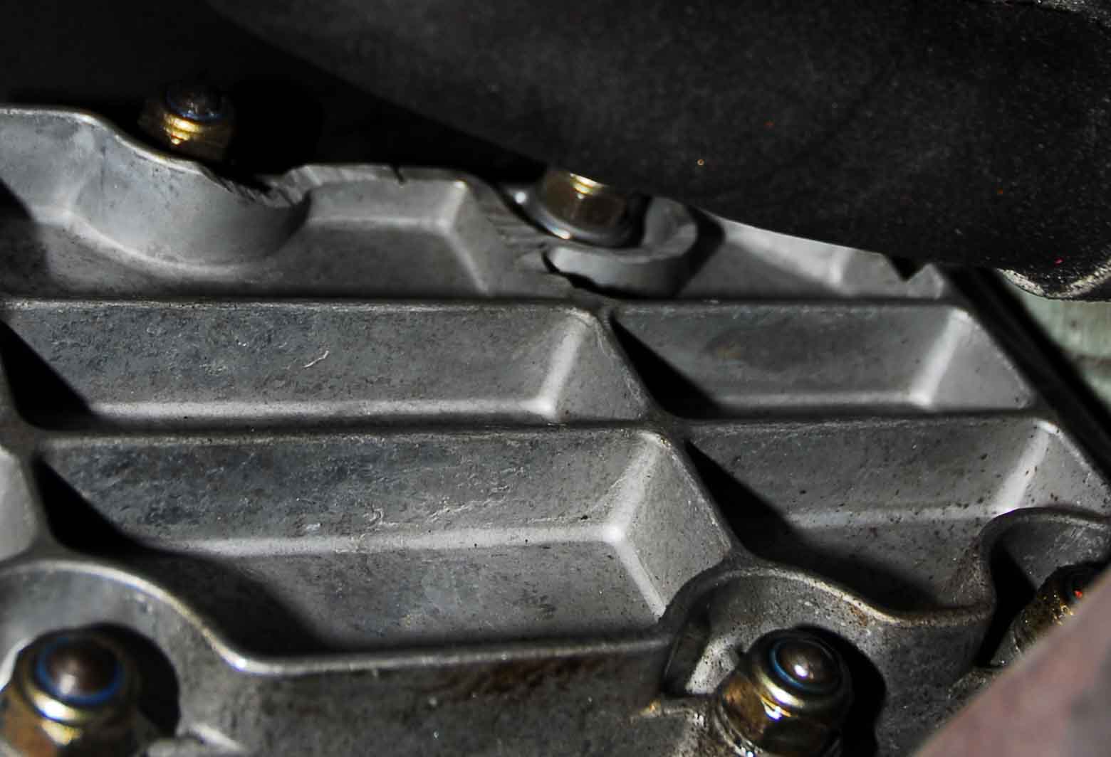

Here is one from my engine when I had it out. You can see where I did some grinding to avoid the dog ears.

Those pics do show some nice detail of removal of some material from the lower valve covers. (are both sides done the same?)
Now they DO come out with that amount of material removed? (I'm still a slightly doubting Thomas) I could probably do that with a HF dremel tool and a carbide bit in slightly less time than dropping the engine (and I would save 11 quarts of oil).

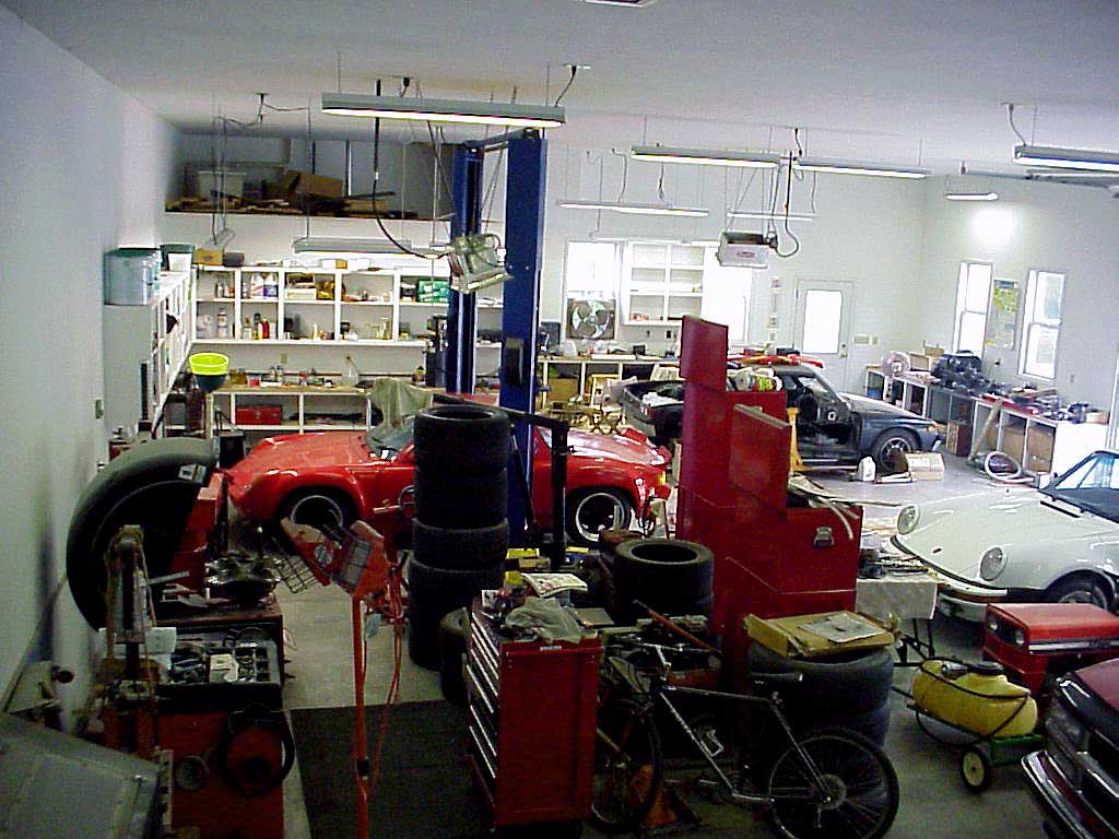

My old Garage:

No, you will need to take different amounts off each one. I lowered my engine just enough to get the covers off the first time. Then I looked at where material needed to come off. Traced areas with a sharpie. removed the material and they went right in. I removed them three times since without needing to do anything else to the engine.
