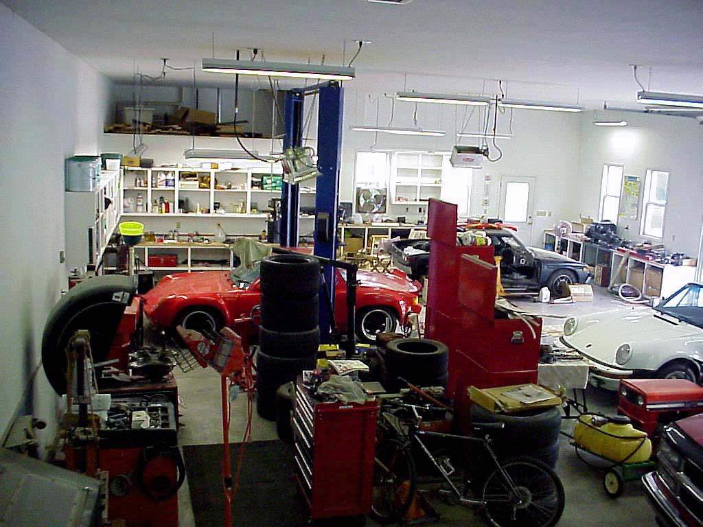

My old Garage:

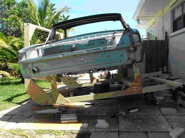

Here is my garage. It has very good headroom and ventilation. It is also
subject to flooding and mosquito swarms.
I did not want any practical considerations getting in the way of my obsession.
