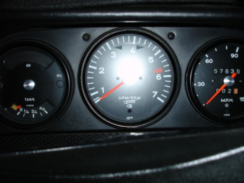

i've always thought the 150 mph speedo was put in my 73 1.7 somewhere before me. i was looking at a link showing the correct guages. it said the 150mph came out in the 2.0 std. it was unclear weither the 1.7 with the appearance package had it. not avalible in 70 - 72. in 73 had silver button. in 74, no button and was know as black face. (IMG:style_emoticons/default/confused24.gif)
http://www.p914.com/p914_gauges_speedos.htm
how do i know if my car has apperance package? i've always expected it does. the console appears to be factory except the guage face is obviously modified and the other thing is the heater lever is straight non curved but the opening has bigger opening to fit the lever (factory looking not cut). all the others i've seen are a slot for the lever. it's from the first 1000 group pulled from europeon sales that came with oddities. could this be why? the car has been fairly unmolested over the years.

73 dealer service and info guide shows that the 150 speedometer was made standard.

Looks like the fuel/combi gauge has the parking brake light at the top instead of a temp gauge, so I'd guess that the car was made with the appearance group--temp gauge would have been in the console.

The 1.7s and 1.8s that did not have center consoles did not have temp gauges. So the big red brake light is not really an indicator...
Let's see. Rollbar vinyl, chrome bumpers, center console, fog lights. I think those were all part of the "appearance group".
--DD

My 73 non appearance package 1.7 has the 150 speedo

My early 74 also has a 150 silver button AWA the rest of the gauges.

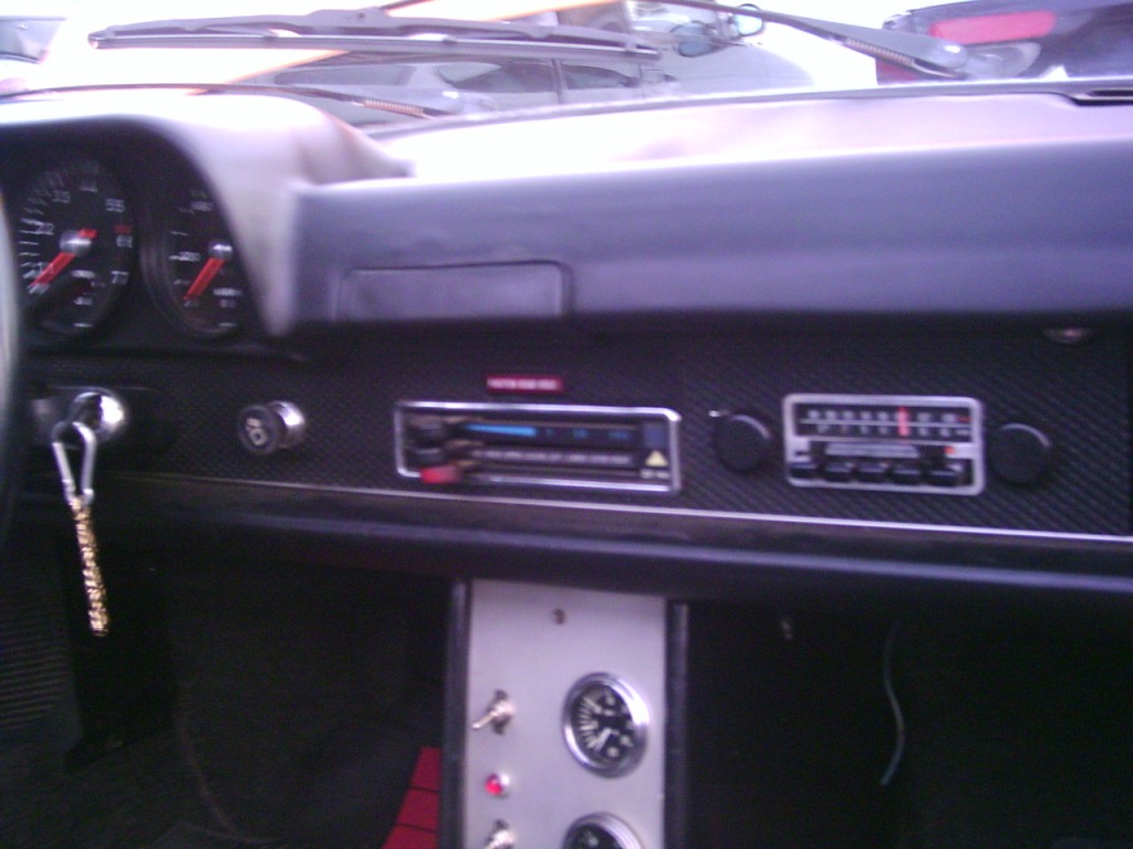

roll bar vinyll? didnt they all have vinyl?
ever see this console face? what about the factory looking open area (not a slot) for a non console heat lever? it was a very early 73 (first full consoles). ya hink thats why?
Rollbar vinyl, chrome bumpers, center console, fog lights... check... is there any numbers somewhere indicating this option?

70-72 914-4 silver button 120mph
70-72 914-6 silver button 150mph
73-early 74 silver button 150mph
74.5-76 black button 150mph
alert alert: Some 76 models when they started to run out of instruments had fitted silver dial 150 mph along with matching tach and fuel gauge

heres a clip from previously noted gauge guide information site... my question is what am i looking for in "slightly modified fuel gauge"?
" The 1973 model year heralded the introduction of the 2.0L engine, and with it a 150 MPH speedometer. Additionally, the fuel level / oil temperature combination gauge was introduced on 2.0L vehicles ordered without the optional "Appearance Group." For cars with the "Appearance Group," and slightly modified fuel gauge was used. "

LOOKING AT THE SITE YOU LINKED TO, IT SEEMS THIS IS EASY. THE PART NUMBER IS ON THE FACE OF EACH GUAGE, TOP CENTER. THERE ARE -10, -20, -40 AN -50 GUAGES AVAILABLE. JUST LOOK AT THAT AND VIOLA!

The fuel gauge used in 1973 1.7L cars and 2.0L cars with the three-gauge console is part number 914 641 102 40 (pictured above). The 'modification" I was referring to was merely the centering of the hand brake symbol from the prior iteration of the gauge, part number 914 641 102 20. Anyway, from the pics, your dash gauges look correct and original for a 1973 1.7L.
