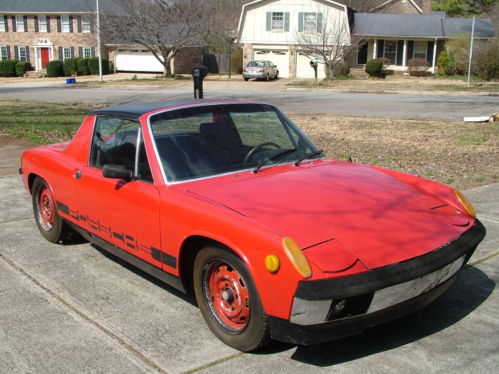

QUOTE(schreiber @ Aug 29 2008, 11:13 AM) *
I hope to take this car back to a factory original look...
Your passenger side turn signal lense is upside down. (IMG:style_emoticons/default/biggrin.gif)

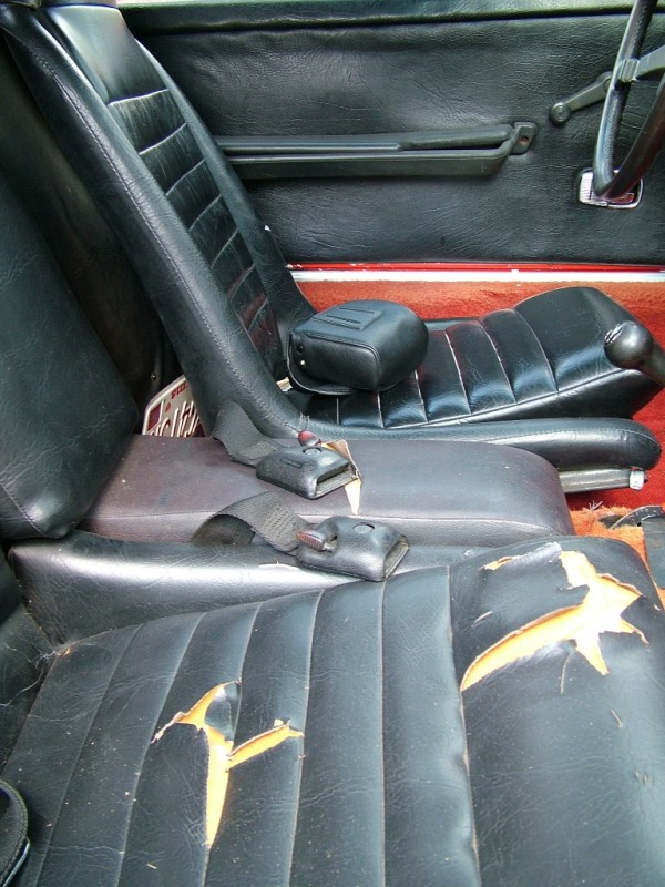

I have never seen seat belts like those before

QUOTE(ruddyboys @ Aug 29 2008, 02:32 PM) *
Stock early non retractable seatbelts ...

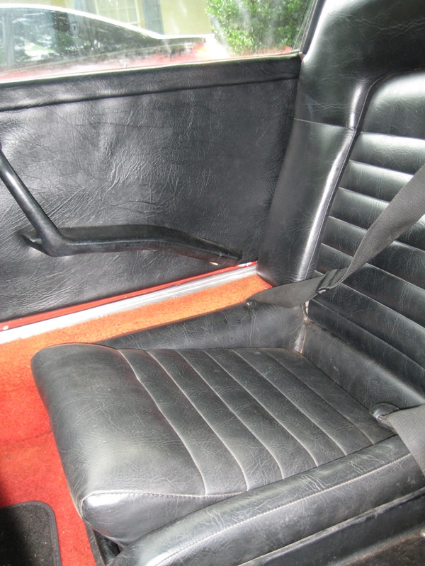

Made some good progress this weekend! I replaced my passenger side door latch (no more only opening that one from the inside)... And also replaced that beat up passenger side seat.

Your passenger side turn signal lens is upside down. (IMG:style_emoticons/default/biggrin.gif)
Looks like a nice project!
(IMG:style_emoticons/default/smilie_pokal.gif) Andy
I'm gonna blame the turn signal thing on a PO. (IMG:style_emoticons/default/smile.gif) That is remedied.

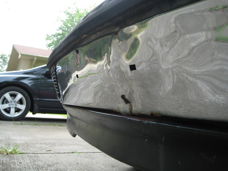

QUOTE(rmital @ Aug 29 2008, 03:14 PM) *
QUOTE(schreiber @ Aug 29 2008, 03:15 PM) *
Big glaring things to work on in the future:
-New front bumper
(IMG:style_emoticons/default/huh.gif) from the pic above, the front bumper looks pretty clean!
Unfortunately, the bumper looks worse in person...

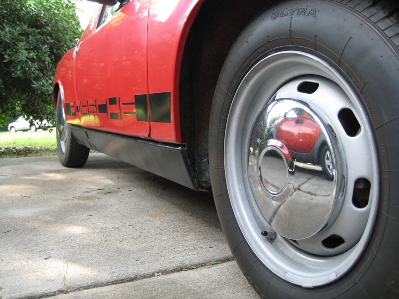

Updated shot of the wheels
Cleaner seat

Those side mirrors look like the plastic kind...if they are they suck and I suggest replacing with OEM style mirror(s). My plastic mirrors never stayed put with a head wind and eventually broke off when I hit freeway speed, D'Oh!
The wheels look great (IMG:style_emoticons/default/beerchug.gif)

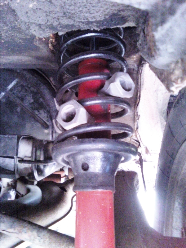

Ok 914 world, I need some help. I'm under the car today, fiddling with things, and can't determine what these spacers? are... I speculate it was something done by a previous owner. See picture.

Those are cheesey spacers to make up for sagging springs. I'd yank them out. They also make the spring feel stiffer. If the spring is shot or not stiff enough I'd buy a new spring.
Wilhelm
post Oct 11 2008, 12:08 PM
Posts: 408
Joined: 7-September 07
From: Hooterville, OR
Member No.: 8,088
Those would be the JC Whitney style spring spacers. The rear attitude of the car was likely "draggin' ass" and the PO wedged these into the springs to heighten the rear. Ya need new springs. (Edit: jmill beat me to the punch)

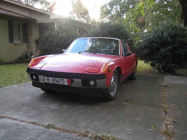

On another note, I got my temp European plate put on. Like it? Loathe it? (IMG:style_emoticons/default/biggrin.gif)
