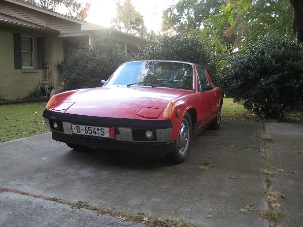

Greetings all! I guess this will serve as a central introduction/ build/ update thread for my teener. A little about me: I've been a member of the site for a year or so. I'm a full time student, work full time as a networks administrator, and am a member of the Marine Corps reserve.
I hope to take this car back to a factory original look... Not down to the last bolt, but given the choice, I'll probably choose the factory look. I've really enjoyed reading the enthusiasm of Pat Garvey and crew in the 'Originality & History' section.
Finally, the 914 is and will be a learning experience for me. I'll admit I have a lot to learn, but I've enjoyed playing around with it so far.
..Also want to give a shoutout to my neighbor, Scott (SGB). He has a beautiful 914, and has been an inspiration with regards to the car. I can only hope I get mine looking like his some day.
Mine:
More pictures to follow!

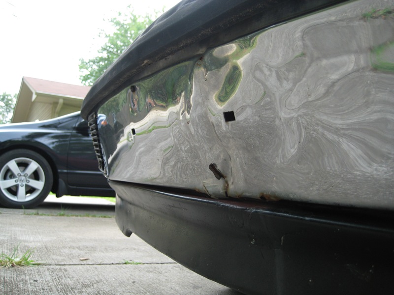

Big glaring things to work on in the future:
-New front bumper
huh.gif from the pic above, the front bumper looks pretty clean!

-New front bumper
Unfortunately, the bumper looks worse in person...

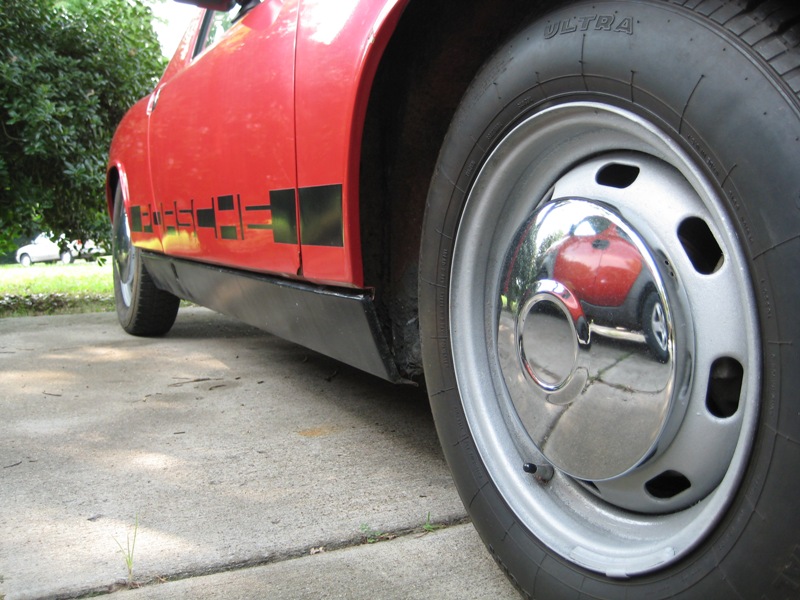

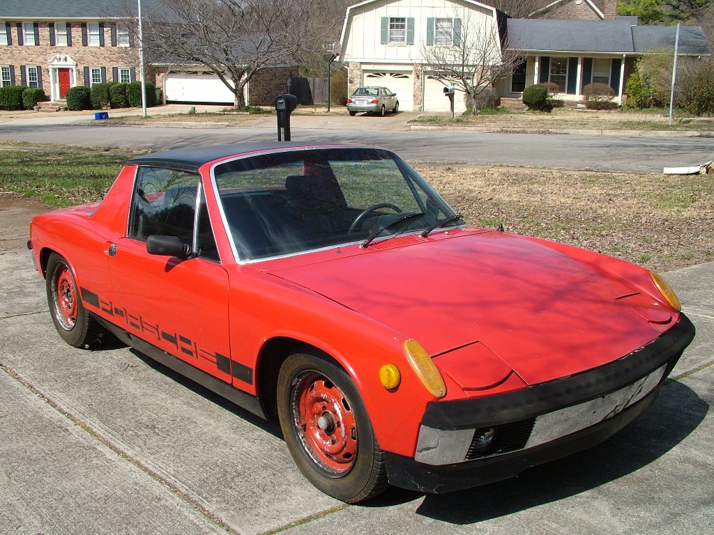

Updated shot of the wheels

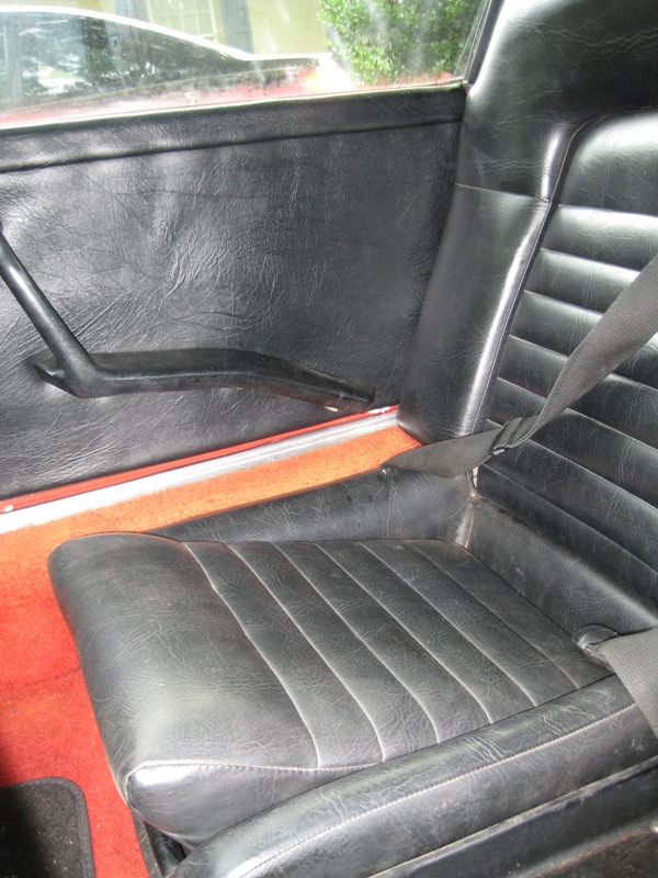

Cleaner seat
plymouth37
Looks like you are well on your way to a great clean car.
Nice work!
Chris Pincetich
Those side mirrors look like the plastic kind...if they are they suck and I suggest replacing with OEM style mirror(s). My plastic mirrors never stayed put with a head wind and eventually broke off when I hit freeway speed, D'Oh!

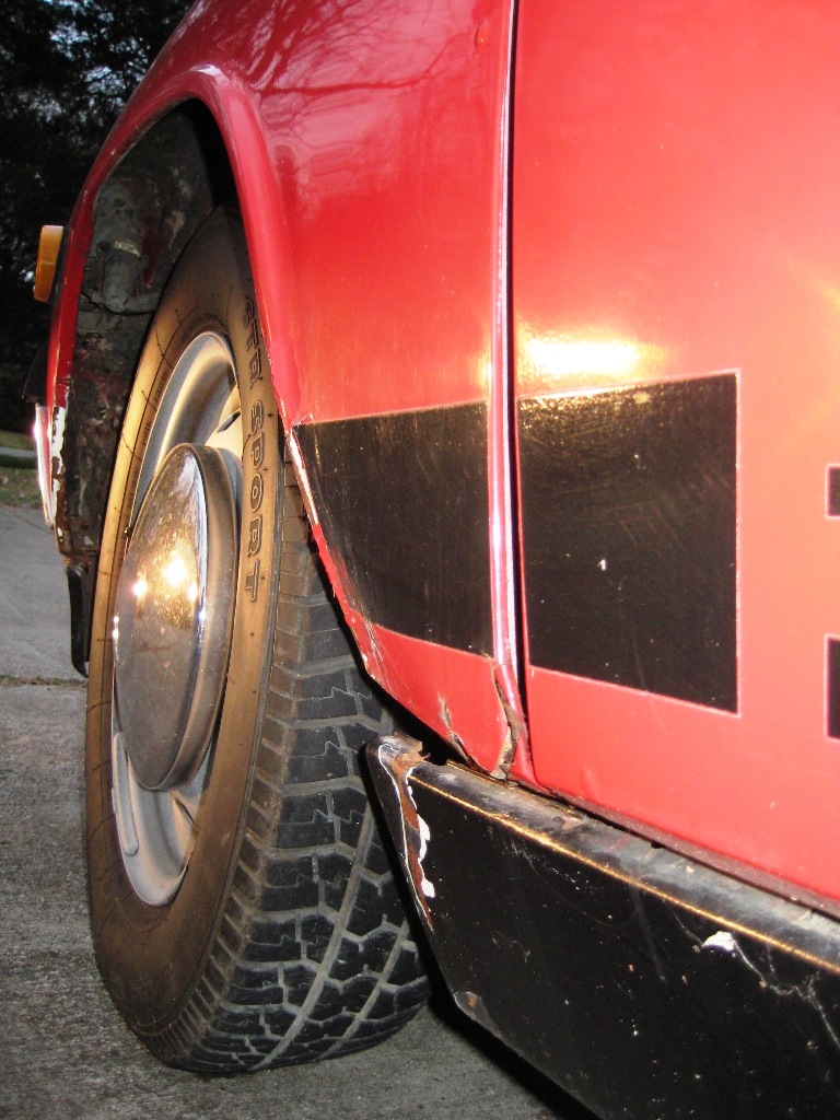

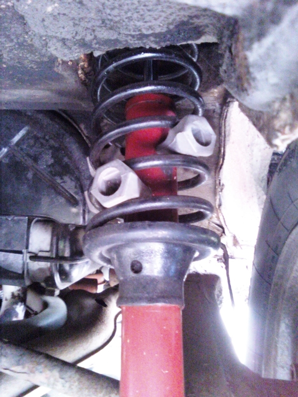

Ok 914 world, I need some help. I'm under the car today, fiddling with things, and can't determine what these spacers? are... I speculate it was something done by a previous owner. See picture.
jmill
Those are cheesey spacers to make up for sagging springs. I'd yank them out. They also make the spring feel stiffer. If the spring is shot or not stiff enough I'd buy a new spring.
Wilhelm
Those would be the JC Whitney style spring spacers. The rear attitude of the car was likely "draggin' ass" and the PO wedged these into the springs to heighten the rear. Ya need new springs. (Edit: jmill beat me to the punch)

Aright. Thanks for the help!

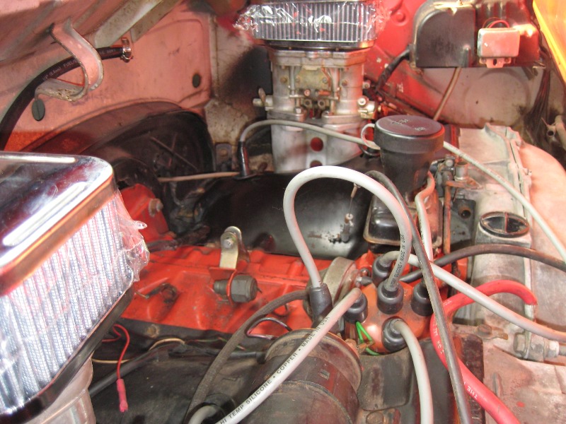

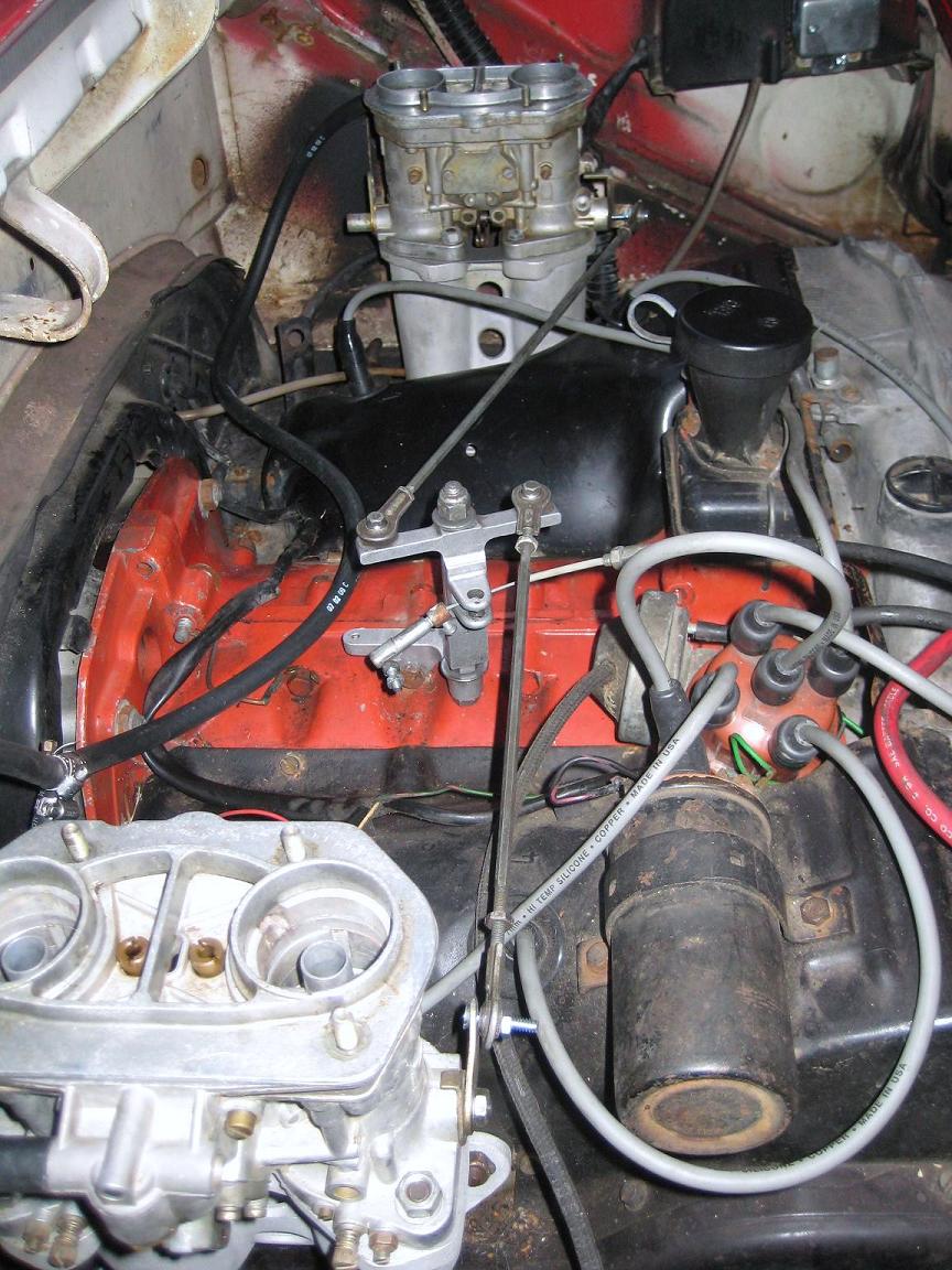

My latest focus has been on removing the Weber progressive 32/36, and hooking up the Weber 40's. As of today, I finally have them in there, but am second-guessing the gas line hookup. I'm also not to clear on the necessity of some of the other lines. Finally, I'll need to figure out how to hook up the linkage and throttle cable bracket. Pics are related.
Engine bay looking different with the dual Webers

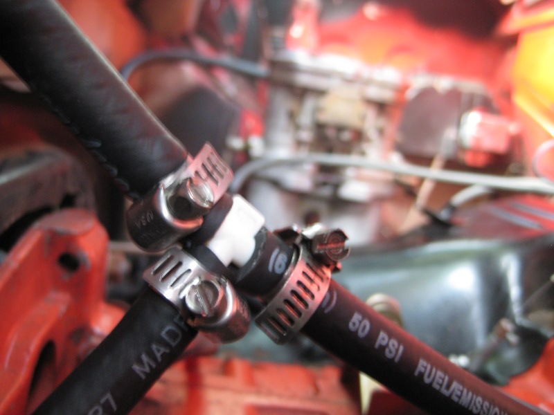

/bootleg/ fuel tee
jmill
Lose that plastic tee. Plastic bakes and cracks then you burn your car down.

QUOTE(jmill @ Aug 14 2009, 11:11 PM) *
I guess I should get something more like this ?
Katmanken
Yup.
Metal is good.

Plastic tee replaced with better metal tee. Also have the throttle cable linkage stuff in. Everything I've read here that said tweaking it is a headache is right on. I'm afraid it is gonna be a headache.
You guys think this looks right?
CliffBraun
Not the linkage I have in my car, so I can't tell. The two basic things to test are if you've got the carbs opening at the same time (turn the linkage just a tiny bit in the middle, verify that carbs open at the same time) and if they're the same at wide open, which is a pretty obvious test
if those two are ok you're probably fine, but it wouldn't hurt to check that the plates are open the same in the middle of the range.
schreiber
think everything is in place. only problem now is the gas pedal not wanting to return. i'll fiddle with things more this weekend; i don't think my throttle cable is quite right.

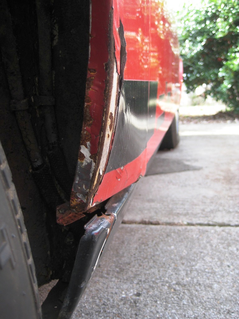

Did you ever figure out the camber issue? Make sure one of your suspension ears isn't rusting through.
Pick of one that did:
Cracked suspension ear
schreiber
Feeling discouraged. sad.gif After working on the car last night, I had changed plugs, plug wires, and hooked up the new battery. Moment of truth - and it turned over! Good. First time I've heard it turn over in a while. Start pumping the gas to try to get it running, and pedal goes all the way to the floor, does not return. My throttle cable came loose from the bellcrank linkage. Upon further inspection of the floorboard area, I look and see that the pedal board is totally shot. (This was one thing I thought I could get away with not replacing.) Gah! One thing leads to another.
I'll take a look at this next time I have it up on jacks.

QUOTE(schreiber @ Aug 28 2009, 10:52 AM) *
Your linkage is all f'ed up, the arms should be 90 degrees from the throttle shaft.
In this pic you're getting closer than the first pic but still not quite right. Flip your arms in the center see if that helps. The cable must be straight and true, any kinks and it won't work right. You will need a light spring on the center pull.
Man that center looks bent.....and how it bolts to the case is cheesy.....
agree.gif That center pivot mount is a pending disaster. You need to make one that mounts on two bolts or it will just tip over. The flat bar cable mount will flex and the hiem joint linkage is crossed up. Also the bolt sticking up on the end of that cable is going to hook onto the heim linkage as it passes over the cable end and hold the throttle open.

Many thanks to pilothyer, he came over this weekend and helped me work on the car. Got the linkage correct, got it running, and even drove it around a bit.
