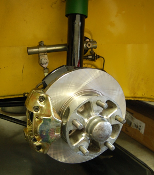

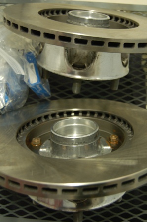

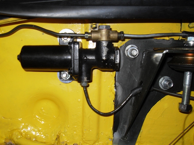

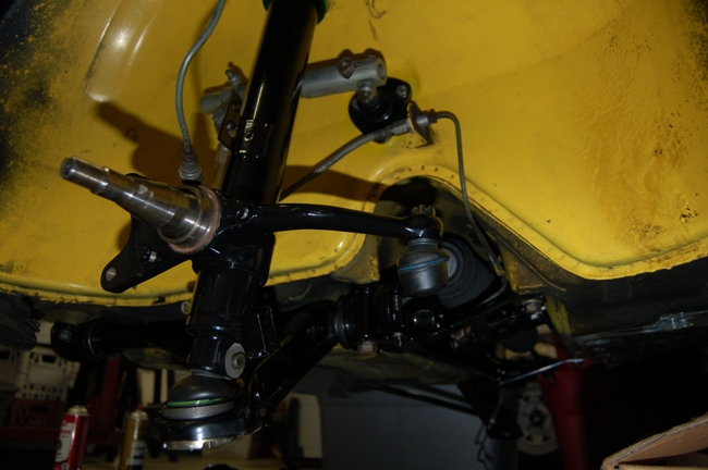

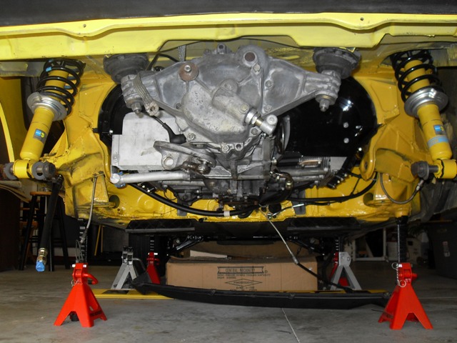

bcheney   Pics of refurbished suspension, M-Front calipers (...   Sep 21 2008, 05:50 PM
bcheney   Pics of refurbished suspension, M-Front calipers (...   Sep 21 2008, 05:51 PM

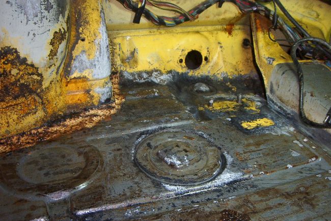

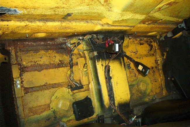

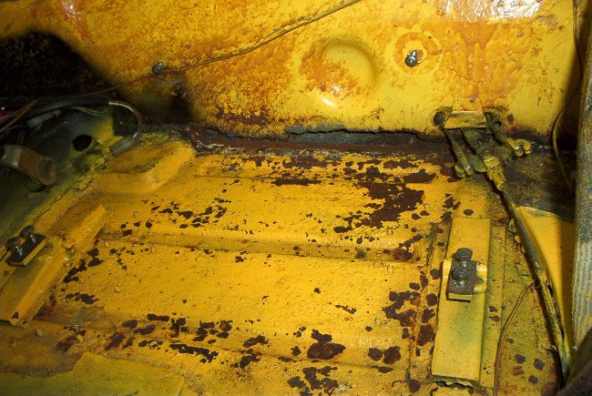

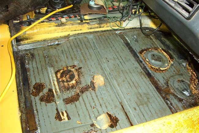

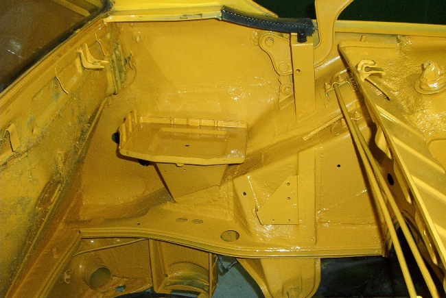

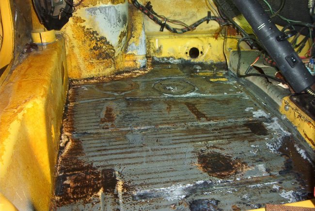

bcheney   Here are some BEFORE pics of the rust issues...Bat...   Sep 21 2008, 06:03 PM
bcheney   More BEFORE   Sep 21 2008, 07:49 PM
bcheney   AFTER...   Sep 21 2008, 07:50 PM

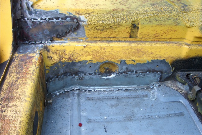

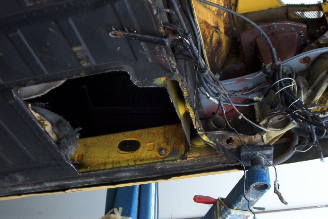

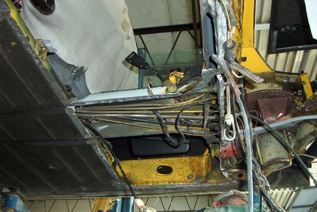

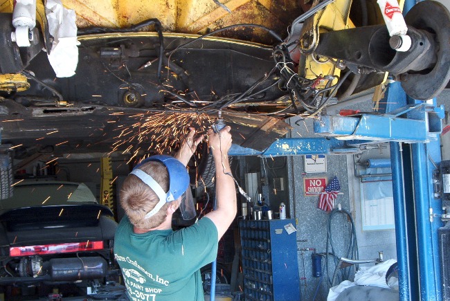

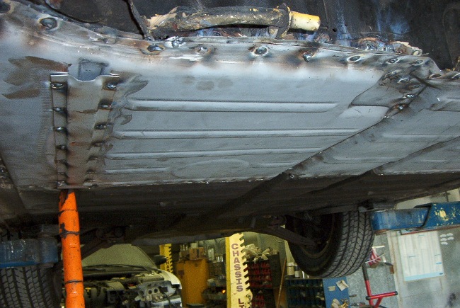

bcheney   Now how bout a new rear floor...first some BEFORE ...   Sep 21 2008, 07:54 PM
bcheney   Let's cut that bad floor out!   Sep 21 2008, 07:57 PM
bcheney   Big escape hatch!!   Sep 21 2008, 07:58 PM

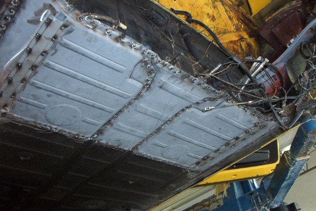

bcheney   Time to close the gaps...   Sep 21 2008, 08:04 PM
bcheney   Here is how it turned out on the interior side..   Sep 21 2008, 08:06 PM
bcheney   continued..   Sep 21 2008, 08:07 PM

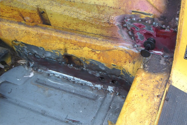

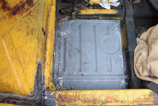

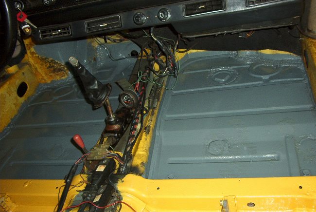

bcheney   The front floors were not as bad as the rear...sur...   Sep 21 2008, 08:19 PM
bcheney   The front floors were not as bad as the rear...sur...   Sep 21 2008, 08:20 PM

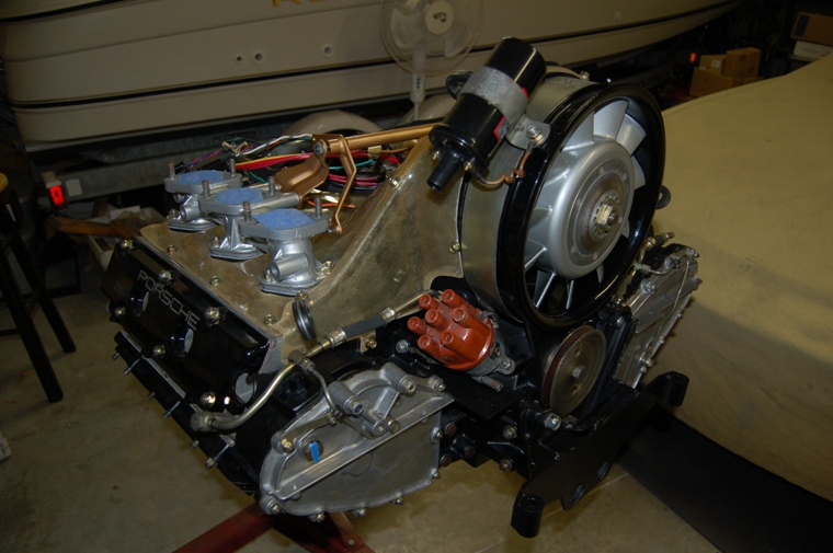

Justinp71   Nice Work! What size motor are you going with...   Sep 21 2008, 11:00 PM
bcheney   Just a freshly re-built 2.2 with E-cams and Webers...   Sep 22 2008, 04:32 AM

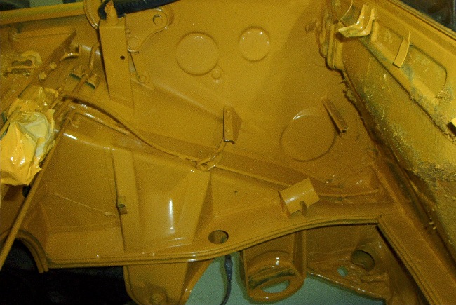

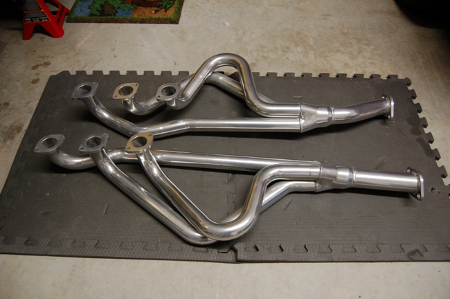

bcheney   Well I got my 6 headers back from JET-HOT this pas...   Oct 5 2008, 07:05 PM
bcheney   Had some time this afternoon...So, I installed the...   Oct 5 2008, 07:08 PM

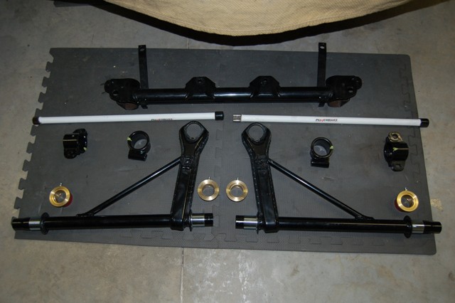

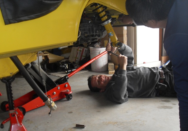

bcheney   Today I got both control arms installed with the E...   Dec 28 2009, 08:24 PM
campbellcj   Looking good! I know how it is to have these ...   Dec 29 2009, 12:23 AM
rfuerst911sc   Brian if you're not careful you might finish y...   Dec 29 2009, 05:52 AM
bcheney   More progress today... I got the the front hubs, b...   Dec 29 2009, 04:47 PM

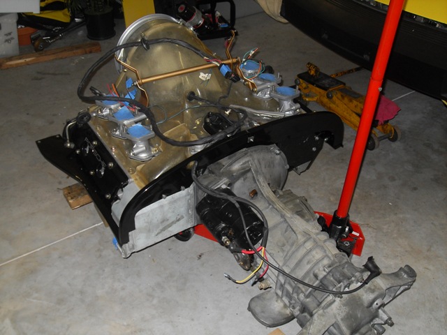

bcheney   Ok... thanks to words of encouragement from Eric S...   Oct 25 2010, 05:26 PM

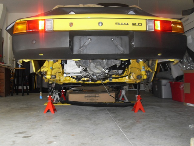

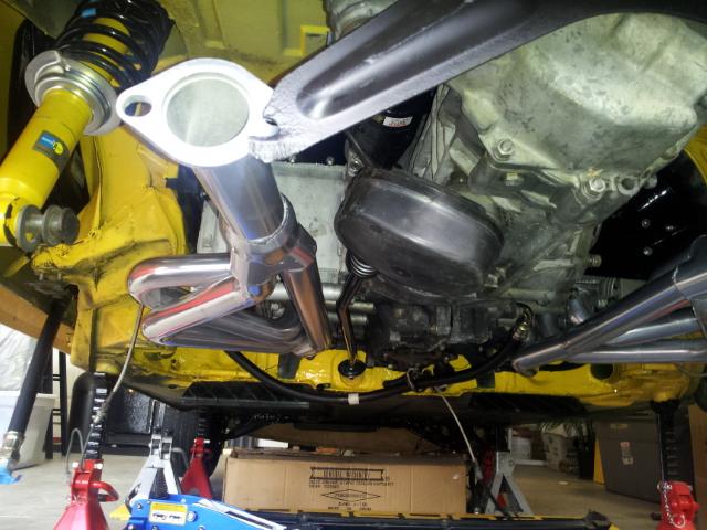

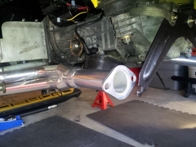

bcheney   Making progress...Here is the next issue. I mocked...   Jan 25 2012, 04:45 PM
mepstein   I would make a new hanger to fit. A flat plate of ...   Jan 25 2012, 04:54 PM
bcheney   I thought about modifying the existing hanger as w...   Jan 25 2012, 05:00 PM
Series9   I thought about modifying the existing hanger as ...   Jan 27 2012, 08:23 AM
rfuerst911sc   Bend the bracket back so it's touching the hea...   Jan 25 2012, 04:59 PM
bcheney   Bend the bracket back so it's touching the he...   Jan 25 2012, 05:04 PM
kconway   Why don't you use a GT hanger that grabs the m...   Jan 25 2012, 05:20 PM
bcheney   I'm not familiar with this type of hanger. Whe...   Jan 25 2012, 06:03 PM
kconway   I'm not familiar with this type of hanger. Wh...   Jan 25 2012, 07:46 PM

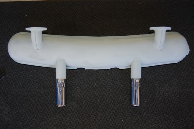

URY914   What are you going to use for a muffler?   Jan 25 2012, 06:31 PM
AZ914   What are you going to use for a muffler? I...   Jan 25 2012, 06:50 PM
bcheney   What are you going to use for a muffler? I...   Jan 25 2012, 07:12 PM
Series9   What are you going to use for a muffler? I...   Jan 27 2012, 08:29 AM
AZ914   [quote name='AZ914' post='1611750' date='Jan 25 2...   Jan 27 2012, 09:02 AM
bcheney   [quote name='URY914' post='1611728...   Feb 22 2012, 06:06 AM
AZ914   Maybe a dumb question but is your hanger square to...   Jan 25 2012, 06:48 PM
bcheney   Maybe a dumb question but is your hanger square t...   Jan 25 2012, 07:15 PM
carr914   [quote name='URY914' post='1611728...   Jan 25 2012, 08:43 PM
rfuerst911sc   Brian when you measure from the floor to each head...   Jan 26 2012, 05:54 PM
bigkensteele   Brian when you measure from the floor to each hea...   Jan 26 2012, 08:15 PM
bcheney   Brian when you measure from the floor to each hea...   Jan 26 2012, 10:31 PM
OU8AVW   I would pull the header, bolt it to a strong suppo...   Jan 27 2012, 10:30 AM
ellisor3   Very Nice Brian. Looks like you will be ready for ...   Feb 22 2012, 06:28 AM
Cracker   WOW! I've been down for 2.5 months and am ...   Feb 22 2012, 07:35 AM
Eric_Shea   If it's a daily driver, you may not like the s...   Feb 22 2012, 08:05 AM
JmuRiz   So, you experts think that a muffler hanger like t...   Feb 22 2012, 09:07 AM
9146986   It's better 'cause Eric sells them! ...   Feb 22 2012, 01:07 PM
