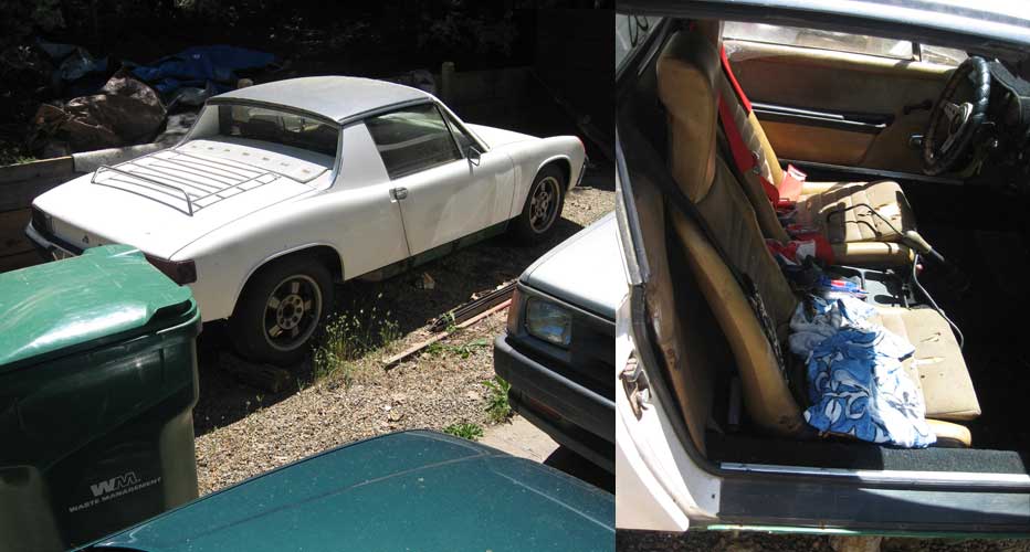

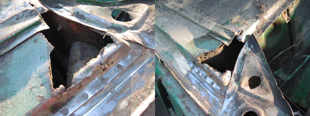

Here are some picks of the car as it currently sits. Notice the prodigious amount of grime that I now get to sweep up (IMG:style_emoticons/default/dry.gif)
I've started looking closer at the rust spots and am pleasantly surprised that there is not more (IMG:style_emoticons/default/piratenanner.gif) ....though it helps to start with low expectations. It looks like I will need to replace the engine shelf under the battery tray (which seems to have already been replaced by a PO). Does anybody know what the best way is to check the inside of the longs for rust? I figure I'll have to cut the exterior off, just wondering where to do it at.

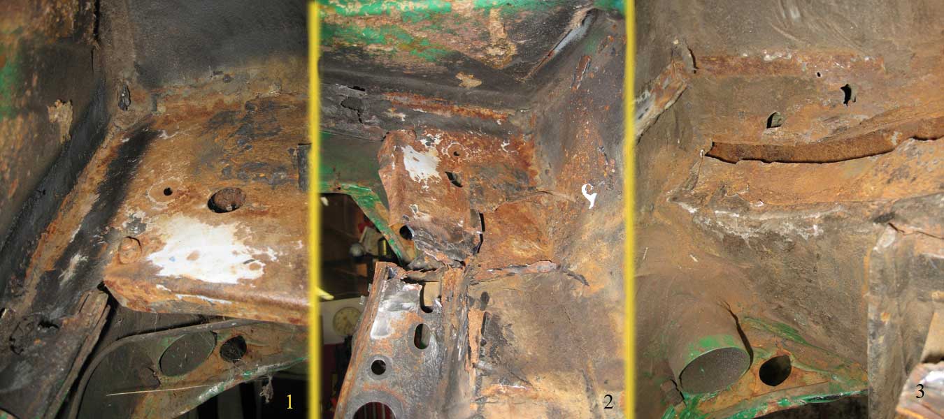

Here are some close-ups of the hell-hole and the engine shelf under the battery tray

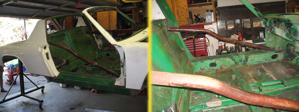

Before you get too carried away cutting out metal, I think you should brace the door openings while it is on the rotisserie.
The longs have some rust inside, they all do. There have been several threads about it, I will search and post some links.

You should get some bracing in the door ways to keep it straight from the beginning.
There are some dimensions in the 914info section here so you can measure and set the distance from the windshield frame to the roll bar.

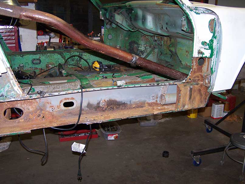

I started the big dig into the hell hole this weekend and have yet to get to the bottom the proverbial rabbit hole. Before any cutting started I made use of some scrap metal to make the braces for the door jams.
I know they are a bit ... thick ... but hey, the metal was free. Donated from the old roll bar out of my dad's old Jeep (After he upgraded).
I cut out what was left of the battery tray and started into a past owner patch job only to find a treasure trove of rust. Its as if the guy who did the patch just welded in some metal w/o touching the rust beneath it (IMG:style_emoticons/default/mad.gif) Every cut only seemed to expose more.

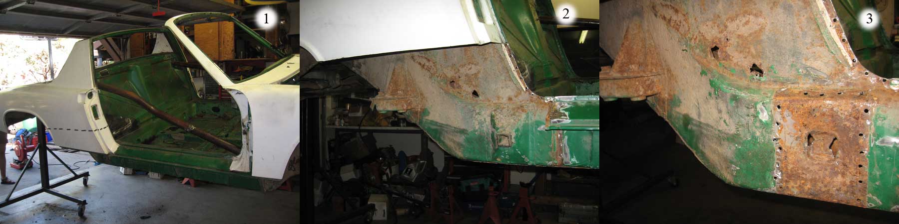

Got a little bit of work done yesterday on the car. I feel as if I'm finally nearing the bottom of the rabbit hole here with the passenger side longs. I spent a few hours and two drill bits removing spot welds on the passenger rear fender and the passenger jack plate. And before I knew it I had (IMG:style_emoticons/default/sawzall-smiley.gif) the rear fender back to expose the rest of the long up to the outer suspension console. I have to admit, I was really nervous making the first cut seeing as how this was my first time and all... (IMG:style_emoticons/default/humpy.gif) ...Anyways, I bet you can't guess what I found under there! Looks like I will be replacing a bit of metal under there. I can't wait to see what inside the longs, but maybe I should get a tetanus shot before going further (IMG:style_emoticons/default/idea.gif)

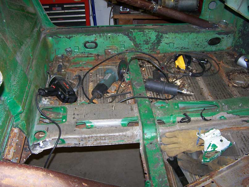

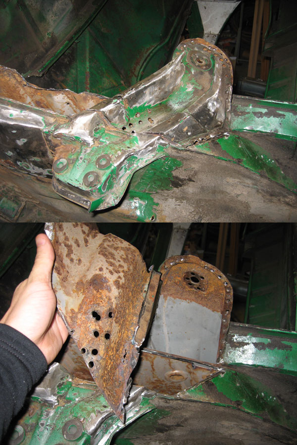

Ok....its been a whjile since I've last posted. And I cant say that I've gotten that much farther. I think though, that I've finally reached rock bottom! the cancer (in this section at least) has almost all been cut out of the hell hole and now I can start thinking about putting things back together. There were some casualties however... As I peeled back the layers, the rust continued to extend deeper into the car until had finally cut out the right side engine mount and the top of the suspension console on the same side (see pics)...
These pieces (to me at least) look pretty dismal. I'm hoping against hope that after a thorough sand blasting the engine mount can be reinforced and salvaged. The suspension console, on the other hand, has rusted through in many of the awkwardly shaped sections such that I'm thinking replacement is in order (IMG:style_emoticons/default/dry.gif). After a bit of research I've decided to forgo POR15 in favor of a different product called "Rust Bullet" (IMG:style_emoticons/default/stirthepot.gif) . I've ordered a quart (supposed to cover 25 sq. ft) and will use it to protect the inside of the passenger long. I cant wait to start patching this thing back together!
...some pics of the Hell hole now missing much of its metal...

Ok kids, I know its been a while - but here are some more pics...
I have to admit, I'm really starting to wonder if my car came from the factory with some of this rust! As soon as I think I'm getting to the end of it It just keeps going! As you can see I'm almost thru to the inner most section of the front long. I'm honestly a bit stumped on how to proceed there. It looks like the next piece I need to remove is sandwiched in by the front fender. Are my only options to either remover the front fender or to just cut it out? Unfortunately it looks like the rust goes all the way into the corner...so I think I will need to spend some time researching the other build threads for ideas. Is there a point at which you just say "screw it!", spray on some POR-15 and then (IMG:style_emoticons/default/beer3.gif) to forget about it?
I have also removed the rear passenger floor pan and lower firewall to reveal more cancer. Again, it seems to extend even deeper into the side of the car I was hoping would not need to be molested by my cutting wheel. This project has quickly turned into much more than I wanted, but there's no turning back now. Thankfully I've managed to locate an entire long (including suspension console) that I will be picking up in April. I just need to decide the best way to cut out the current one and weld in the new.

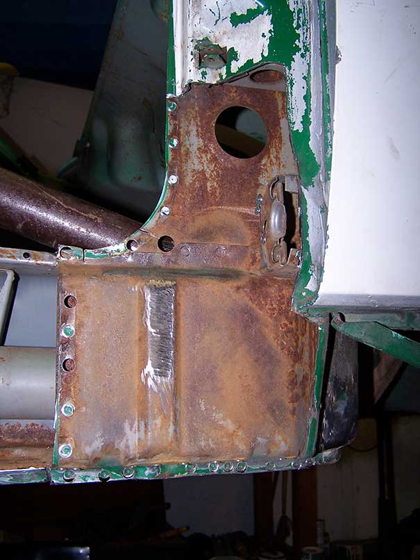

Its been so long since I've posted on this thread that I was curious if it was still around. After a little break in work on the 14er (...not my choice) I've finally started work on her again!
Since my last post I was able to pick-up a replacement passenger long from a parts car in So Cal, and have used it to replace the rusted one. A couple of pictures of the process are included below. In the first picture you can see the jig I made to make sure that the suspension console on the new piece aligns correctly. You can also see the fancy tools I used to mock the new piece in place.
(IMG:http://www.914world.com/bbs2/uploads_offsite/lh3.ggpht.com-3684-1280706980.1.jpg) (IMG:http://www.914world.com/bbs2/uploads_offsite/lh3.ggpht.com-3684-1280706980.2.jpg)
Once the new long was in place I decided that I should start piecing back together the passenger door jam, and also check how the door gaps were holding up. After tacking in the lower door post I went to fit both the passenger and driver's doors. Unfortunately, neither one wanted to line up well (though the driver's side would at least close...). After a lot of measuring and comparing against that handy body measurement reference here on 914World I decided that the passenger side of the front cowl had sagged a bit and moved forward in the whole long replacement process. Half an inch makes a big difference! So, using a scissor jack and a jig, I proceeded to push out the door gap on the passenger side until I was getting the appropriate measurements. When I put the doors back on they fit whole lot better, but still, far from perfectly. Both sides now close, but they both need to be lifted in order to do so. The passenger side is still a whole lot worse than the driver's side (At least it closes now). The frustrating thing is that I can't find which measurements are off! Every measurement I do to compare the two sides are withing 1/32" from each-other. Here are some pics comparing the two sides:
