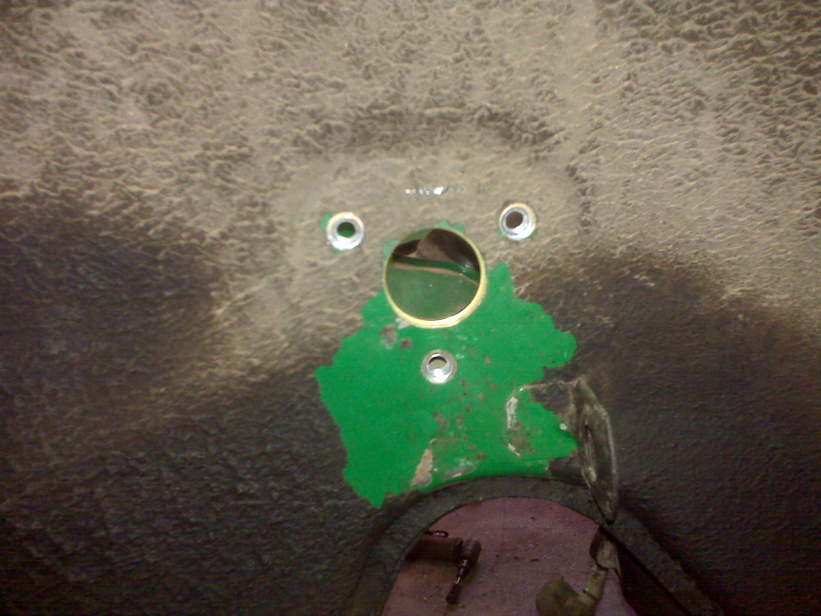

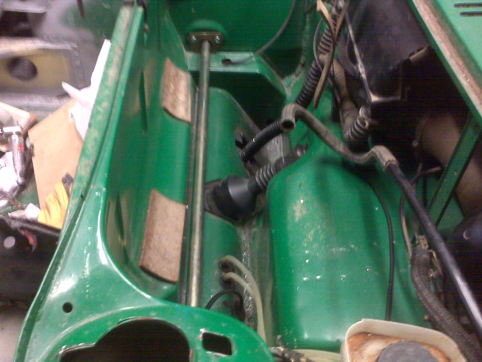

I'm installing a 22mm bar that came out of a car I cut up.

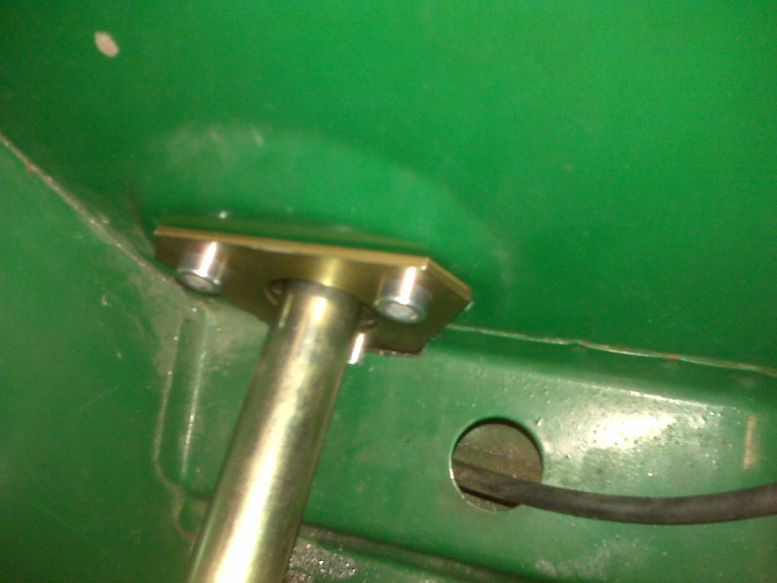

I still need to weld the plates in and replace the bushings. Eric, GPR and Pelican didn't have them. The operator at Pelican gave me a number to call to get them from the manufacturer. They're about $5 a piece. Unfortunately after shipping it was like $22 bucks. (IMG:style_emoticons/default/sheeplove.gif)

Welded in and waiting on bushings..

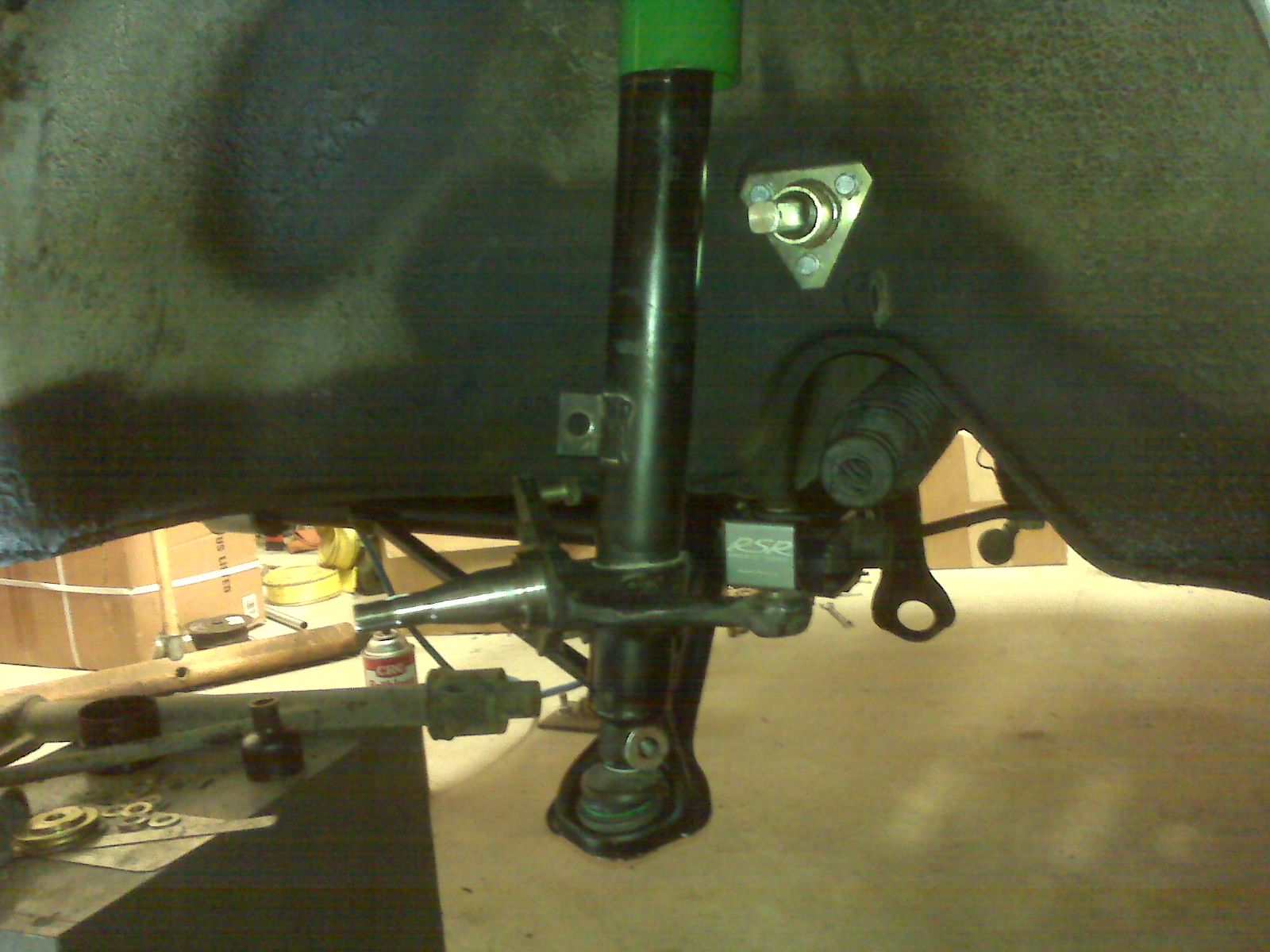

Front suspension bits coming together.

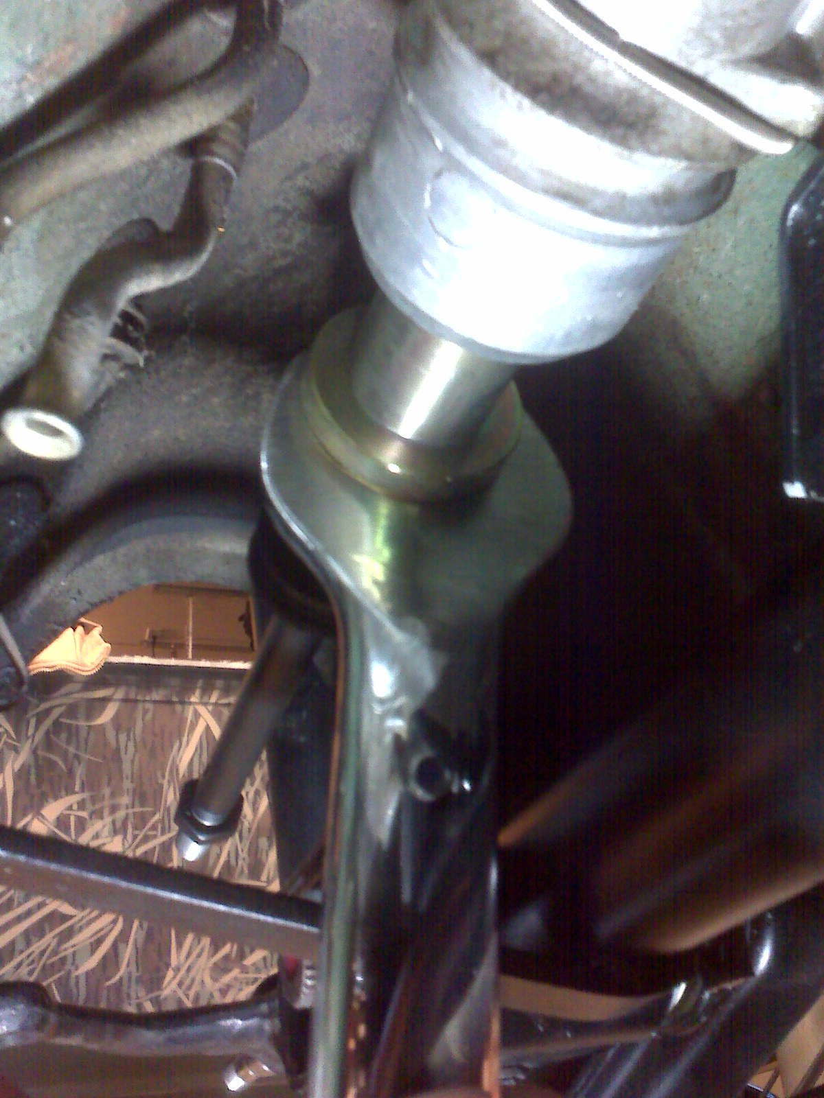

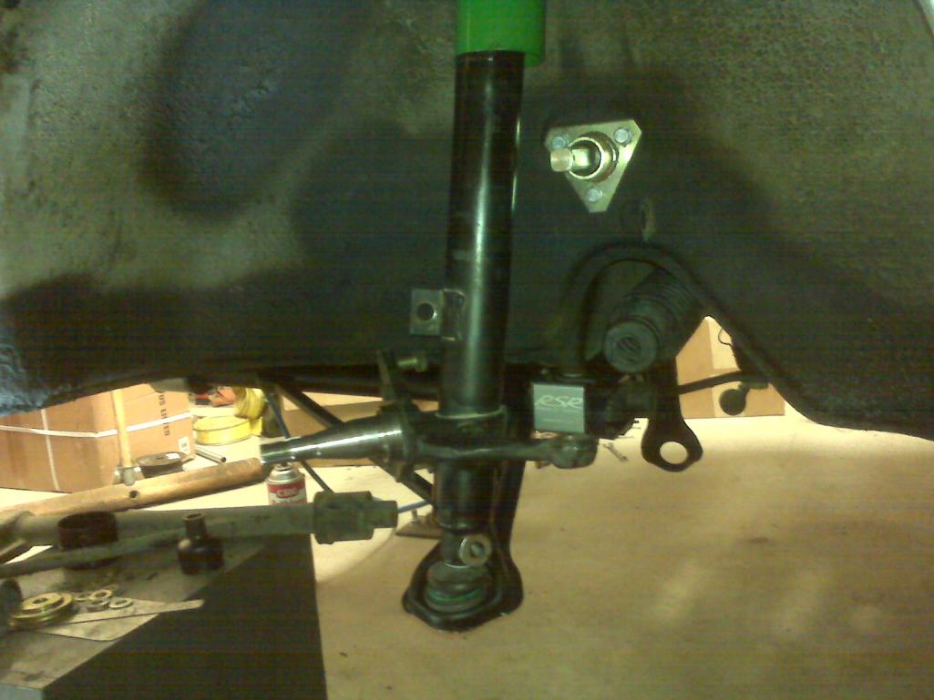

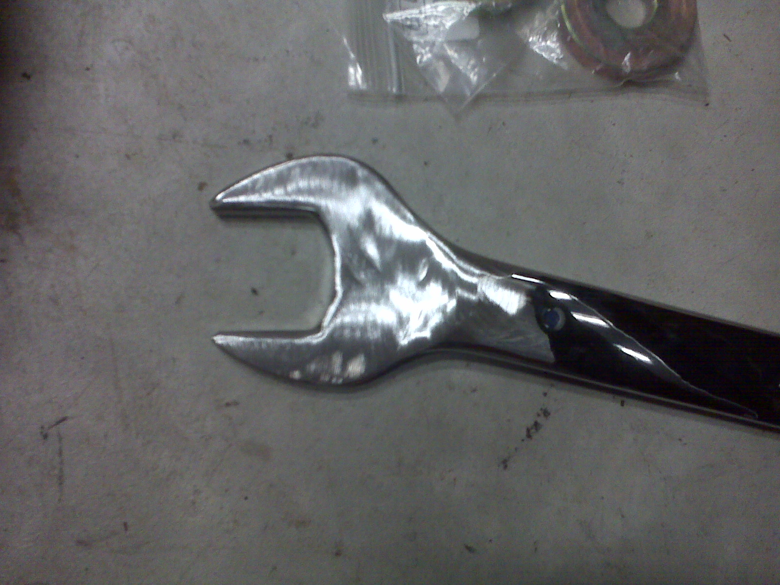

Installing turbo tie rods. Couldn't find the universal inner tie rod tool at any flaps. I ended up buying a cheap 1 1/4" wrench and grinding it thinner.

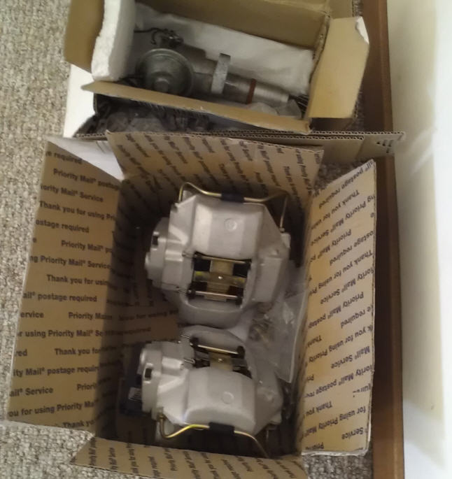

Winter froze me out of the garage but I'm starting to get some more parts together. Eric hooked me up with a set of rebuilt S calipers and I picked up a Bosch dizzy for my 2.4 off of ebay.
Any recommendations for a place to send the dizzy for a rebuild?

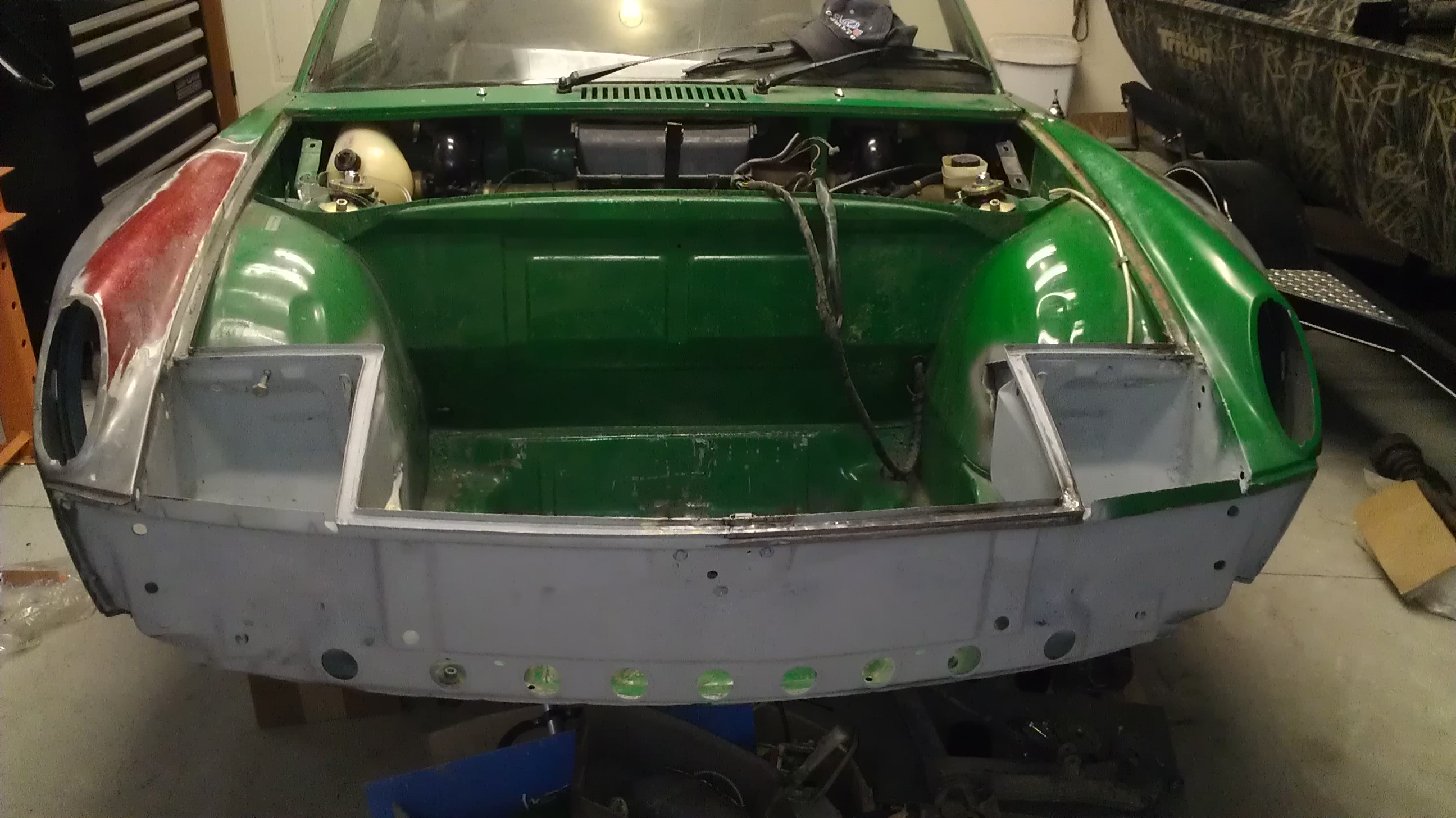

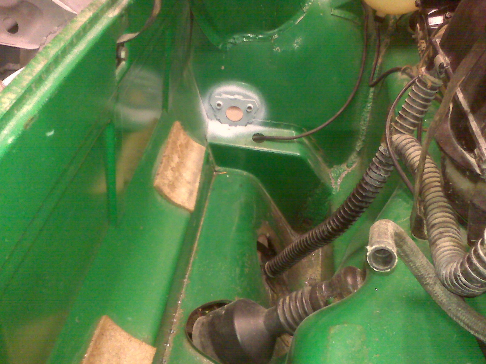

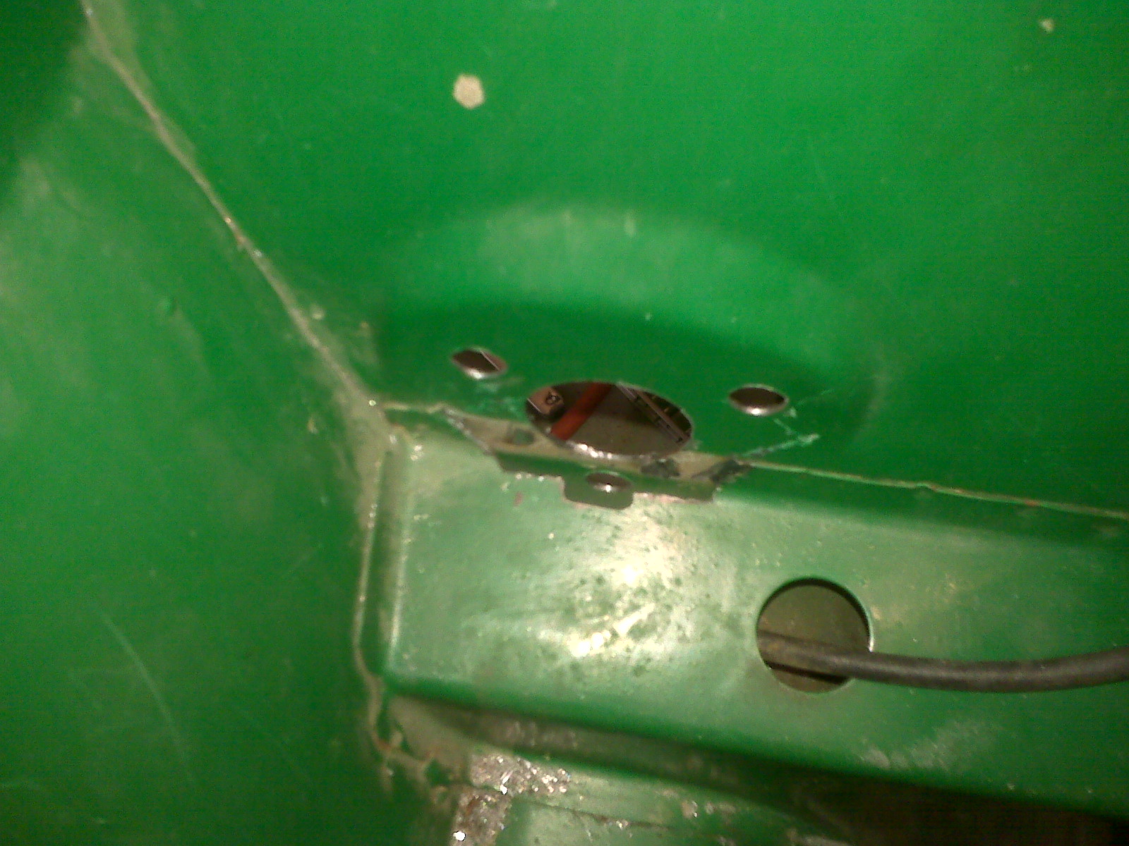

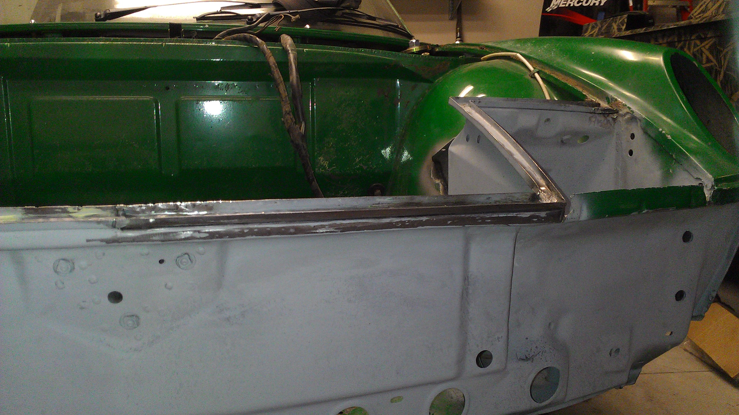

Finallly have two headlight buckets in. I also repaired the front driver side panel and hood seal area. Once I finish up the front flare install I'll paint the front of the car.

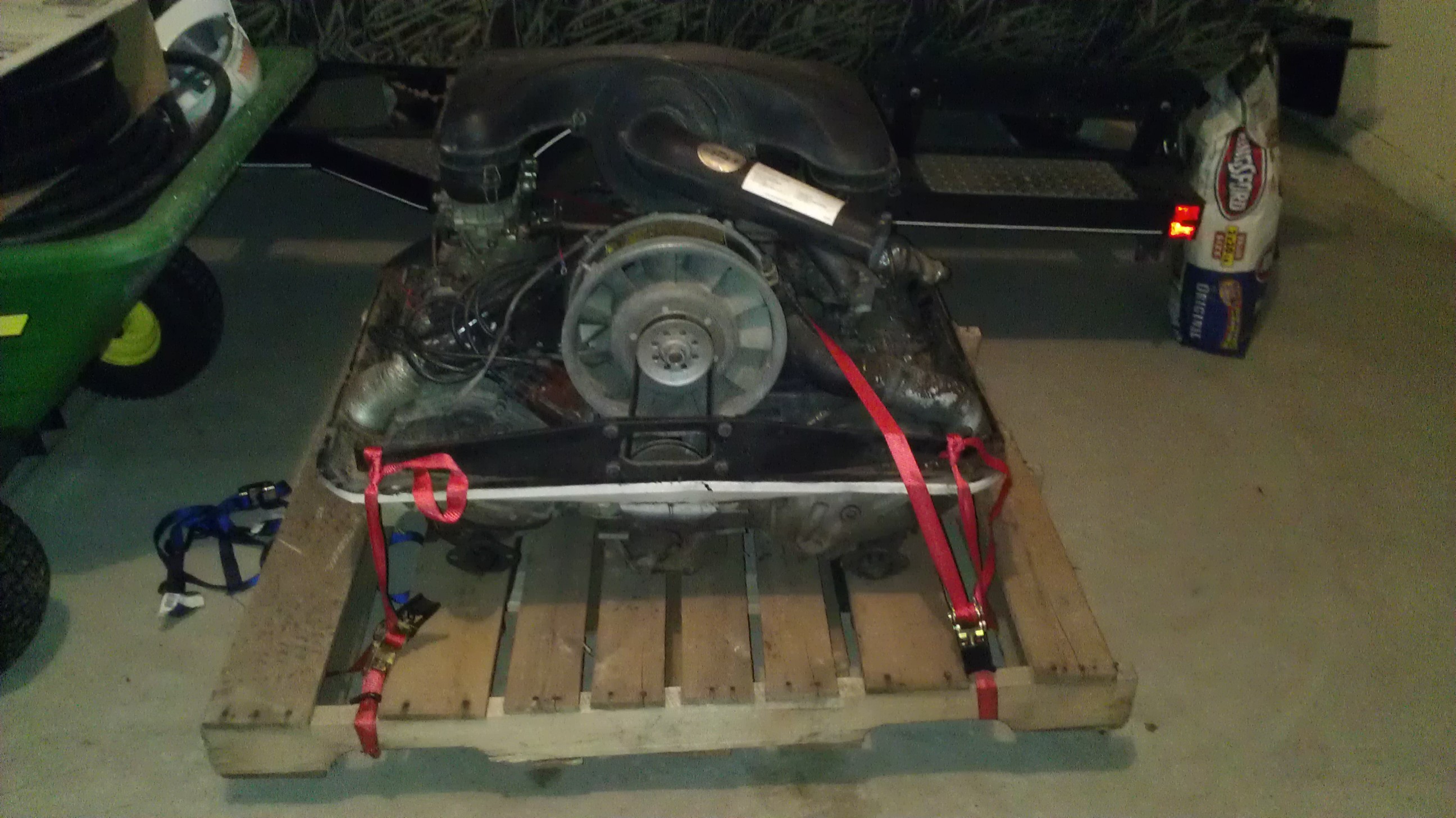

Saw a 2.2T on Pelican and decided to buy it. It arrived today. I needed a bunch of stuff for my 2.4 . This fit the bill and the price was right.
