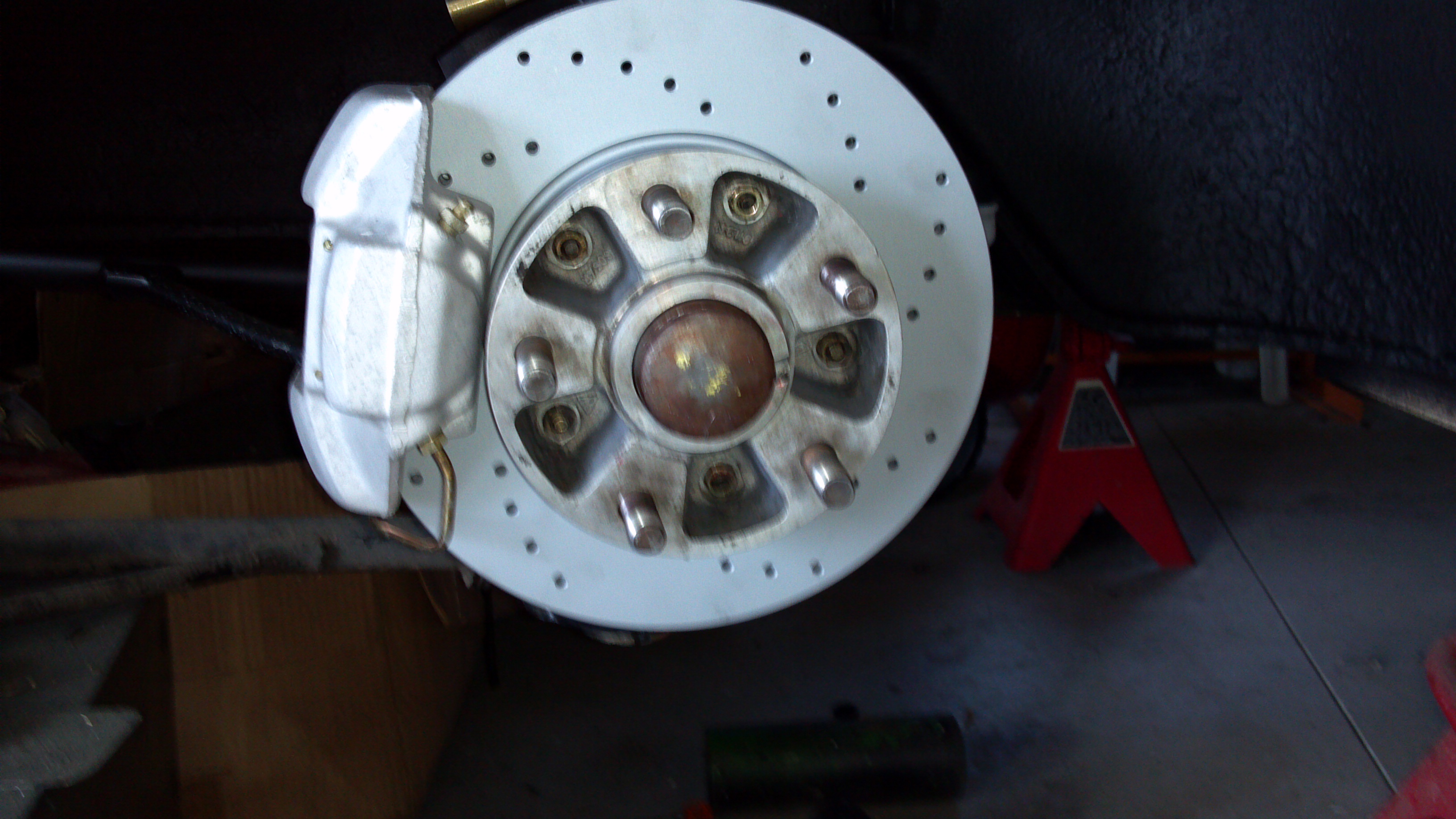

I had planned on painting the car before I put it together. Plans change. I need to get this thing rolling. After 2 years without progress I need some motivation. Driving it down the road is what I need.
Cleaned up the 911 hubs with oven cleaner. Didn't get them perfect but close enough for the girls I run with. Installed new bearings. What a total PITA. Even after baking hubs at 250 and using a 20 ton press they were difficult. Not looking forward to doing that again. Installed new rotors and S calipers (thanks Eric). A day or two more on the front's and I'll move to the rear.

I saw you front hub post but the wifi where I'm staying went down so I couldn't comment. (IMG:style_emoticons/default/smash.gif) (IMG:style_emoticons/default/sawzall-smiley.gif) (IMG:style_emoticons/default/smash.gif) Keep after it!
