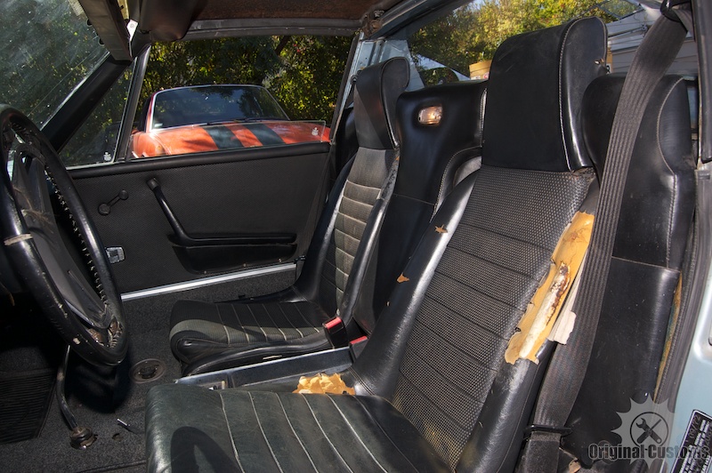

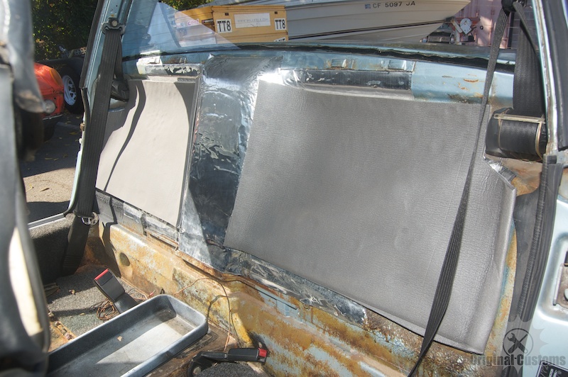

Finally added some sound proofing and installed the back pad. The foil-backed, self-adhesive stuff is Damplifier Pro and the gray foamy stuff (which I glued on with 3M 90 High Strength Adhesive) is Luxury Liner. Both of those are made by Second Skin.
I'm pretty happy with how quiet it is inside now. The door seals are the worst part now and I'm working on those...
Oh and I need to better freakin' seats. (IMG:style_emoticons/default/barf.gif)
JRust
post Oct 15 2012, 05:04 PM
Post #125
Posts: 6,317
Joined: 10-January 03
From: Albany Oregon
Member No.: 129
QUOTE(McMark @ Oct 15 2012, 11:16 AM) *
Are you looking for bone stock seats? I have a couple sets of oddball recovered ones. One set is black leather with blue cloth inserts. Then a I have some stranger ones (IMG:style_emoticons/default/blink.gif)

QUOTE(McMark @ Oct 15 2012, 02:16 PM) *
You put the Luxury Liner on backwards (IMG:style_emoticons/default/poke.gif) . The foam goes towards the sound source. The vinyl reflects any sound that gets through the foam.
I had that in my 914 until the heat of the engine softened Second Skin Audio's adhesive and the LL came off. You're probably ok since it's behind the seat pad.

Damn, you're right. (IMG:style_emoticons/default/dry.gif)
Gotta pull the backpad out to install a dual-pane back window (once I have it cut). So I'll fix it then. Pays to read the instructions... (IMG:style_emoticons/default/rolleyes.gif)
