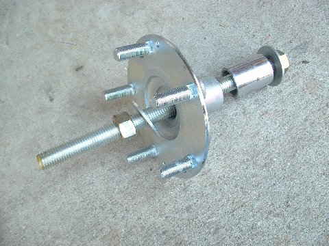

I've been converting my project car from 4 to five lug and have run into a snag. After installing new bearings in the rear, I attempted to draw the rear hubs into the bearing using the tool below. No matter how careful I am, the hub starts to go in crooked so I stop, not wanting to force it it.
So what's the trick to getting these puppies started straight? It seemed like an easy enough task.
I do have the rear arms mounted, thinking it would be better held in place. Would pulling the arms and having the laying flat be any better.

roadster fan   Hey Mark, You have the right idea on the tool. I...   Sep 28 2008, 11:06 PM
computers4kids   Hey Mark, You have the right idea on the tool. ...   Sep 28 2008, 11:26 PM
Eric_Shea   Spin it. Find the high side. Lightly Tap-tap wit...   Sep 28 2008, 11:30 PM

Phoenix-MN   Looks like the hubs have been plated, is the beari...   Sep 29 2008, 10:17 AM
roadster fan   That's a good point. The machined surfaces if...   Sep 29 2008, 10:51 AM
computers4kids   This picture is not my hub--just used because it i...   Sep 29 2008, 06:53 PM
