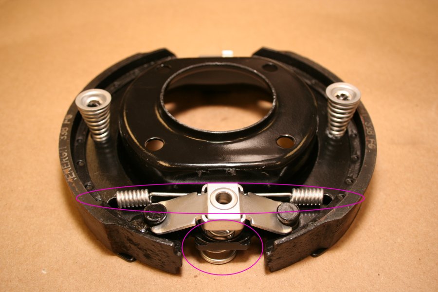

I bought these parts from Parts Heaven. They do not look right but there is no part number on the brake shoes. Are these the correct brake shoes? As you can see in the picture the holes do not line up and they are hitting the brake shield bolt hole.
Steve

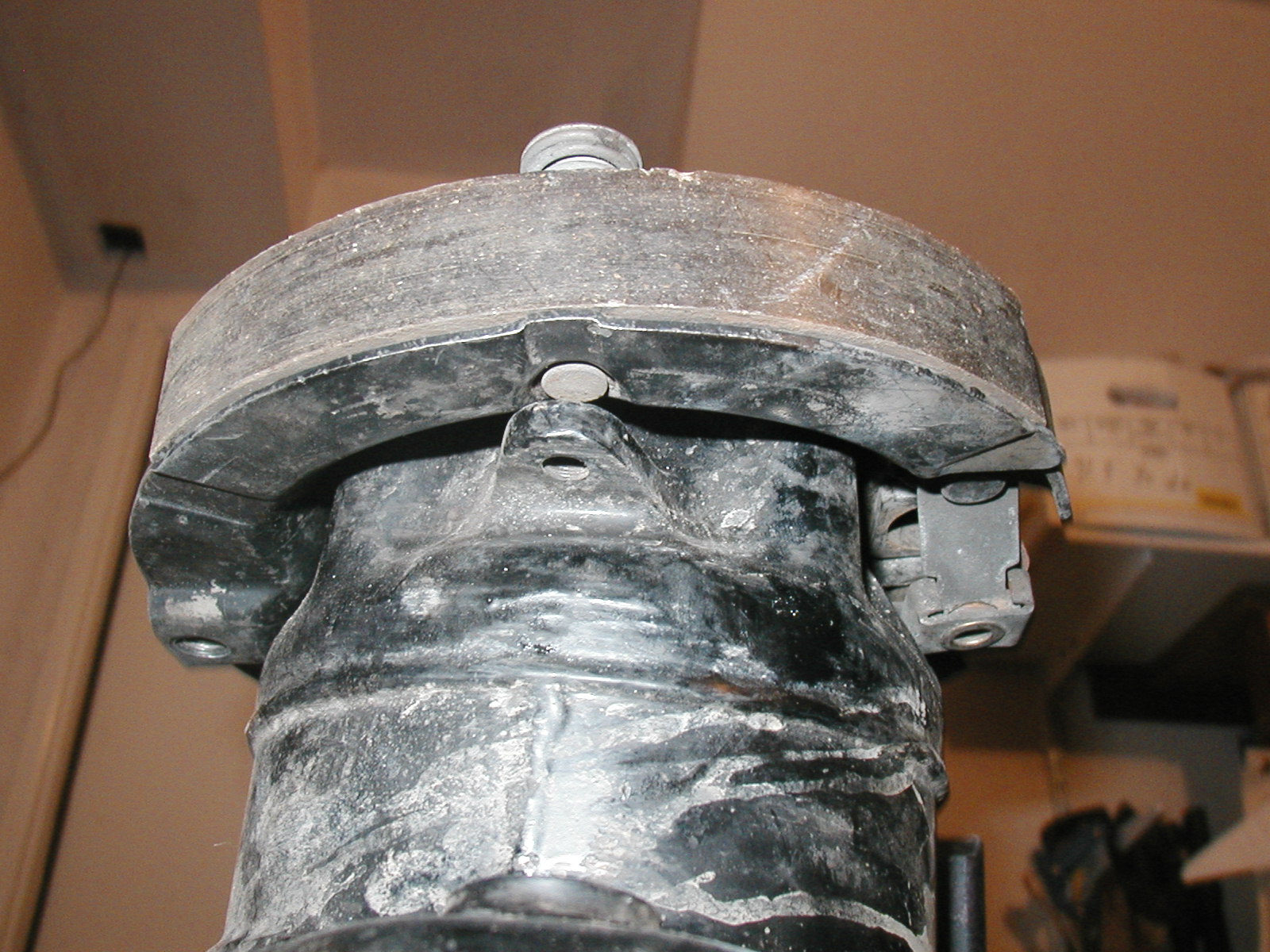

Here's the one with the bolt holes.

You happen to get a later year e-bake assembly that had the trailing arms with a wider bolt spread. All you have to do is file or grind the bolt hole to match your trailing arms. I got the same one as you have and had to do this. As far as the brake shield tab goes you have to cut them off.

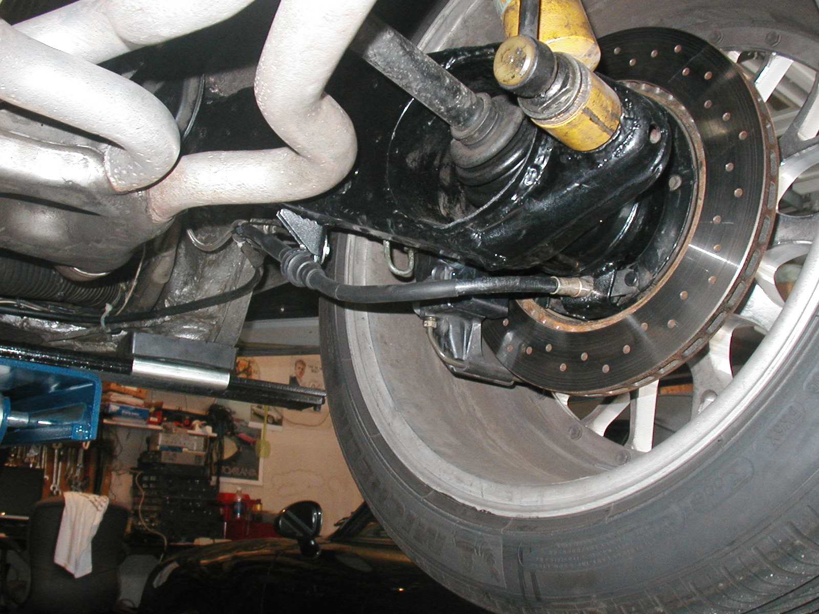

Attached ImageI finally put mine together and tested it out at Willow Springs short track. I am running Boxster rear brakes and 944 turbo front brakes. I ended up copying pretty much everyone. Thanks again to Wes for welding up the stop plates on my trailing arm. For the least amount of hassle I ended up using 914 clutch cables, cut to length and stock 914 emergency brake outer sheathing.
Steve

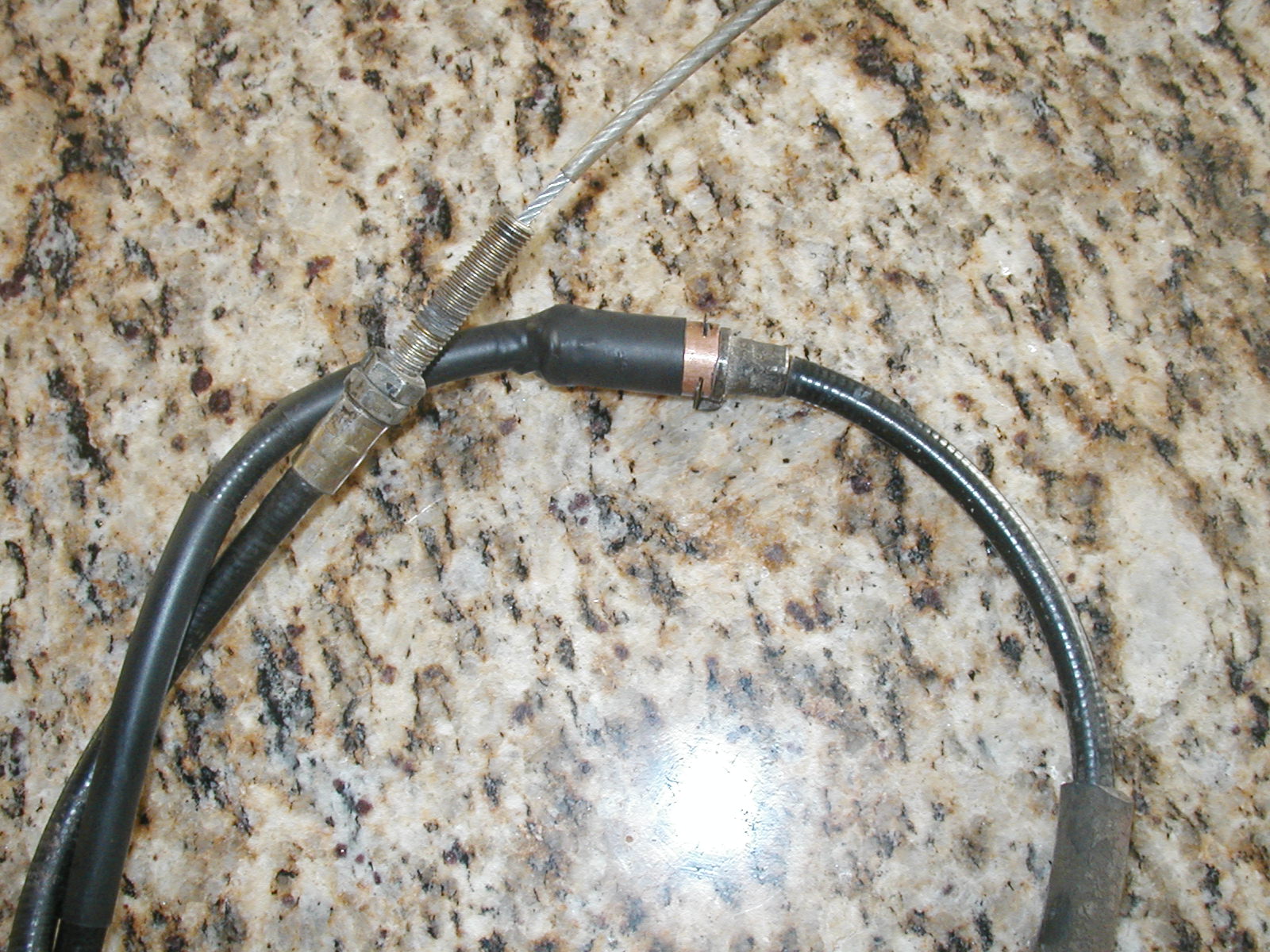

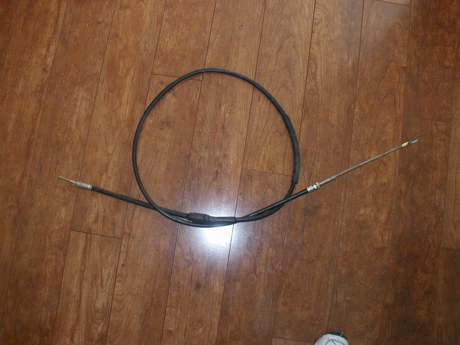

Attached ImageHere's a picture of the fabbed up cable. You can see in the picture that i used the stock 914 outer sheathing and a piece of the 914 clutch cable outer sheathing. I used a 2" piece of 5/8th OD copper pipe to tie them together. I notched the copper pipe to support the stock C clip on the 914 E. brake cable. I pretty much copied Clay, but used a piece of the clutch cable sheath versus bending a piece of conduit. Pro's and con's on all the techniques, but mine was the least amount of hassle for me and my lack of welding and fabrication skills!!

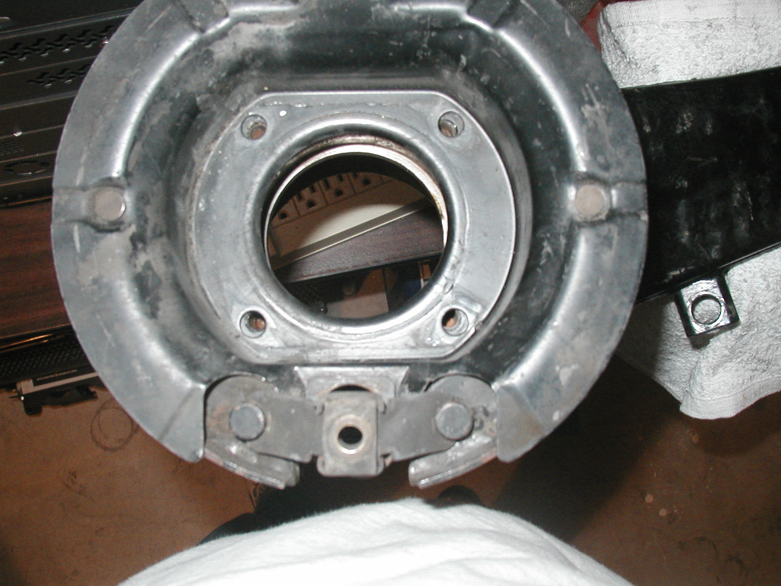

Here's another picture of the copper pipe before I covered it with shrink wrap.
