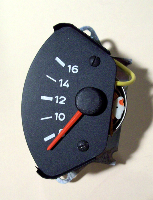

Anyone know how I can go about popping that oil level module out of there and replacing it with a volt module?
I want the one gauge center console look - plus I need room for the lcd screen. I believe it can be done, jus curious if anyone had some info that would save me from more research.

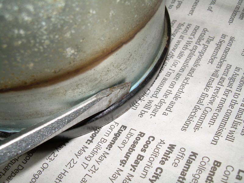

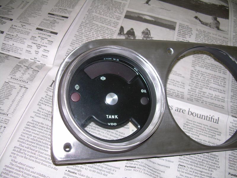

If the 911 levels gauge is like the 914 gauge (and I'm pretty sure it is... I don't own one yet), you should just have to undo 4 screws on the back of the gauge housing to remove the module, and angle it a bit to get it out.
The problem is, that will still leave you with the "tank" and "oel" legends on the gauge face. To change the face, you have to pry the bezel off the gauge. Use a small flat blade screwdriver to carefully pry the back of the bezel until you can slip it off.

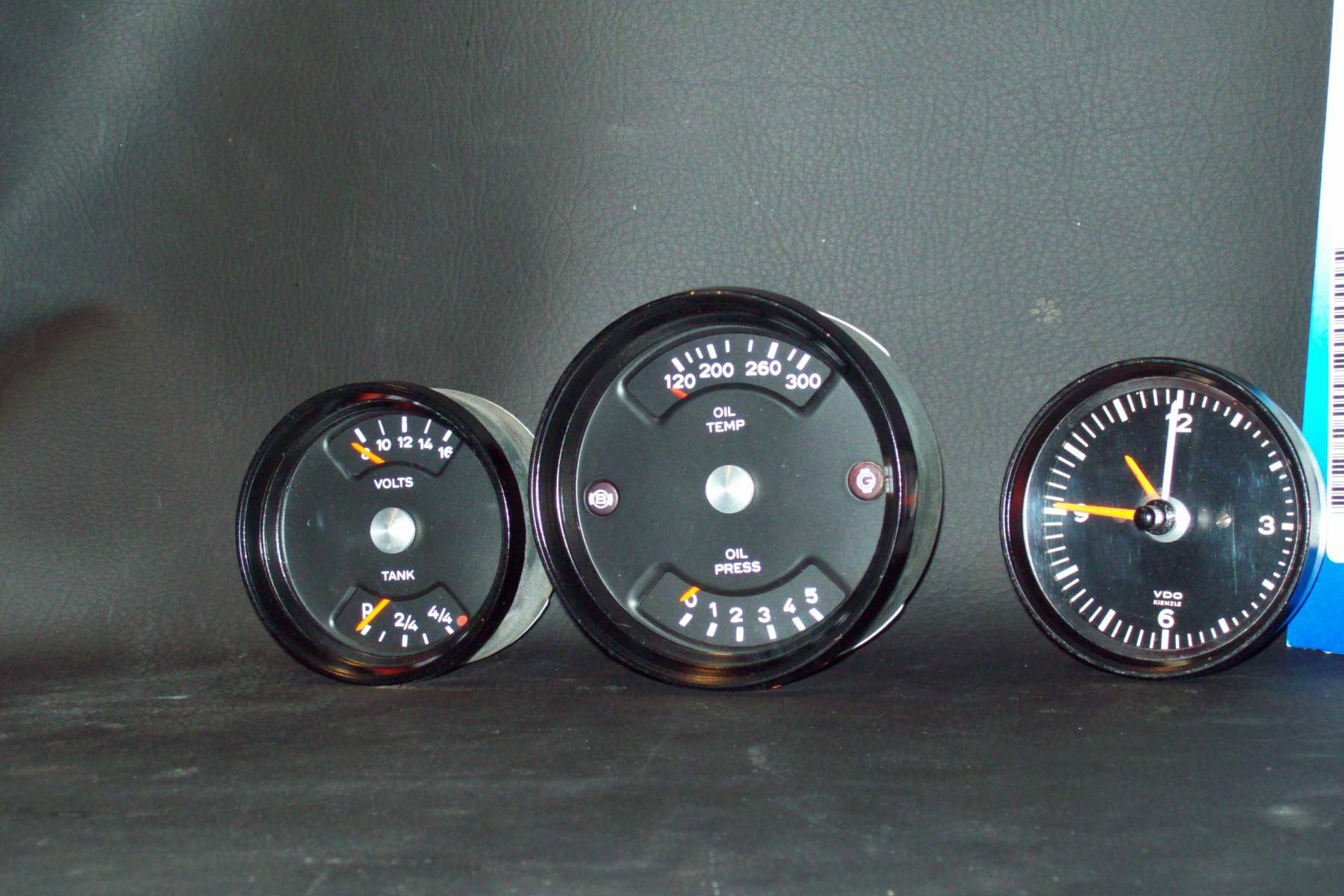

Cross post, but here it is:
It depends on what level gauge you want to do. Just the module, or re-do the whole gauge.
Mark
(IMG:http://inlinethumb01.webshots.com/5312/2644567510057582025S600x600Q85.jpg)

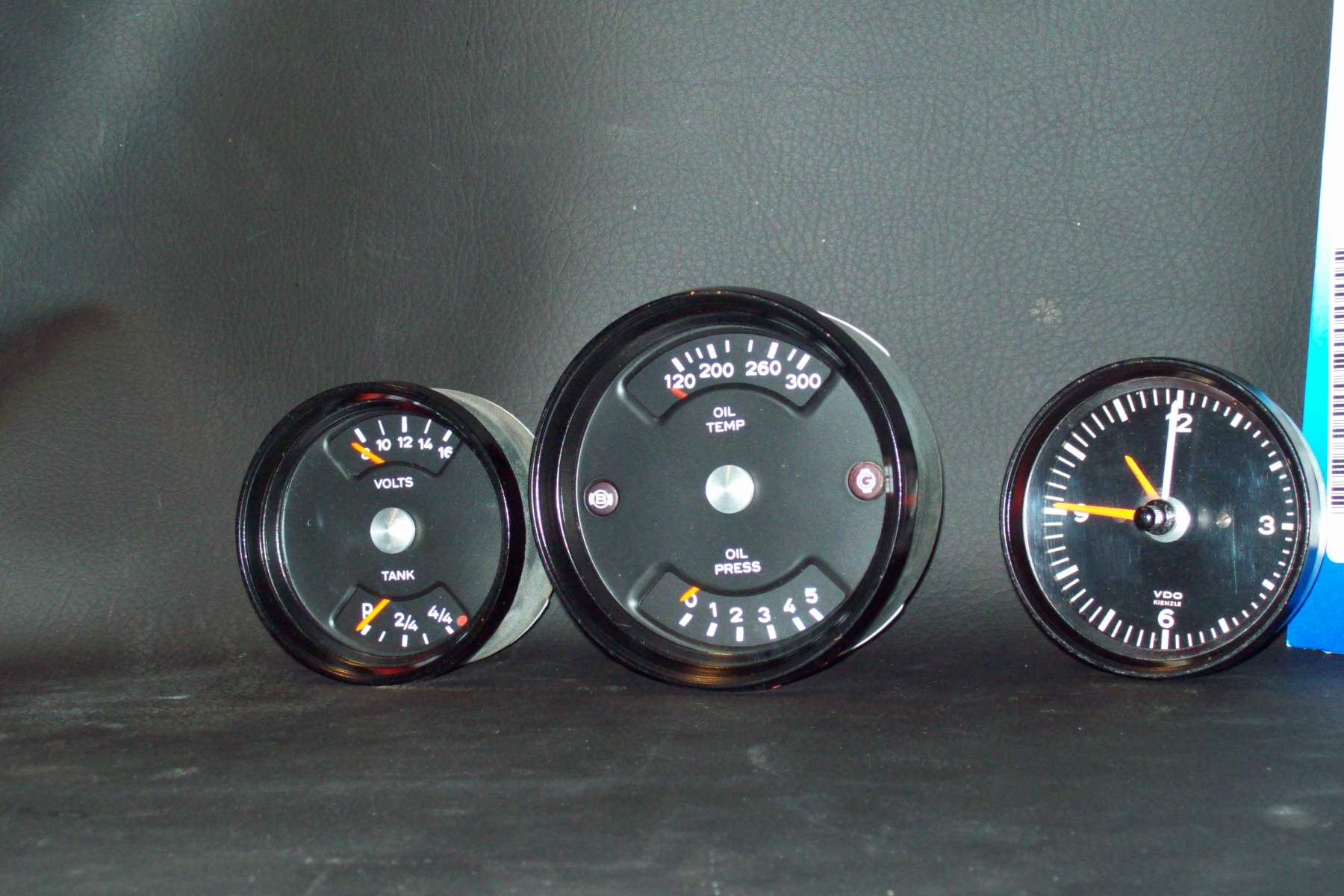

Here are some getty dash gauges with the 914 orientation and 914 fuel gauge installed
Mark
marks914
post Oct 10 2008, 05:25 AM
Posts: 845
Joined: 9-October 04
From: the motor city
Member No.: 2,912
Mark
