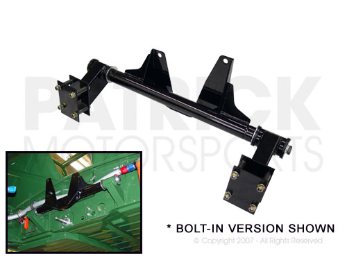

I have been looking at different bulk head mounts and I am leaning towards the patrick motorsports mounts. I figured I might as well throw the question out there to see what others have used.
Right now the reasons I am leaning towards the PM mount is because it has the mounts further apart, seems to have a more race oriented poly mount, and a good quality construction. The negative is that it is about 200 more than the other mount I am looking at but I figure worth it for a fairly mission critical part.

you will get a lot of feed back that patrick's stuff is no good
I think the motor bars often did break
I have the patrick bulkhead mount
its good for racing
not good for originality
I can drop/tip my motor more easily with this mount
I once dropped it 2x in one day at a track and still finished the day out on track.....
good for racing if you factor in serviceability.
(not sure it adds any benefit in structure)

The patrick mount doesn't nearly have the same surface area to weld to the firewall.
And i certainly wouldn't just bolt it on anyways. The racers like it because it's easy to drop the engine and transmission just enough to get to the valves.
The RJ mount is much more "sturdy" and i use it with 911 sport motor mounts on my 3.6L ...

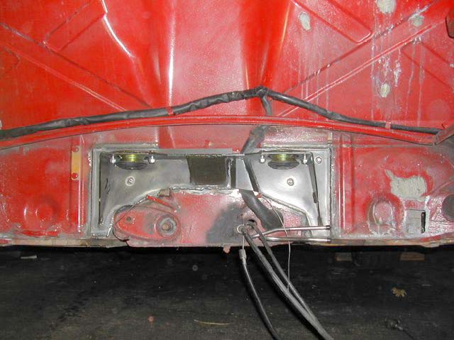

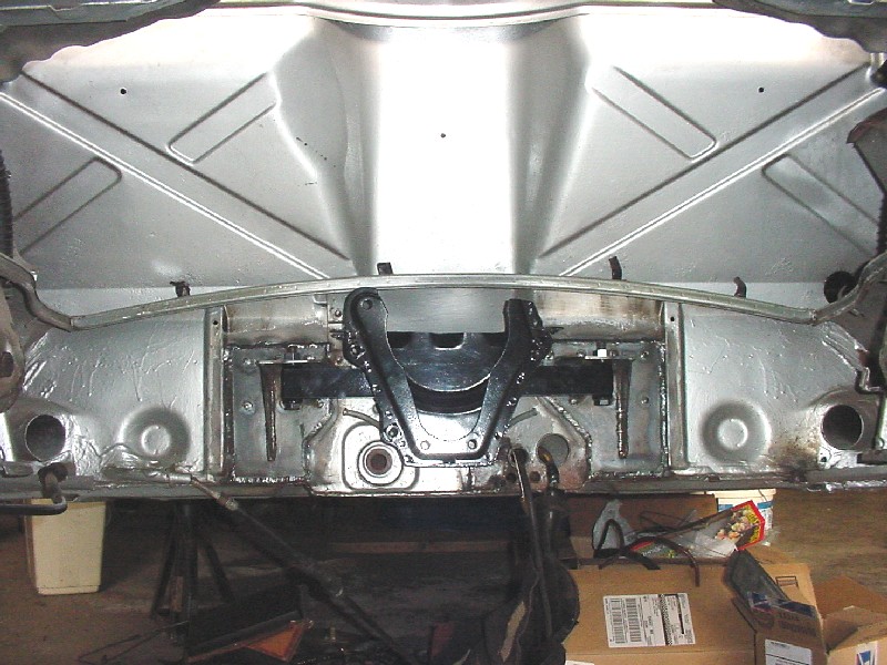

Here's a pic of mine with a nice welded bead around it:

I have to say I really like the Patrick mount. It was easy to install, I did it in a day while I was swaping enigines. Pulled the engine, tacked and welded it up, and when I was ready to put the other engine in it was ready. Didn't need to pull the wiring harness or lines or anything. Plus, there is more surface area than a stock six mount and they use these in cars with over 300hp.

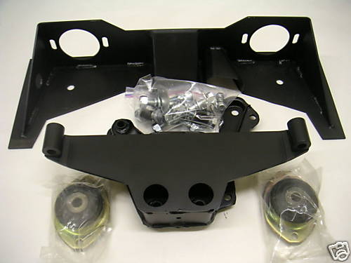

How about this one?
e-bay link
Grngoat
post Oct 22 2008, 12:18 AM
Lurker Member
Posts: 158
Joined: 17-October 04
From: Fort Worth, TX
Member No.: 2,967
QUOTE(Lou W @ Oct 22 2008, 12:59 AM) *
How about this one?
e-bay link
That is the Rich Johnson mount. A914guy@aol.com is his e-mail. So you'd be buying it directly from him cheaper than through Pelican.

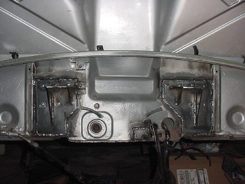

Funny thing, that is my car in the second picture. The one of the freshly painted mounted. All the other pics are a different car. I forgot that I sent him that pic. Cool.

cool I bought that one. 305 bucks I figure good quality and price.. Thanks again for all the feedback.
