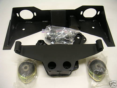

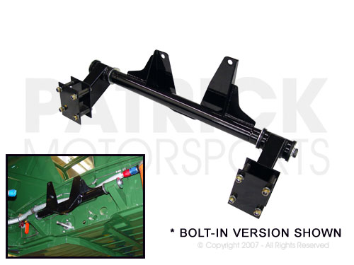

I have been looking at different bulk head mounts and I am leaning towards the patrick motorsports mounts. I figured I might as well throw the question out there to see what others have used.
Right now the reasons I am leaning towards the PM mount is because it has the mounts further apart, seems to have a more race oriented poly mount, and a good quality construction. The negative is that it is about 200 more than the other mount I am looking at but I figure worth it for a fairly mission critical part.
Here is the PM mount:
Click to view attachmentHere is the other one I am looking at:
Click to view attachmentAll feedback both positive and negative are appreciated.

you will get a lot of feed back that patrick's stuff is no good
I think the motor bars often did break
I have the patrick bulkhead mount
its good for racing
not good for originality
I can drop/tip my motor more easily with this mount
I once dropped it 2x in one day at a track and still finished the day out on track.....
good for racing if you factor in serviceability.
(not sure it adds any benefit in structure)

I think that the motor bars that were of concern were the ones that mount to the stock four locations.
I don't think that you can use the stock style heat exchagers with the PMS mount.

The patrick mount doesn't nearly have the same surface area to weld to the firewall.
And i certainly wouldn't just bolt it on anyways. The racers like it because it's easy to drop the engine and transmission just enough to get to the valves.
The RJ mount is much more "sturdy" and i use it with 911 sport motor mounts on my 3.6L ...
Andy
Here's a pic of mine with a nice welded bead around it:

I have to say I really like the Patrick mount. It was easy to install, I did it in a day while I was swaping enigines. Pulled the engine, tacked and welded it up, and when I was ready to put the other engine in it was ready. Didn't need to pull the wiring harness or lines or anything. Plus, there is more surface area than a stock six mount and they use these in cars with over 300hp.

Either of the 2 mounts you first pictured are great and will work. I really like the RJ mounts and have installed bunches of them. I personally preffer the Maddog mounts which is pretty much the same as an RJ mount which was pretty much the same as the old Velios mounts. The maddog mount you have to pull the wirring loom through it rather than cover it up. Looks more factory, more work, but if you ever have to get to wires for any reason, you'd be happy you put in a maddog mount. Those are my favorite.

I guess I am now torn between the 2 b/c being able to do a slight drop for a valve adjust is very appealing. However, stability is nice but it seems the PM bulk head mount was never a problem but the one that mounted to the oe positions was but is NLA. the RJ mount is actually more expensive if purchased from Pelican by 150 but he seems to post on other forums for less than the PM price. Decisions, decisions...

Funny thing, that is my car in the second picture. The one of the freshly painted mounted. All the other pics are a different car. I forgot that I sent him that pic. Cool.
