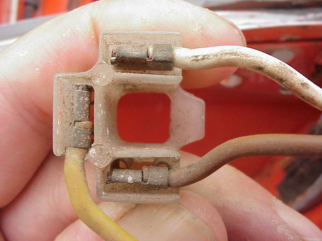

Brown, Yellow (56b), white (56a) Track 17 - 21 on the 75/76 wire diagram).
Which wire goes to which terminal? If these used to have plugs with marked numbers, they no longer do.
Lets assume that the terminals on the lamp look like this:
Top is what?
Left is what?
Right is what?
Are the left and right headlights wired the same?

Top=yellow
right=white
left= brown
left , right same. Looking from the driver seat

Does this help?
Paul

YES!
Thanks guys (both of you). Now I can run out and check off another item!
