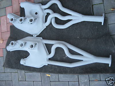

9146986   Here's a pic from the GHL website, the heater ...   Oct 27 2008, 11:49 AM
J P Stein   Here's a pic from the GHL website, the heater...   Oct 27 2008, 12:07 PM

9146986   The Hayward & Scott have welds inside the heat...   Oct 27 2008, 11:41 PM
number6   The Hayward & Scott have welds inside the hea...   Oct 28 2008, 04:29 AM
SirAndy   The Hayward & Scott have welds inside the he...   Oct 28 2008, 12:52 PM

Eric_Shea   Andy, Whay I think Perry is referring to is havin...   Oct 28 2008, 03:29 PM
Lavanaut   If there is a weld that is contained within that ...   Oct 28 2008, 04:59 PM
Root_Werks   If there is a weld that is contained within that...   Oct 28 2008, 05:03 PM
iamchappy   Stock HE's will work with the 3.2 ok, i know t...   Oct 28 2008, 05:16 PM
number6   From Hayward & Scott, in response to my inquir...   Oct 29 2008, 03:47 AM
Eric_Shea   If anything is wrong or goes wrong with that wel...   Oct 29 2008, 08:29 AM
