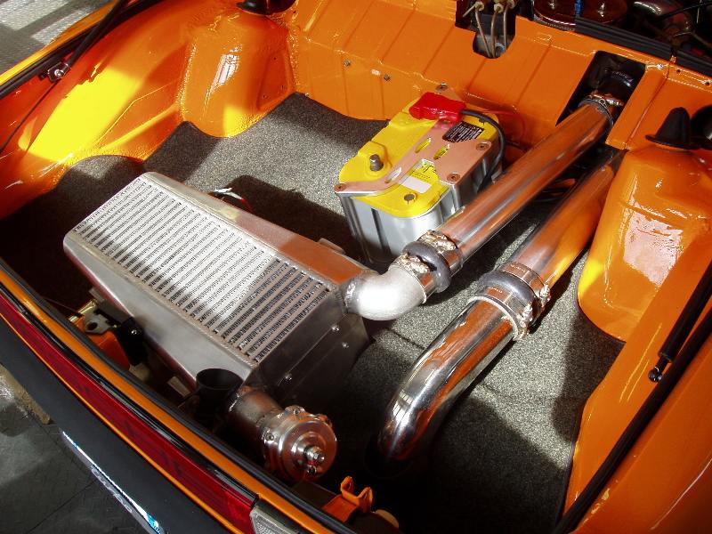

Mine is in the upper right corner of rear trunk. Keeps the weight nearly in the stock location. Fits without interfering with the top storage and gives much needed room to work in the engine bay.

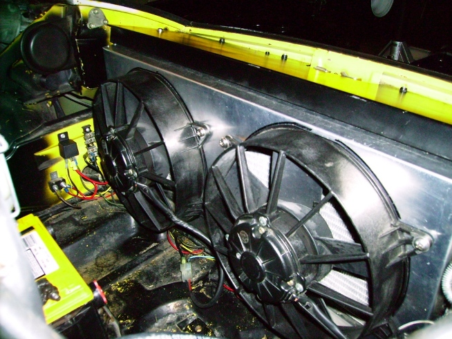

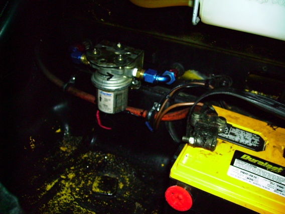

Mines up front next to the radiator Next to the fuel pump. I didn't move it, it came that way from the PO. he used welding cable thru the tunnel and back to a buss bar at the stock location. plenty of grounding straps at the Batt. , Trans, and Engine. I never have any Starting issues what so ever.
