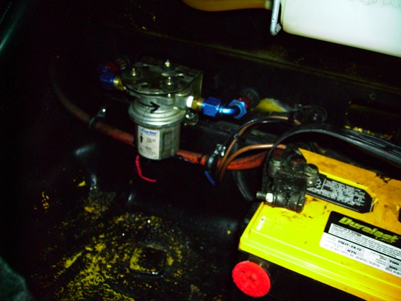

Nov 6 2008, 11:45 PM

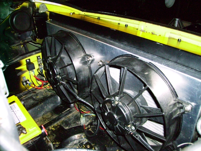

Mines up front next to the radiator Next to the fuel pump. I didn't move it, it came that way from the PO. he used welding cable thru the tunnel and back to a buss bar at the stock location. plenty of grounding straps at the Batt. , Trans, and Engine. I never have any Starting issues what so ever.
Click to view attachmentClick to view attachment

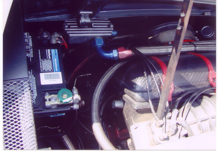

Engine Bay in a new location
Since this is my Daily Driver, I wanted to keep all engine related stuff in the engine bay: batteries, oil tanks, ignition modules, oil coolers, etc.. Trunks are really handy for things like: bookbags, gym bags, car cover, groceries, MotoCross helmets ...
The oil tank is in the stock battery location. So I put the battery on the other side of engine bay. I took the old rusty battery stand out, flattened it, then used it as a template for a new battery stand, which I formed into a mirror image of a stock battery stand. I then welded it in place on the left side of the engine bay before repainting the engine bay. I then put a new stock battery tray on it. Yep, I had to perform Hell Hole surgery, too.
This is an old picture, there is an Optima Red Top in there now. My last 3 Die Hards were Die Easys

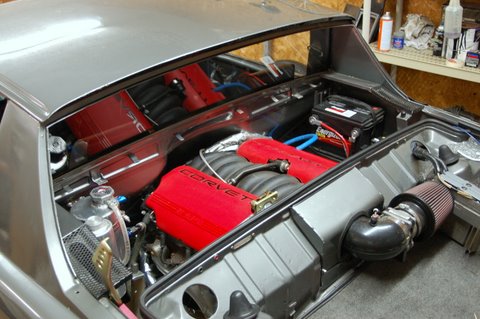

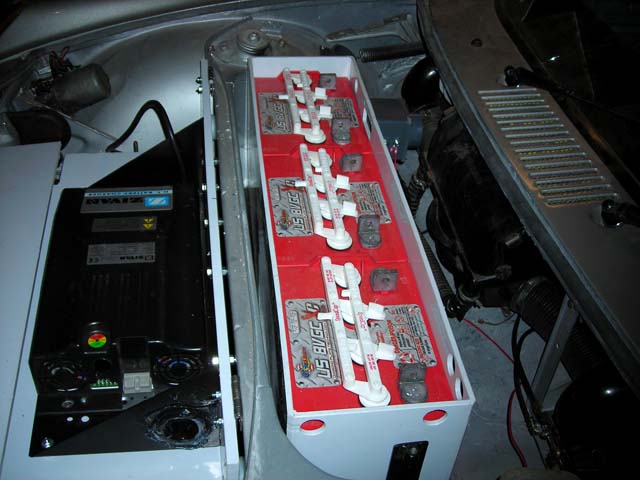

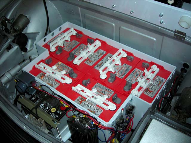

QUOTE(BIGKAT_83 @ Nov 11 2008, 02:50 PM)
Stock location works for me........
Click to view attachmentWTF?
Wow......
Justinp71
Nov 12 2008, 03:27 PM
QUOTE(OU8AVW @ Nov 12 2008, 01:17 PM)
WTF?
Wow......
No Sh!t... That is cool, what trans is that hooked to?Stock axles?
