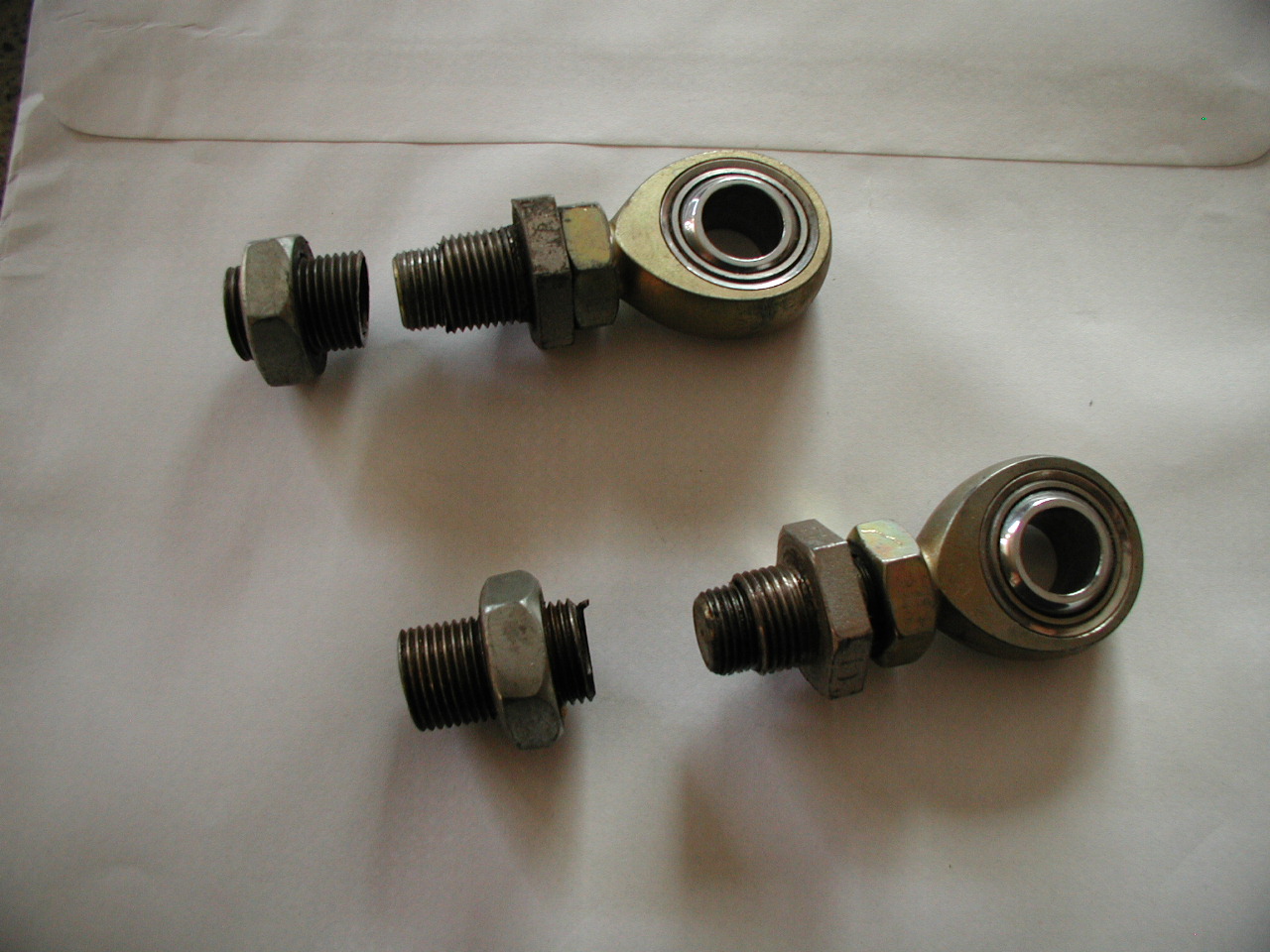

QUOTE(byndbad914 @ Jan 3 2007, 12:32 PM) *
Wanted to get a shot at Willow Springs before leaving for Colorado, but the new 935-style lower arms I bought from Kanna Motorsports snapped in two with only 1/3 of a lap down when I went out last month (IMG:style_emoticons/default/mad.gif) That 30 seconds of track time cost me about a grand and, of course, Kanna won't respond to my email asking them WTF they would like to do about it.
Don't buy Kanna Motorsports stuff PERIOD. A couple other items I got required additional machining as well to make them right btw.
But here it is when I picked it up at the chassis shop.

so fired up I took an hour off work, ran home and took some pics of the parts I never bought. Pix are kinda big but I left them so everyone can get a good idea of how thin their custom piece was the held the front strut in place (IMG:style_emoticons/default/smoke.gif) AJ told me over the phone after he was working with them he wasn't sure about them but I blew him off and said "they say they do this all the time" or something similar. Well...

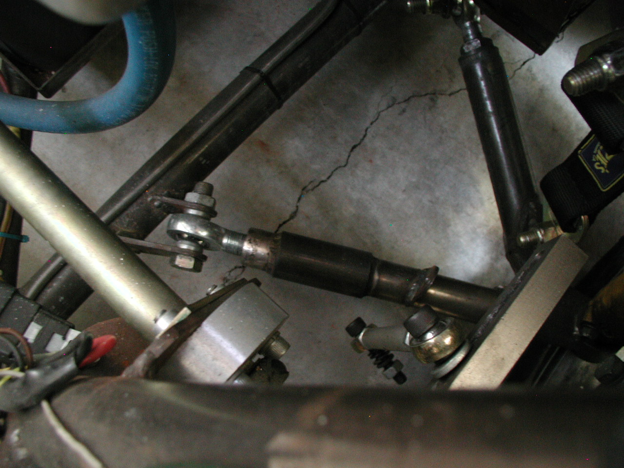

don't have to be an engineer to know you shouldn't thread the outside 3/4" RH and the inside 5/8" LH!!! I did the math back when it broke and IIRC there was literally only .030"-.050" thick sections with high stress concentrations from cut threads holding the whole lower arm together!
Just because you can use a machine makes you a machinist, not an engineer, nor for that matter prove any sort of common sense. I can't believe I didn't catch this when I adjusted the suspension the first time... I sorta recall thinking looks kinda spindly but again, "they do this kind of stuff all the time" in the same sentence they refer to this as a custom piece.
Look how thin!!!! Keep in mind, the rod end has 5/8" diam threads!!!!!! for comparison. I literally shit myself when I saw the failure and saw how thin.

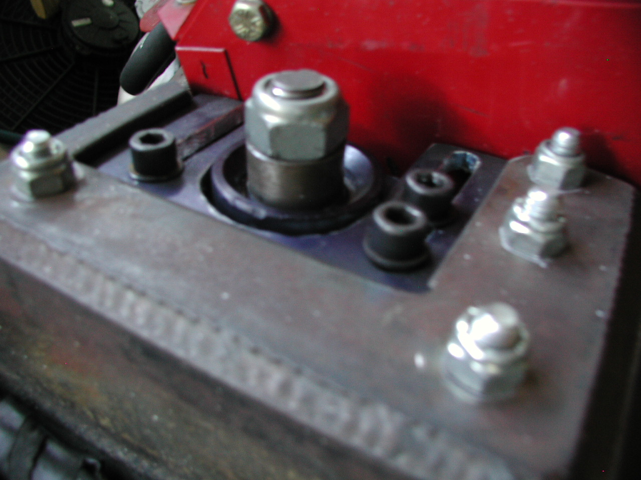

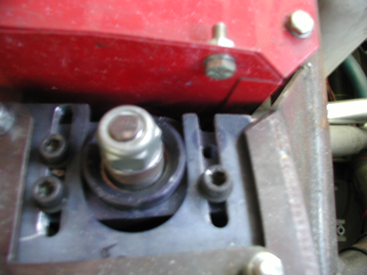

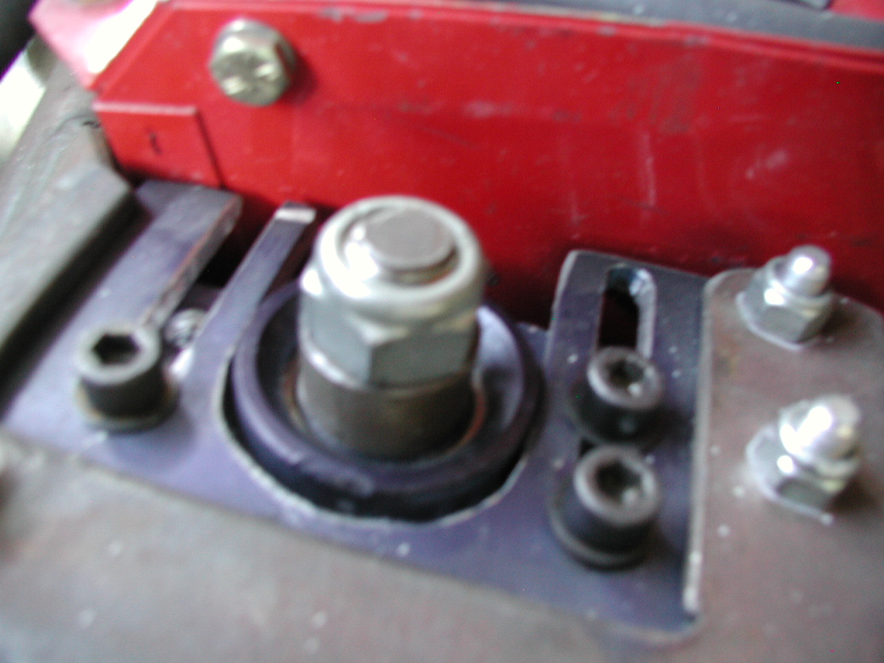

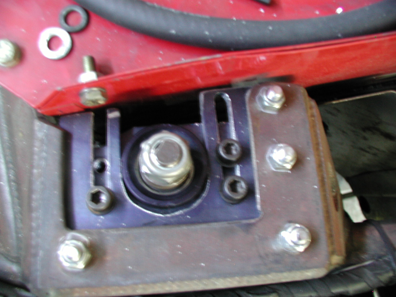

now for their shitty upper mounts - AJ and I finally gave up dicking with them, and basically made the best of a bad situation, hacked them to tuck near the cell to ensure I could get enough camber range, and I was left to rely almost completely on the lower arms for camber and completely for caster. Notice how one bolt is missing but also notice how boogered and hammered the threads are - that is where they forced the fourth bolt in before shipping to me (sorta grainy cuz my digital cam has a hard time focusing that close but you will get the point)

bit better at showing how the threads had dug in when they assembled it - you also can see the bare alum where we had been trying to grind clearance into the part so it would adjust but just wasn't gonna happen without complete remachine of the part - called you on this shit as well BTW. You were never around once you had my money and sent the parts.

notice how well the tolerances are held on thread placement - the fourth hole is clearly shifted over relative to the slot

the passenger side, again bolt doesn't line up. This one came unassembled in box with the bolts laying with it (IMG:style_emoticons/default/shades.gif) if one won't go together, leave it to me to assemble the other, right!

forgot, another shot of the bitchin' custom double adjusters

here is the arm after I cut it in half, ordered two 5/8" thru/3/4" thread HD heim joints at $45 each, lengthened the arm to match what it should be without the adjusting sleeve. Not an single issue since, so my "backyard" engineering seems to be working much fucking better than your "professhionaul" job jackass (I spelled that just for someone of your caliber)

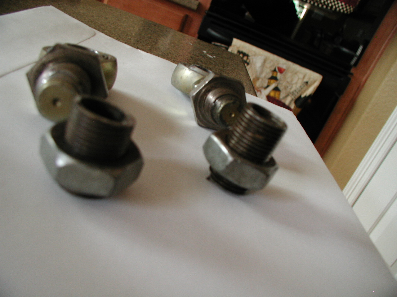

On the way back to work I realized I forgot to snap shots of your two ball joint "pins" that the lower arm attaches to. That was the real reason I bought your kit - I didn't have the time to draw up a pin and have machined locally as the lathe at the old hot rod shop I worked at in college couldn't hold tolerance below 0.005" and the cost of all that made your stuff seem like a slam dunk.
But I will get pics, two pins, identical parts, machined I am assuming back to back and even THOSE aren't identical and I could barely get the nut down on one side to lock the cotter key in place. I will be sure to post that excellent machine work here as well later.

I think that I don't quite understand the system. Why didn't they just use right and left hand threaded heim joints so that you could loosen the jam nuts and twist them to loosen or tighten?
Nevermind. I'm dumb; I looked it up and now can see what broke.
