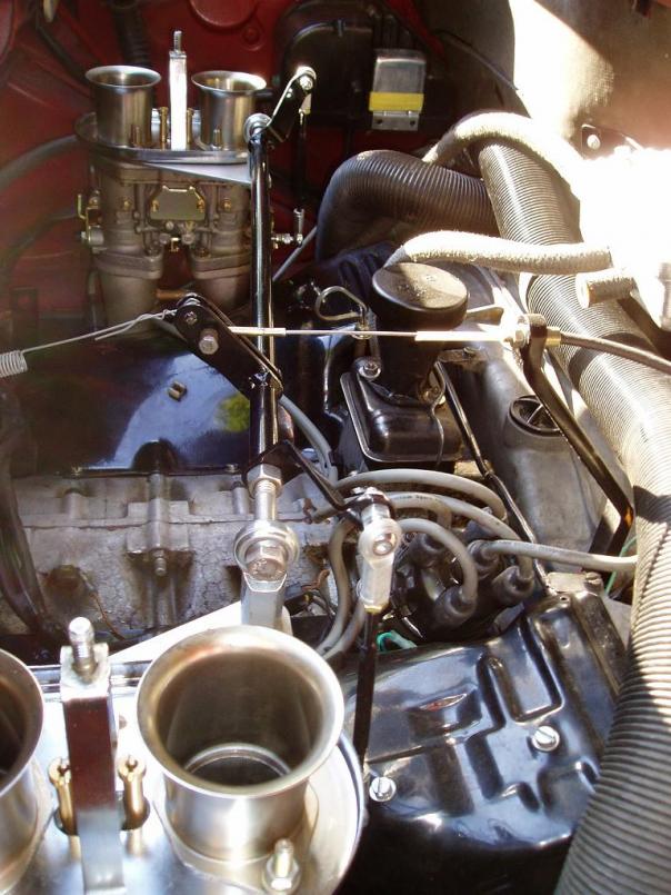

Zach and Jon,
Jon's picture may be the answer to your question about cable length. That may be a Triad cross-bar linkage and cable bracket, but I have a Weltmeister linkage and bracket that looks the same, except that mine is cad plated, not black. It works very well and I have used both stock and Terry cables. From what I have read, I think Triad took over the Welt system manufacture and sales.
I don't think your cable is too short, but that you need to fabricate a bracket that moves the cable mounting point up and near the linkage arm. I don't know if the CB-style hex-bar linkage came with a 914 T-4 cable bracket or not, but there has been a lot of questions about this in the past. The bracket on my Weltmeister syatem and on the Triad system is a piece of steel bar stock formed in an S-bend as shown. It has two holes drilled at the ends, one for the cable end, and one where it bolts to one of the unused bolt holes on the T-4 fan shroud flange. That may not sound secure, but it works very well. The square flat end of the bracket rests on the fan shroud, the bolt secures it to the flange, and it doesn't move appreciably, either fore and aft, or side to side.
Again, I think your problem is the cable bracket and not the cable itself.

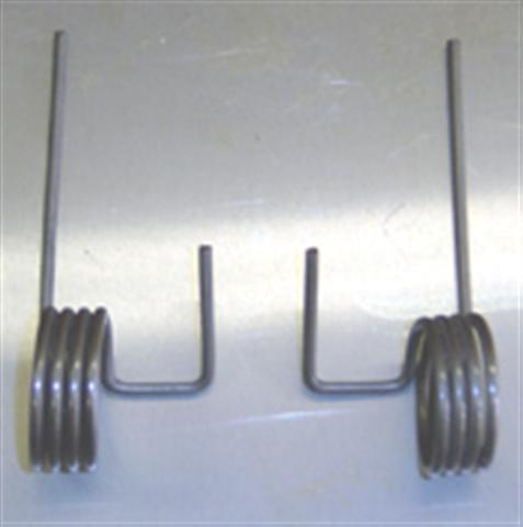

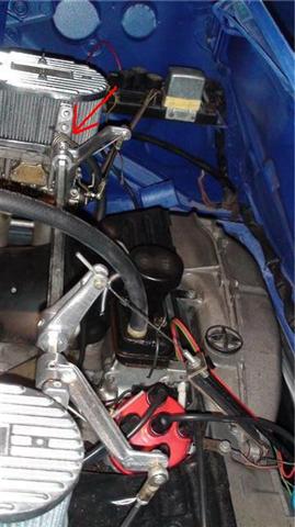

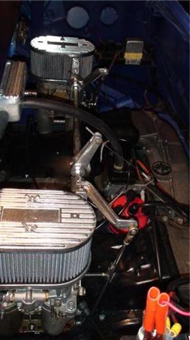

I am in the process of setting up new carb linkage and Bill Grimstead was kind enough to send me these pics as an example of what he has done. It helped me, hope it helps you too. Notice the throttle bracket he fab'd. Also, I was so impressed with the springs right on the hexbar (red arrow) for tension that I bought a pair.
Here is the link...
http://www.airkewld.com/parts/proddetail.php?prod=PL-5020
Linkage is CB Performance, BTW.
VaccaRabite
post Dec 29 2008, 04:53 PM
En Garde!
Posts: 13,929
Joined: 15-December 03
From: Dallastown, PA
Member No.: 1,435
Johnnie5, I like that throttle holder.
It is pretty much exactly what I was planning on making.
Could you give me measurements so I don't have to recreate the wheel?
Zach
Zach
That looks like it should work perfect Zach. (IMG:style_emoticons/default/beer.gif) I hope it will solve your problems and help you finish your car on time since I voted you would (IMG:style_emoticons/default/happy11.gif)

Zach,
Those pics are of Grimsteads car, I haven't even gotten that far yet. I spent the day taking apart my CV's, cleaning and repacking them (and adding 4 new boots). Those little c clips on the end of the axle's are a bitch to get off! (IMG:style_emoticons/default/headbang.gif)
Anyway, I don't have a measurement for the bracket. I was planning on just setting my cable in place, making sure the slack is out, then measuring back from the cable housing to the point where the bracket will fasten. Let me know if you come up with something before I do...
