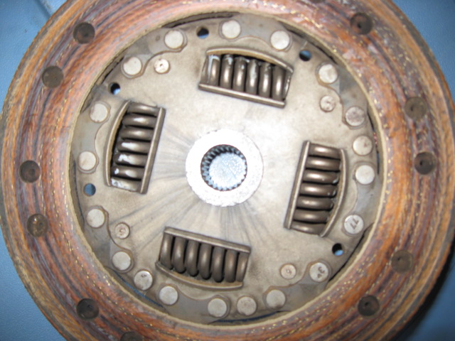

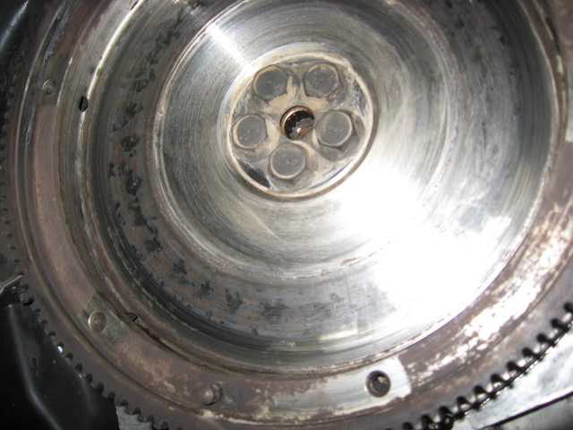

Jake, can you tell from this pic if the flywheel can be turned? I believe it only has 110K on the engine and I can't tell if it has ever been turned.
There is a deep groove on the outer circumference of the contact surface. It matches the light colored ring, about a 1/4" wide on the outer circumference of the disc.
Since there are no rivets out there, I can't figure what made the ring. Clearly the flywheel should have been turned before this disc was installed.

It looks low, but **may** have one more life in it... Have it measured.

Can you tell me the spec? Search here is unclear. Some say 11mm (disc surface to mounting surface) and others say 7-8mm. I know the plate mount surface and disc surface must be maintained at 22.5.

You will probably be ok as long as there is still a "step" left from the working surface toward the inner atachment.
