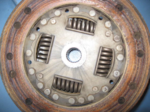

Pulled the trans for an oil seal replacement, and my clutch disc is down to the rivets on the pressure plate side. I thew in an old disc to keep me going (daily driver).

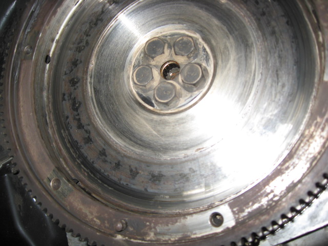

Jake, can you tell from this pic if the flywheel can be turned? I believe it only has 110K on the engine and I can't tell if it has ever been turned.
There is a deep groove on the outer circumference of the contact surface. It matches the light colored ring, about a 1/4" wide on the outer circumference of the disc.
Since there are no rivets out there, I can't figure what made the ring. Clearly the flywheel should have been turned before this disc was installed.

Jake Raby
Jul 8 2009, 08:14 PM
It looks low, but **may** have one more life in it... Have it measured.

Jul 8 2009, 10:58 PM
Can you tell me the spec? Search here is unclear. Some say 11mm (disc surface to mounting surface) and others say 7-8mm. I know the plate mount surface and disc surface must be maintained at 22.5.
JFJ914
Jul 9 2009, 09:31 AM
You will probably be ok as long as there is still a "step" left from the working surface toward the inner atachment.
