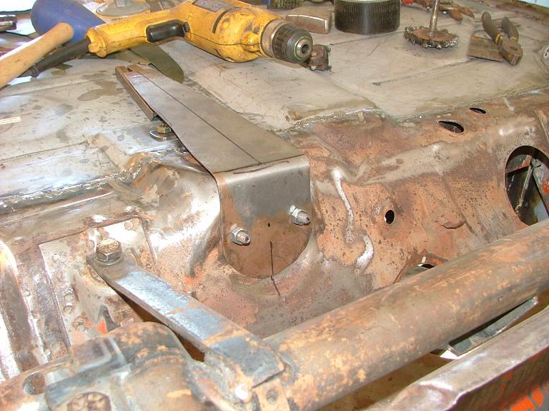

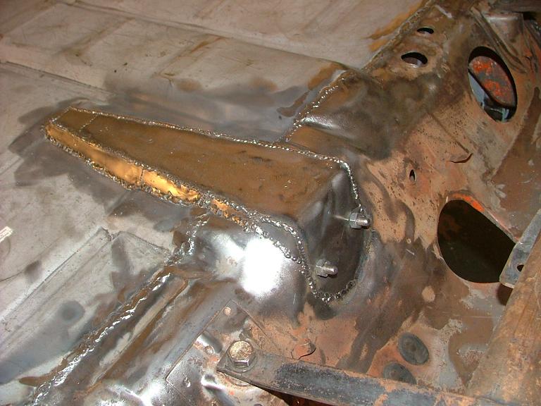

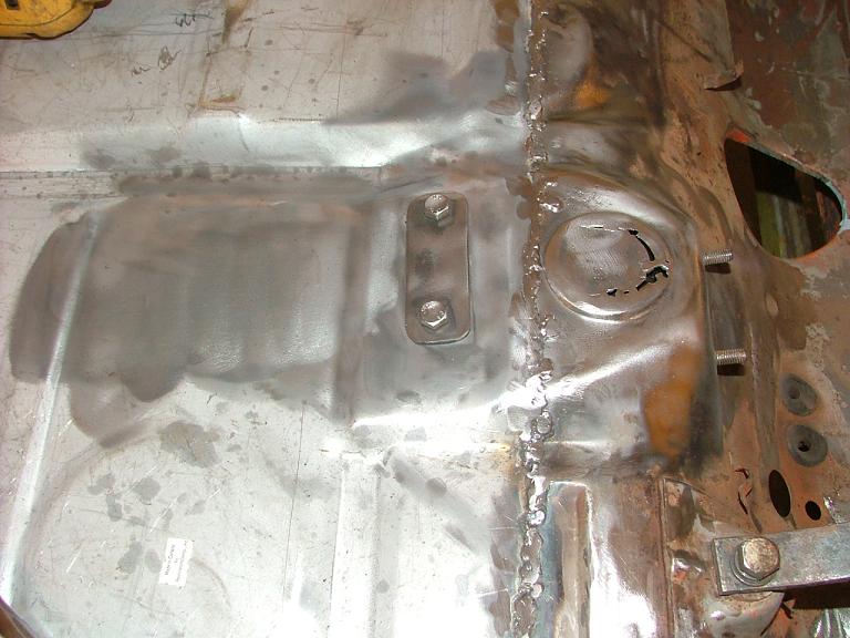

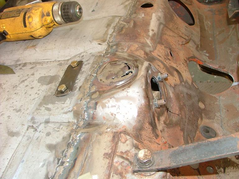

Innovation or Abomination?
I can't decide. (IMG:style_emoticons/default/idea.gif)
The pedal support structure on the car was nothing but rust and memories.
No one seems to have one on a parts car that is not totally shot that I could
find.
Mark posted a cool video a while back showing just how much the floor flexs
when you step on the brakes. Scary!
I decided to try to stiffen up the area from the pedal box back to one of the ribs
stamped in the floor. This is not stock, obviously, and kind of ugly, but it should
be stiffer than the stock arrangement. I can always grind it off later before I
take the car to Pebble Beach. (IMG:style_emoticons/default/av-943.gif)
Mounting the pedal box. The bar and bolts got welded down later on.
Clean it all up for welding.
Fitting some half inch tubes and eighth inch plate under a 16 gauge piece.
Welded it all up.
I am thinking the "corner" formed by the part of the box next to the brake
cylinder will add a lot of stiffness. There is an eigth inch plate running the
length of the box that is plug welded under the top. The box is not the lowest
point on the front of the car so it does not reduce ground clearance.
What do you all think?
John

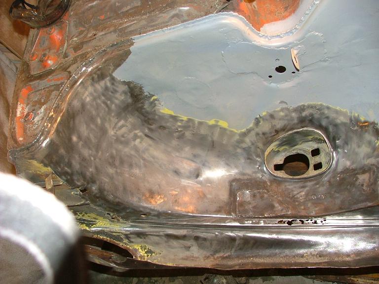

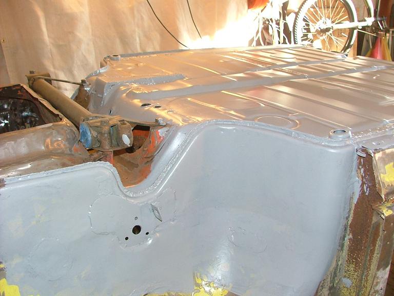

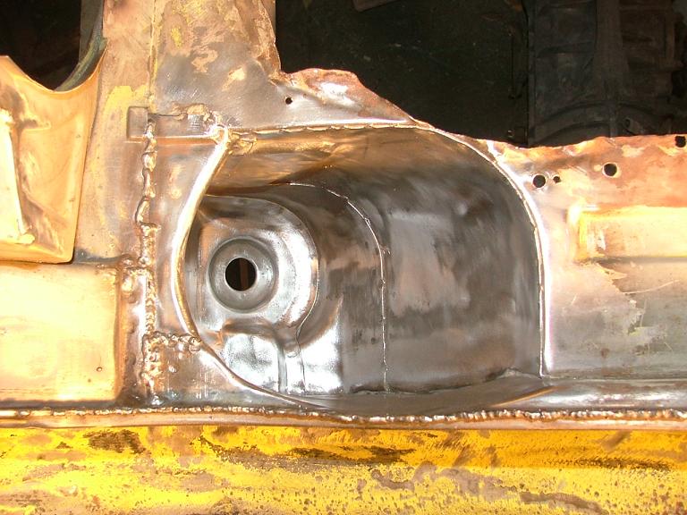

Finally finished welding the floors. I took JPs advice and seam welded the
whole seam down the longs from the front of the car until past the transmission
dog bone intersection. Firsr ground it even and then welded it 2 inches at a
time. I welded only six or so sections a foot apart each day.
There is a lot of crap in those seams because the first weld session popped like
crazy. It was constant fireworks. Next day I welded the same sections again
and then I could get a good weld. Like I had to cook all the crap out of the seam
the first pass. Then I lightly ground the top and both sides. After that I filled in
any areas that had gaps, holes, or looked weak. Very time consuming.
Welded on the floor pan triangles and jacking points. Cleaned it all, etched
it, and epoxy primered it today, the first new paint on the car. (IMG:style_emoticons/default/piratenanner.gif)
Made 16 gauge reinforcing plate for the anti-roll bar mount. The sheet metal on both
sides was torn in this area.
Everything will get seam sealed and primed again.
John

My buddy Sean has been helping me now and then to clean up the car. I am
helping him restore his 914 in exchange. His car needs floor pans, hell hole,
and paint.
I'll seam weld or skip weld all the tower seams.
Trying to clean up the whole underside so we can reflip this sucker and get
on with it.
John

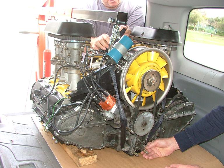

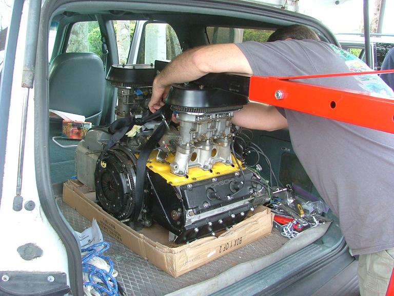

Picked up my engine from Blake and his father Al. It is a 2.5 /6 they got in an old
911 they bought a while back. It was marked as a T engine but made way more
power than it should have. Blake tore it down and saw it was built as a race
or hot rod engine. They rebuilt it with nickies because several barrels were
shot.
Here we are picking it out of Al's car.
Stuffing it into my rusty old truck.
My wife showing the proper respect for our new engine.
Can't wait to have it in the car.
John

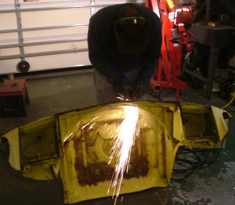

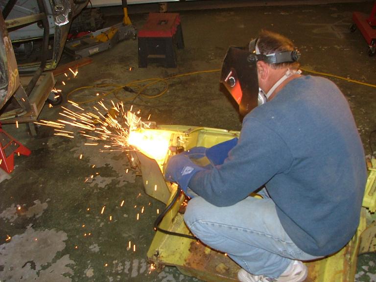

Sean having fun with the plasma cutter.
Cutting out a replacement front valence from a piece sent to me by Thomas.
Saving both head light buckets to use on the IMSA car.
I'll weld it on once we have the car flipped back upright.
John
