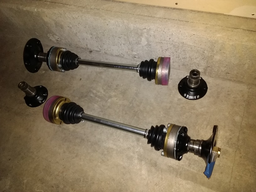

I thought I'd follow up on my own question for any future readers. I had some new CV bolts from PMB. With the flange and gasket in place the length was fine using the newer/thinner CV's. Not sure if the bolts would have been long enough for the older/fatter CV's.
Also, I got confirmation from a local Porsche shop that the float compensates for the difference in the CV's and that it shouldn't be an issue.
here's some gratuitous axle porn...
