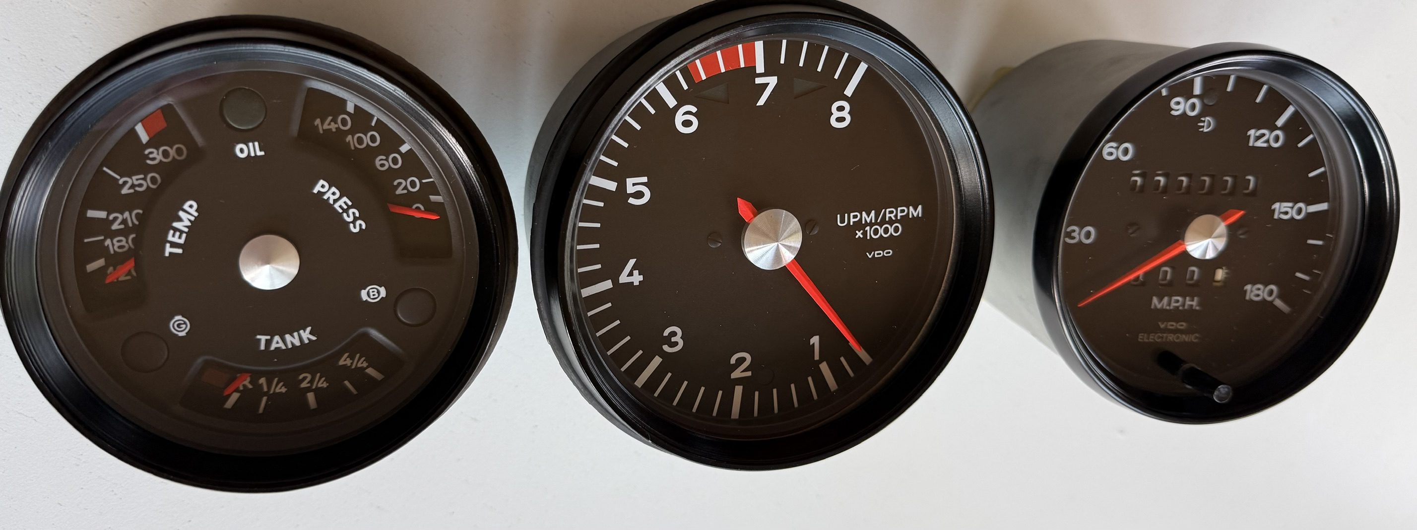

Nana's_914
post Aug 27 2026, 06:16 PM
Post #105
Posts: 123
Joined: 27-October 06
From: San Diego, CA
Member No.: 7,100
Got a triple gauge and rebuilt tach from John Bell today. They look very nice next to my speedo.

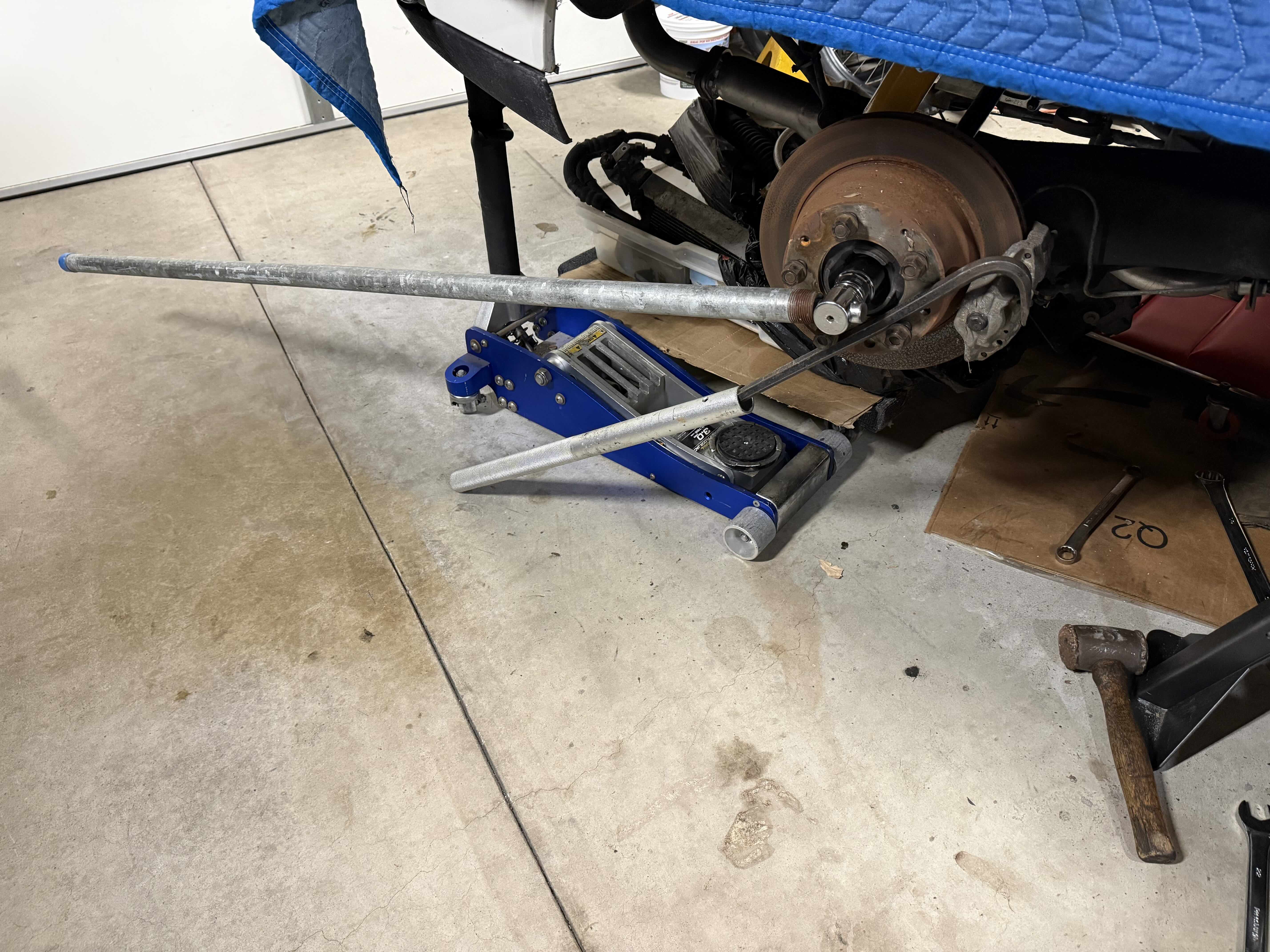

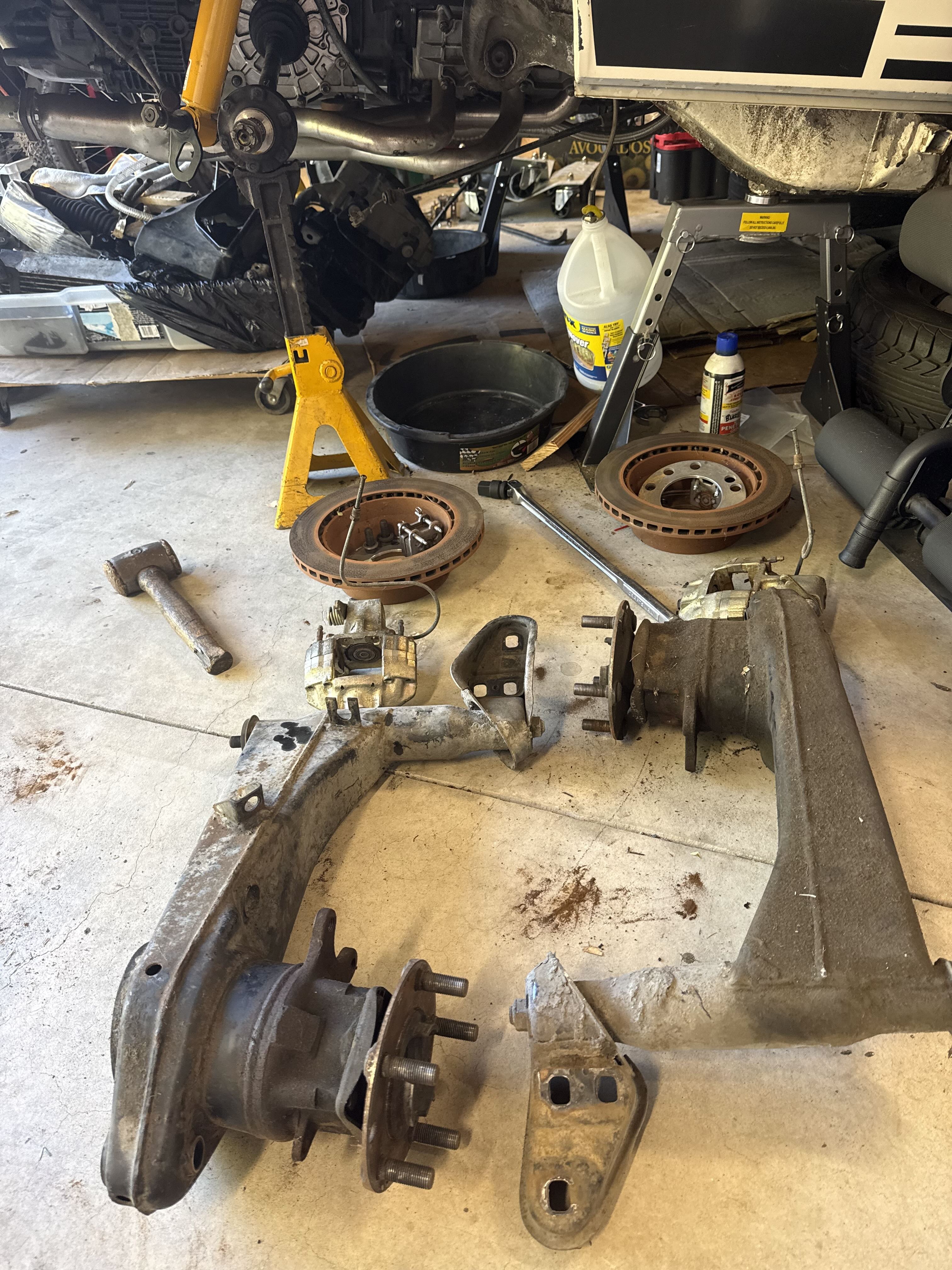

Nana's_914
post Oct 3 2026, 11:35 AM
Post #106
Posts: 123
From: San Diego, CA
Member No.: 7,100
Finally able to use my arm again. Breaker bars are my friend right now.
Refreshing the suspension and brake system. Got the back disassembled.
